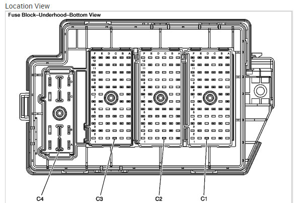

Blew cigarette lighter fuse, replaced and now car won't start. Only half of the fuses in both fuse boxes have power.

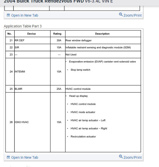

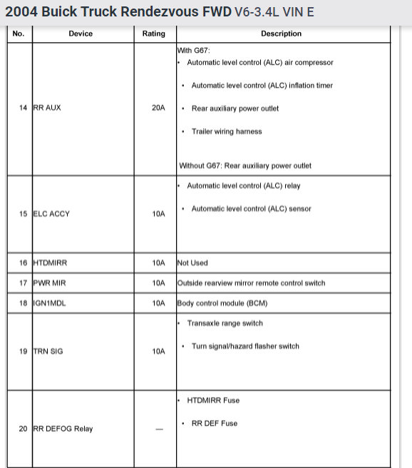

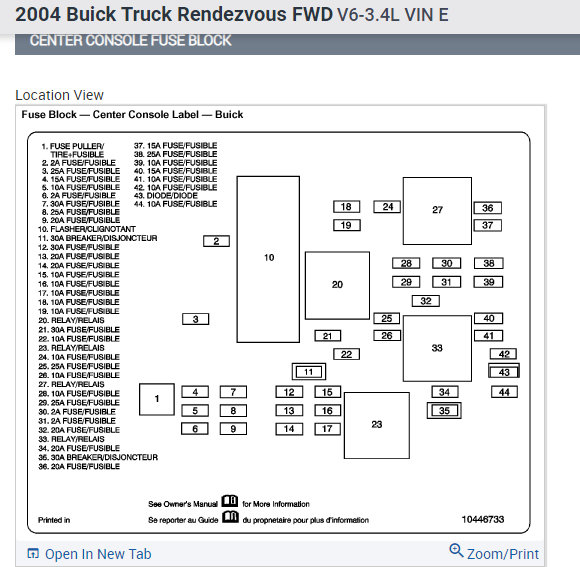

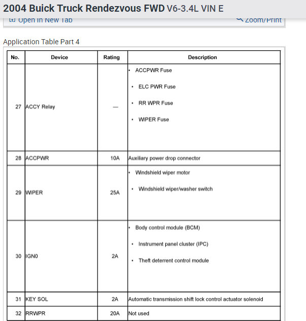

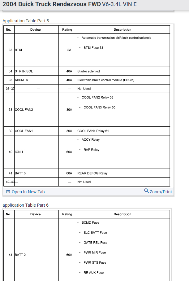

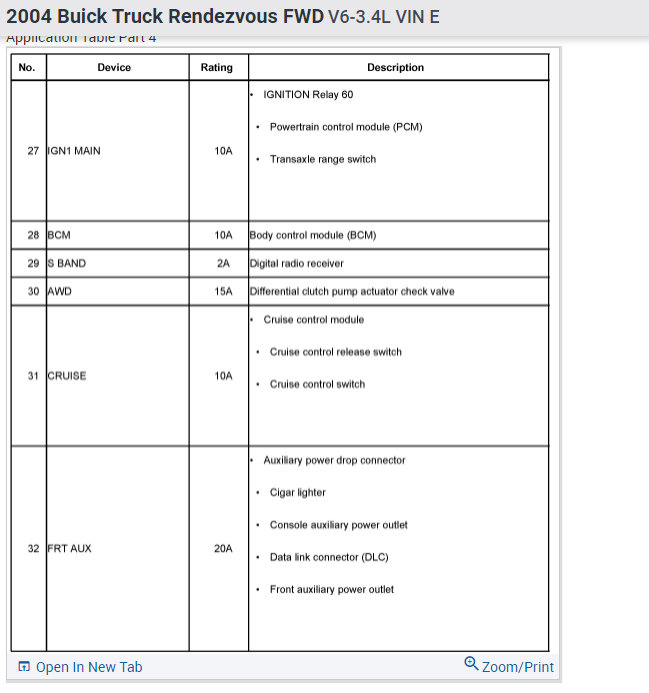

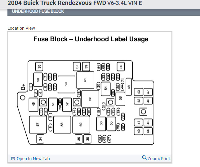

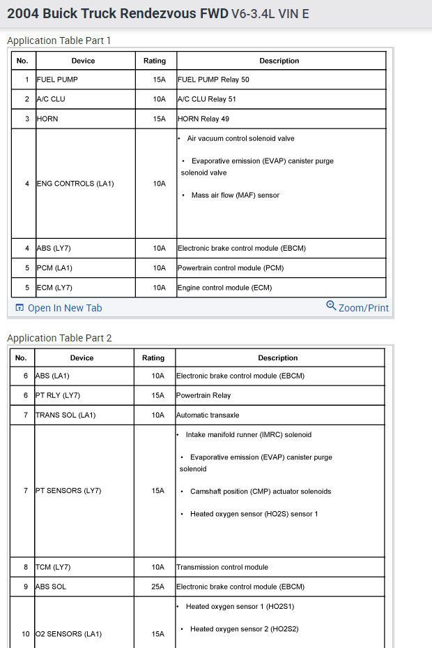

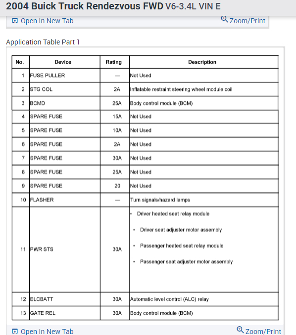

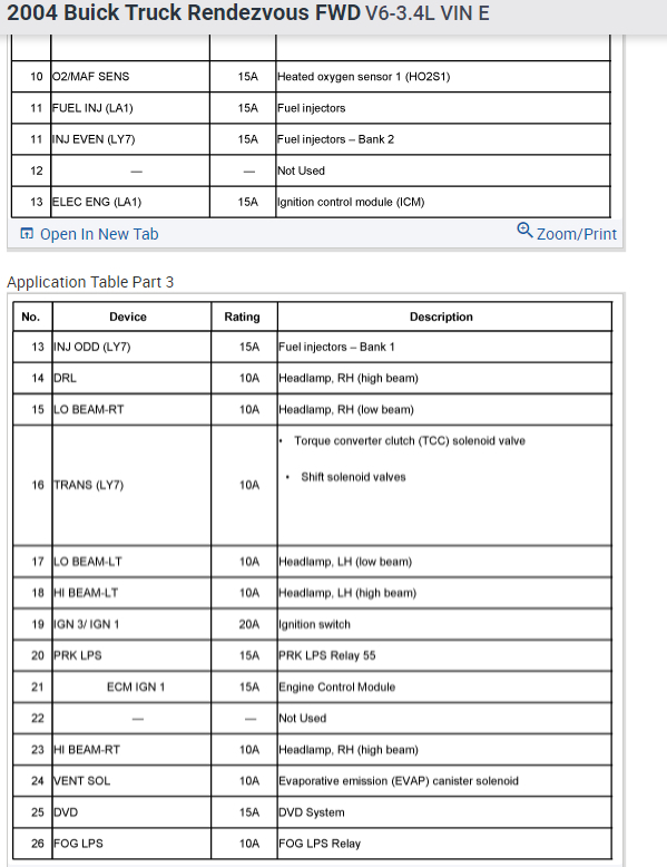

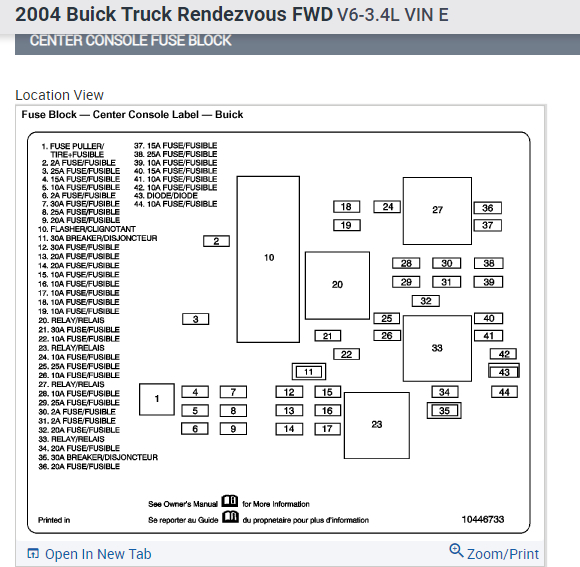

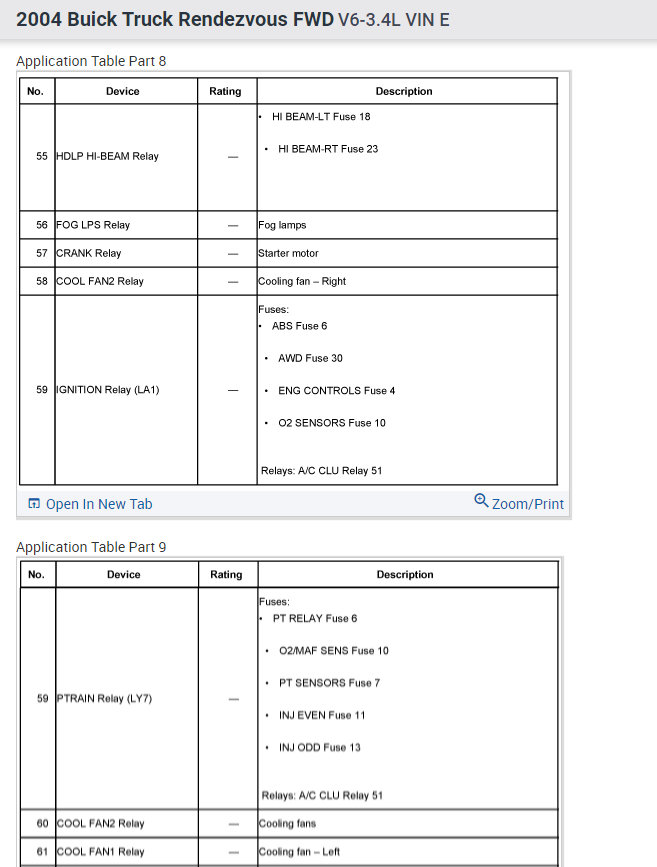

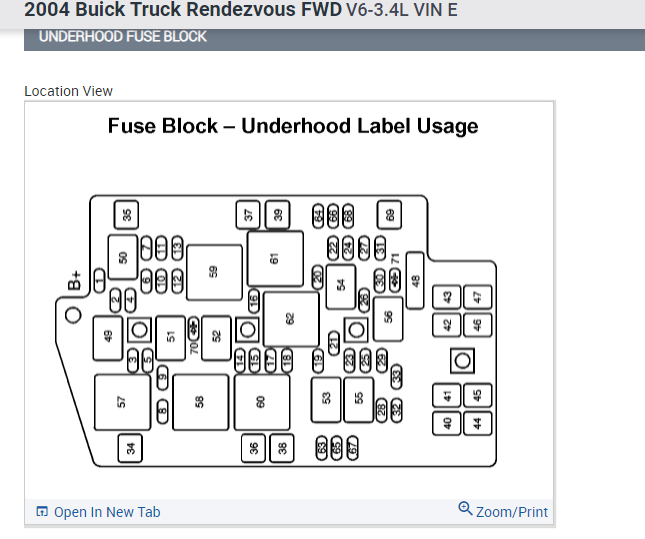

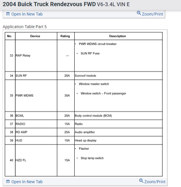

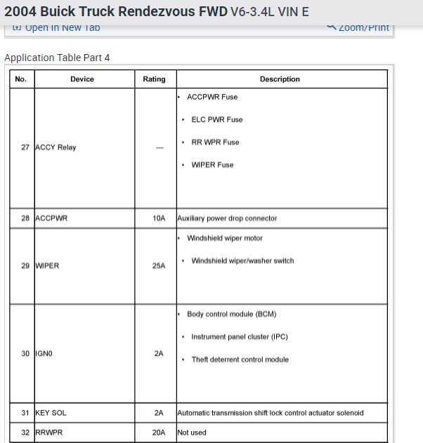

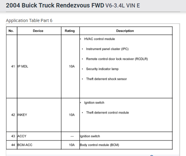

I am assuming you did not have this no start issue before the fuse replacement, right?
When you turn the key what does the vehicle do? Does it crank over and not start? or do you just get clicks?

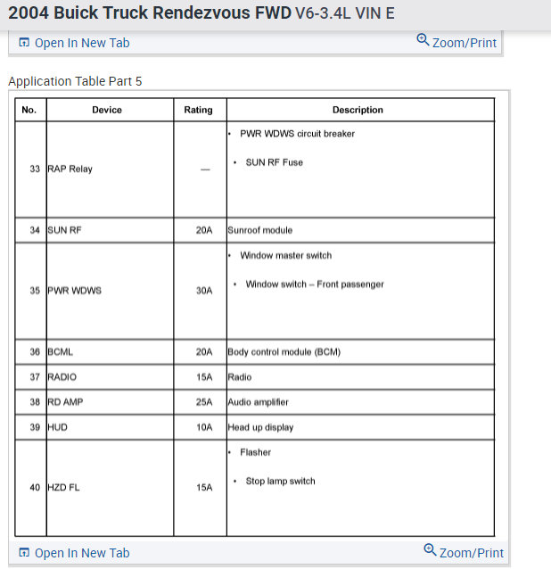

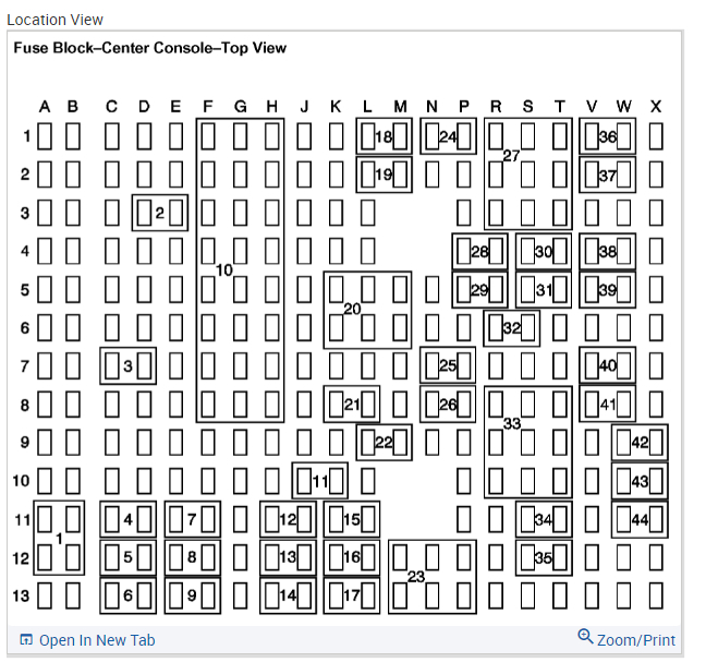

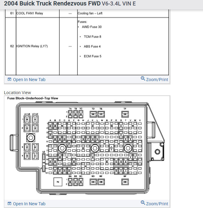

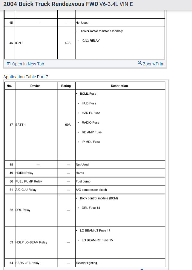

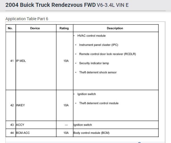

The trick would be to figure out which fuses are not getting power and or what components are not functional.
This could have blown fuses for the ignition switch. Or other components.
I have attached the complete fuse chart for your reference.
Please let me know little more information.

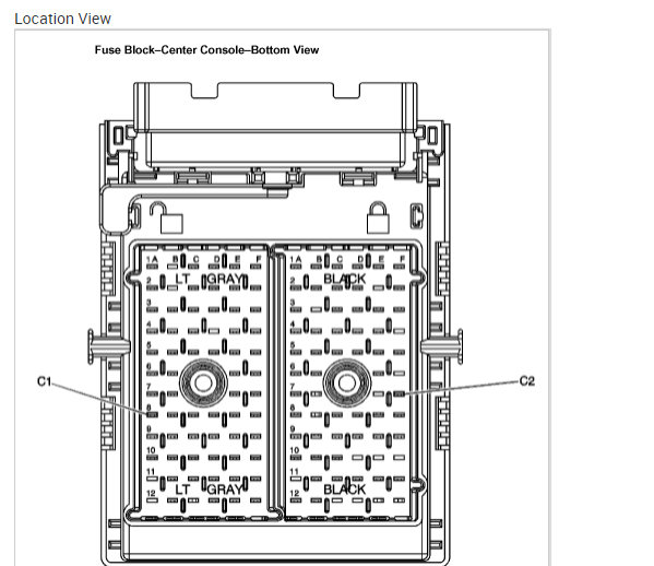

Just wanted to say thanks for the help. The schematics you sent with wire diagrams helped. It was a loose wire in the wire harness connector.
