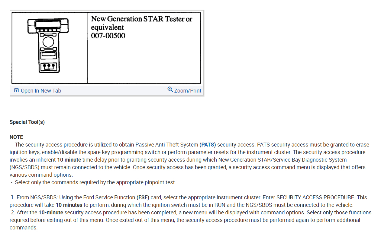

I disconnected the battery for about an hour and reconnect and the security light is flashing and won't start.

Good morning,
I attached a guide for you to view for security reset. Try this and see if it works.
https://www.2carpros.com/articles/how-to-reset-a-security-system
If it does not, you will need a locksmith to come to you and reset the system. They need to use the Ford IDS software to reset the security.
