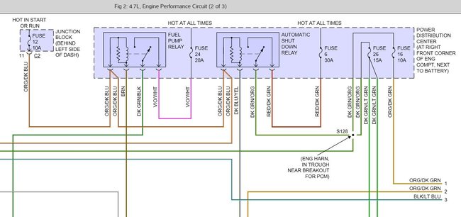

Driving a couple of days ago, shut down. Would not restart. Replaced fuel pump, seemed logical based on past experience, still will not start.

Does the fuel pump even run for a few seconds after you first turn the key to run?
If not, check the fuel pump fuse and if okay, try a new fuel pump relay or swap one it.

Fuel pump relay does not click. PCM fuse oayk. PCM relay seems to be clicking as well. Are we looking at crankshaft position sensor, or camshaft position sensor next? My wife did experience a similar situation a week ago, but was able to restart. Or, are we up to a bad computer already?

That would be a no for both the crankshaft position sensor and the camshaft position sensor.
The fuel pump should run for two seconds when you first turn the key to run, before having to crank the engine over. Them sensors have nothing to do with it, because the engine is not cranking over.
The fuel pump relay is fed from a fuse #12 behind left side of dash, with the key on run/start as well as a fuse #24 in the PDC under the hood, that is hot all the time.
Although since the relay does not click I am concerned with that fuse #12 left side of dash.
Can I assume the pcm relay you are referring to is the asd relay? If so, then that fuse must have power going through it cause I was just going to ask you to test both sides of that fuse on both sides with the key on run.
That fuel pump relay is grounded by the PCM. A brown wire at pin #19. You could use a twelve volt test light and ground that brown wire, turn the key to run and listen if the fuel pump runs now for two seconds. If so, the problem is with the PCM, its powers/grounds. The are usually more than just one power and ground for the PCM, so check them all.
Also, just because that ASD relay clicks does not mean it is supplying power to the coils, injectors, and the PCM when the key is on run/start. If not, check them ASD relay fuses, the #6 in the PDC and the fuses after that ASD relay, #16 and #26 also in that PDC.

Yes, pin #19 on the PCM connector, look for a brown wire.
That probably just means the problem isn't with the relay itself. Ground that brown wire and see now if the relay works.

Yes, right side of firewall.
If you can access that brown wire leaving the fuel pump relay at the PDC, you could ground it there is that is easier.

Checked voltage with key on. #6 = no power, and #24 = no power. All others mentioned had twelve volts. Also, correction, the check engine light does go out after a couple seconds. Move on to grounding brown wire still?
