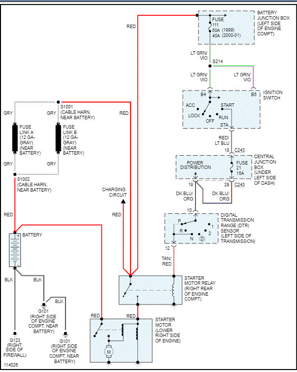

New starter, new solenoid battery good fuses good. Still won't start.

I would be happy to help, but I need more information. First, does the starter engage and turn the engine? Second, is this a 5.4L V8 or the 4.6L V8?
If the starter isn't engaging, did you check the starter relay? Have you checked to see if there is power to the starter? I ask because there is a fusible link between the battery and starter relay that may have failed.
Take a look through this link and let me know if anything helps. It deals with the starter motor not working. If that isn't what is happening, let me know.
Also, I attached a pic of the wiring schematic for you to see.

Put in new starter and starter solenoid, checked fuses, battery is good. Sounds like it wants to start. Tried to start in neutral didn't start. My dashboard goes on but gas not working, also put a new selector wire in too.I have a full tank of gas dashboard not registering it.

Does the engine crank when you turn the key to start?
Do you have a voltmeter to test the battery voltage?

I put a new starter in a new solenoid in checked fuses battery is good. My truck still won't start. Sounds like it wants to start. Don't want to put in shop don't really have the cash to do so.
