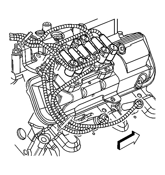

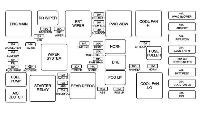

I put STP gas treatment in my tank and now it just turns over but will not start and all the lights still come on. What could be the problem?

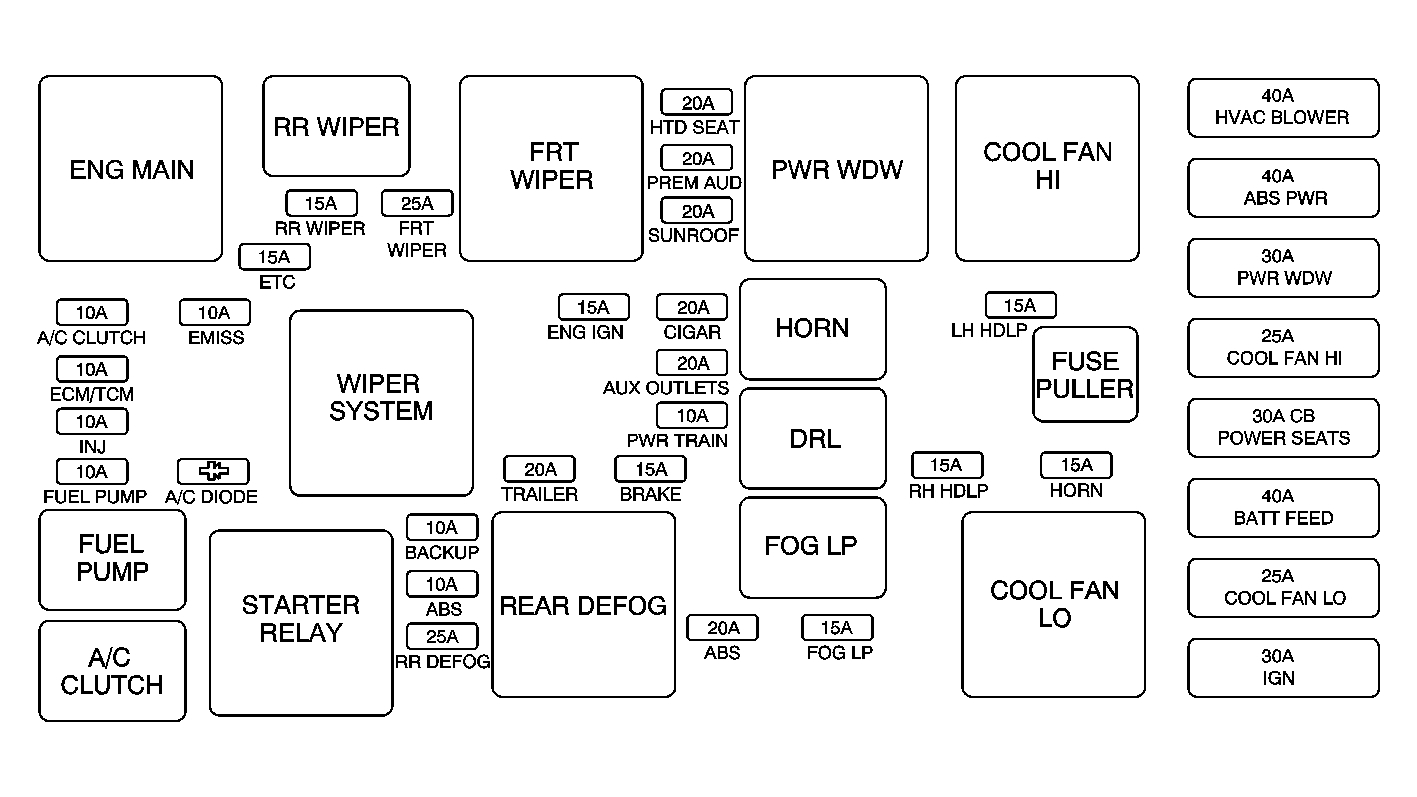

If you still do not hear the pump come on, then you need to check the fuses. There is a fuse box diagram attached below. The fuse box to look at is the one that is under the hood, along the left side. In particular, look at the fuses for "fuel pump", "ECM/TCM," "power train," and "engine ignition."
If the pump is coming on, the next easy thing to check is for sparks. You can do this with a tester that is available at AutoZone or any other auto parts store. Here is a link for one on Amazon: https://www.amazon.com/Lisle-20610-Inline-Spark-Tester/dp/B0002STSC6/ref=sr_1_3?ie=UTF8&qid=1501325755&sr=8-3&keywords=spark+tester
Basically, you pull the plug wire off of the ignition coil (also pictured below) and plug in this tester between the coil and the plug wire. Then get someone to turn the key while you observe it. If it flashes, then you have spark. Check all six cylinders.
Let us know and we will go from there.
