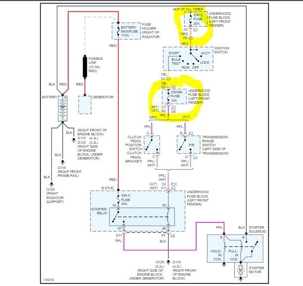

Engine wont crank, and can't take out of park to move.

SHAWN SZALEWSKI
Yes, the starter won't crank, all fuses are good, no broken wires that I can find. Don't have any power coming to the starter on the ignition wire.

Got it.
I attached a wire diagram for you to view.
Do you have a test light or voltmeter to do some checks?

HARRY P
  • 2,296 POSTS
Just a thought here; but have you had the key checked? If this is a pass-lock or pass-key setup, a faulty key could easily be the problem as far as cranking over. As for the shifter not coming out of park, I'd check the brake light switch circuit.
