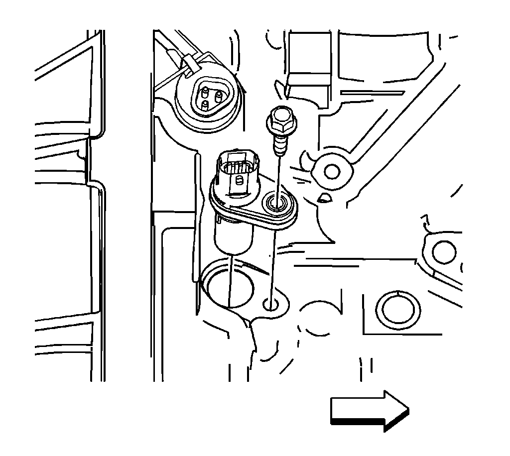

CRANKSHAFT POSITION (CKP) SENSOR REPLACEMENT

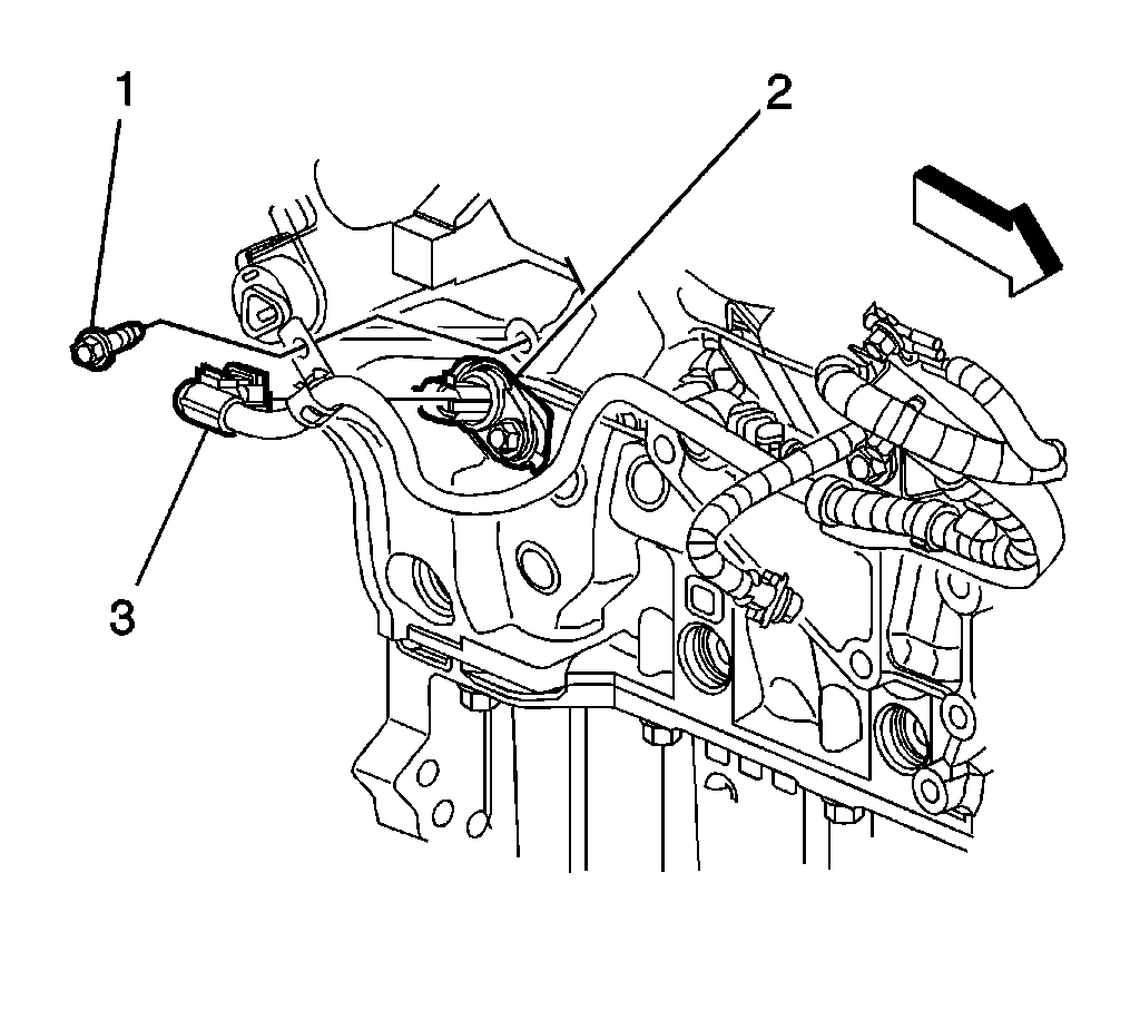

REMOVAL PROCEDURE
- Turn the ignition OFF.
- Raise and support the vehicle. Refer to Vehicle Lifting.
- Reposition the wiring harness heat shield to obtain access.
- Disconnect the crankshaft position (CKP) electrical connector (3).
- Remove the crankshaft sensor bolt.
- Remove the crankshaft sensor.
_________________________________

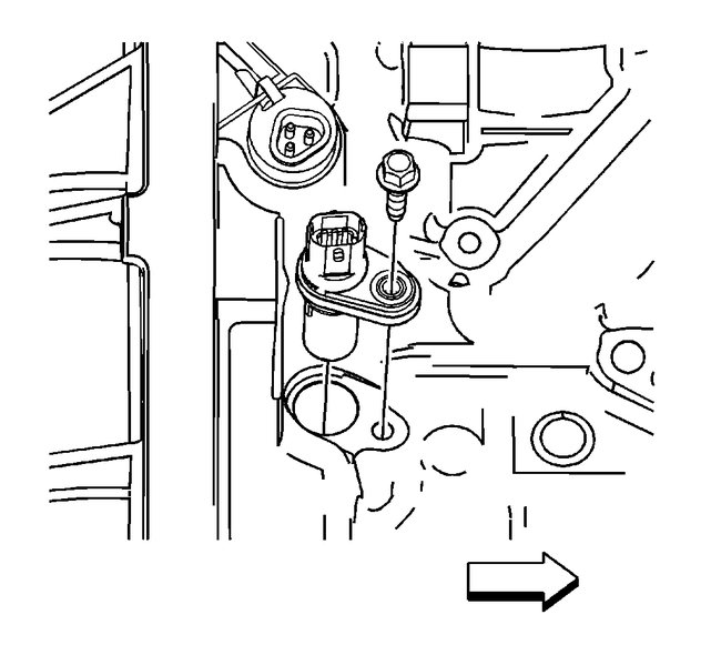

INSTALLATION PROCEDURE
- Install the crankshaft position sensor.
- Install the crankshaft position sensor bolt.
NOTE Refer to Fastener Notice in Service Precautions.
Tighten the crankshaft position sensor bolt to 10 N.m (89 lb in).
- Connect the CKP electrical connector (3).
- Install the wiring harness heat shield to the oil level indicator tube.
- Lower the vehicle.
The attached pictures correlate with the aforementioned directions.
