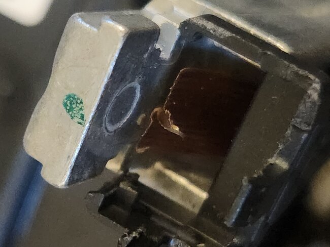

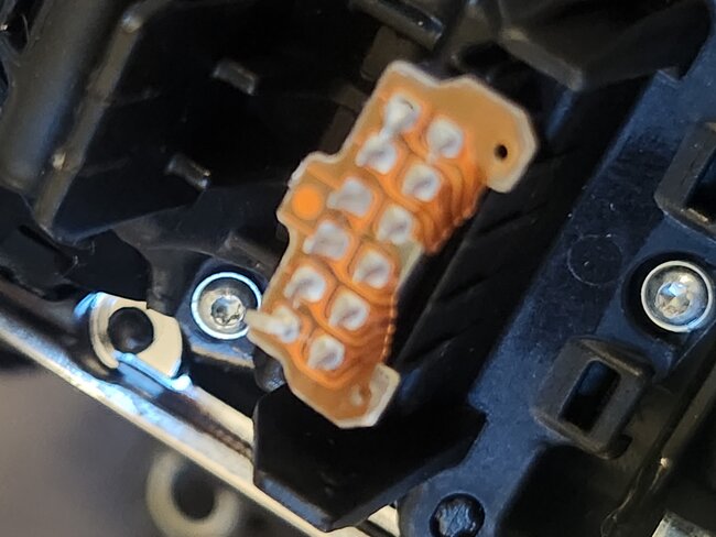

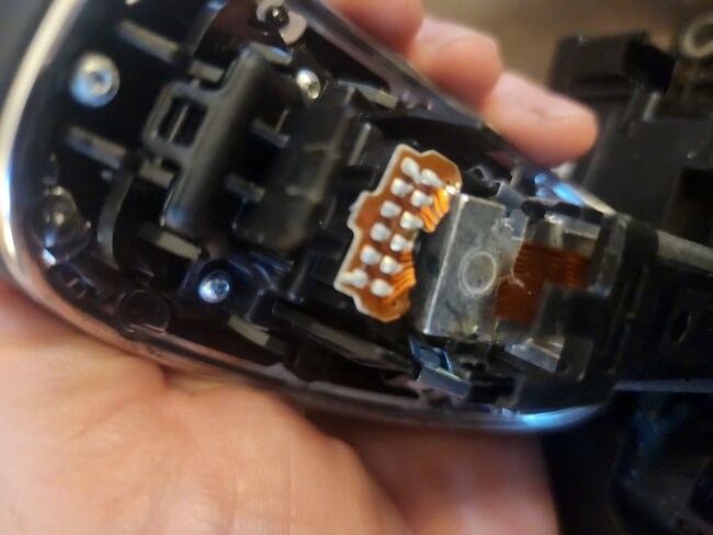

Well, there was no connector inside the driver's kick panel, but the photos will show a definite problem. There's no continuity in the electrical connection to the shifter knob. I'm not sure if this tore when I pulled the knob off or before. Either way it didn't work before. The problem is the cover plate can't go over the shifter with the knob on. Videos show removal of the knob without damaging this ribbon. Any ideas?
Sunday, June 9th, 2024 AT 6:26 PM
  • 110,194 POSTS
Wow, that doesn't look good. I don't feel that it is repairable and will need to be replaced. Have you tried finding one yet?

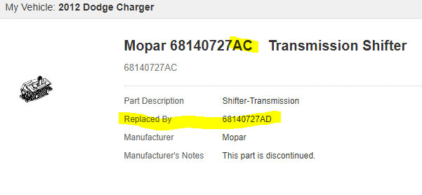

Yes, but there seems to be 2 part numbers. The only difference is the last letter. One ends in AC and I believe the other ends in AD # 68140727AC is the number of the one in the car. Is there a difference in the two parts? Also, which wire supplies power to this shifter?
Tuesday, June 11th, 2024 AT 6:57 AM

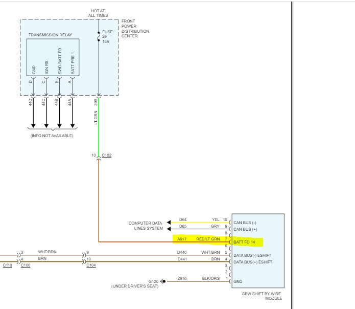

  • 110,194 POSTS
I attached a pic below of the wiring to the shift module. I highlighted the only fused power supply. Other connectors are part of the CAN.
The part numbers are for the same part. The one ending with AD is the replacement part number. See pic 2 below.
Let me know if that helps.
