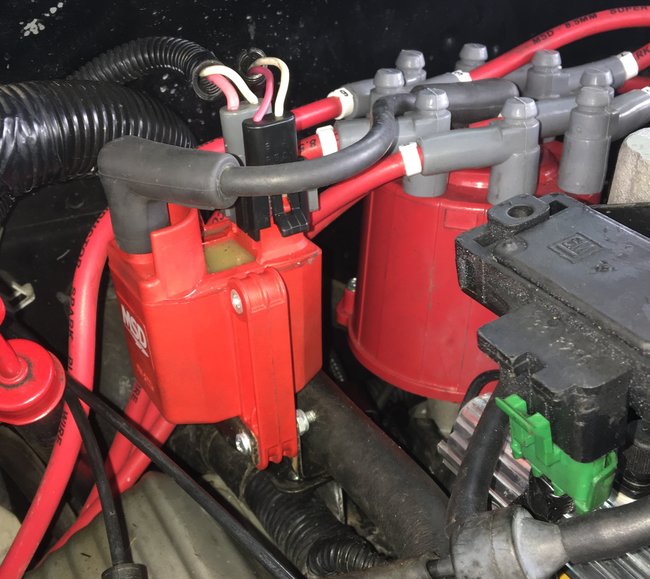

Thank you, I wish everyone could upload a video as you have it sure helps. I would remove the valve covers and using a flashlight inspect all of the valve springs I think one is broken not closing the valve at higher RPM. Also I would replace the ignition coil and make sure the ground strap is int he distributor cap. Please take a picture once the coil is out so I can make sure the ground strap is in place.

What ground are you talking about I replaced the coil pack with a msd one and when I took the old one off there wasn't any ground strap on it

There is a small ground strap that goes inside of the cap and over to the coil. Can you take a picture and upload it with the coil out? I will let you know if it is in there if not for sure is your problem

I do not see no ground strap
Sunday, July 30th, 2017 AT 12:22 AM
T-SMITH
  • 18 POSTS
Here it is
Sunday, July 30th, 2017 AT 12:25 AM
T-SMITH
  • 18 POSTS
I've checked the driver side valve springs they look good I will check the other ones tomorrow

Okay not the ignition system I was thinking of. Disadvantage of not being there. It could be the coil itself do you have the stock one? Also check the cap and rotor look for burn marks under the rotor. The ignition might be saturating.
