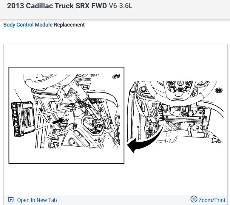

I drove it all day and then stopped at the grocery store and when I got back in the car, it would not start, but the dash lights came on. Kept getting the message "no key detected" and all dash lights were on, the battery light, ABS, park light and all was on. The key fobs would not do anything, not even lock or unlock the doors. I left it sitting overnight in the parking lot and when I went back the next morning, the car cranked up and went in gear. I drove it home and now it's sitting in my yard. I had replaced the battery and alternator, and car worked perfectly for a week before having all this trouble. Please help.

This sounds like the BCM is going out, but to be sure let's run a CAN scan which will have codes relating to the problem. You can get a CAN scanner (Controller Area Network) which will work on most cars from Amazon.
https://youtu.be/u-4syLc-ifQ
If you do get codes for the BCM here is the location, I would unplug it and then plug it to check the electrical connectors for corrosion. If that looks okay, you can get a preprogrammed unit by searching Google or Ebay. Here is the location of the BCM. Check out the images (below). Please let us know what happens.

I cranked it this morning with the key fob and within 2 mins, it cut off by itself (may not have been 2 minutes, probably less). I tried to crank it again with the key fob and it didn't crank. I got inside and cranked it like I should have, and it cranked, but again, it wouldn't go in gear. I cut it off and waited a couple of seconds and cranked it again, this time all the light in the dash came on but when I put the car in drive and tried to move the car, all the dash lights went off.
