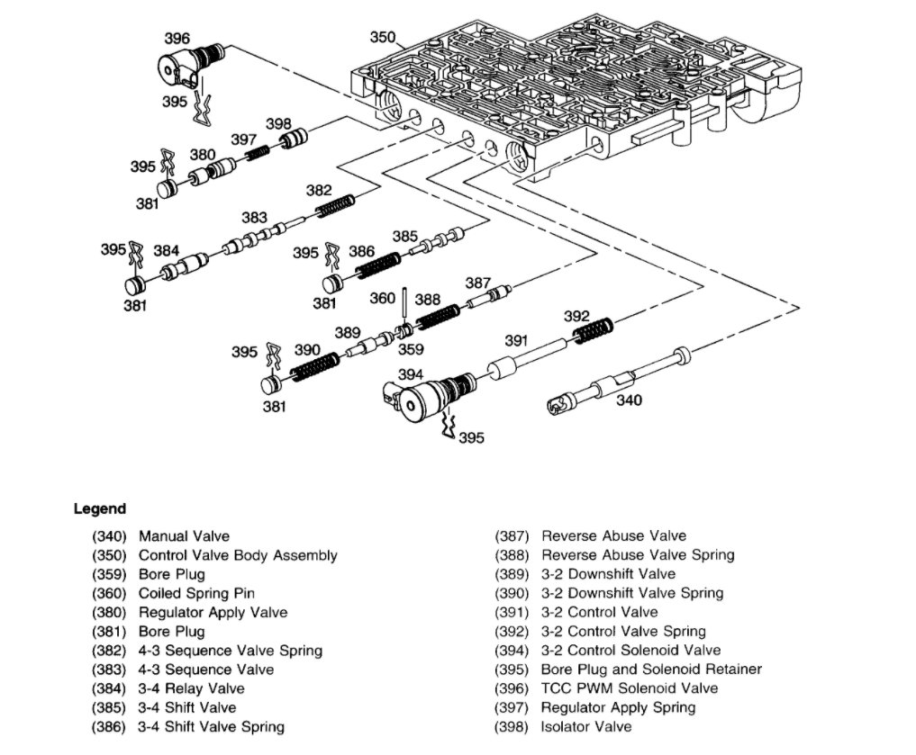

back in spring my vehicle would not back up and i took it to a mechanic local here and he said he could fix it. it cost me $750.00 and it worked okay when i got it back. in 60 days it did the same thing that it did before, i took it back again and he fixed it again. now a few months later, it is doing it again. i put it in reverse and it just sits there. and i had to get someone to push it backwards. it goes into drive and drives forward except now it only shifts two times and that is it. and it slips a little bit. when it first did it this time i put my car in reverse and it jerked backwards but it backed up then put it in drive and took off and it slipped for about 50 feet and then smoothed out. but now no backing up at all. Help

It sounds like the reverse valve spring in the valve body has gone bad but to be sure lets run the codes. Can I ask what they fixed?

Okay. Sorry to hear that. I suspect your issue is in the valve body which normally gets reused when rebuilding the unit. So I would start with that but if you are able to get codes out of it we should be able to figure something else out but looks like you are going to have to find another shop either way.
