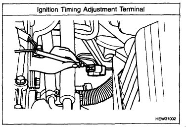

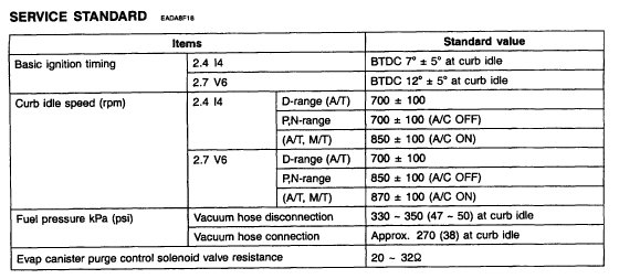

I realize the ignition timing is controlled by the PCM, but here are the specs for where it should be. (see attached picture 1)

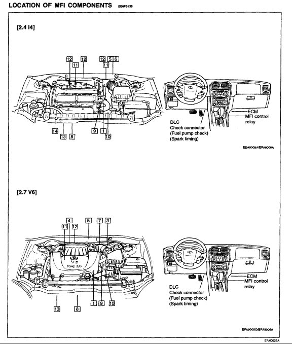

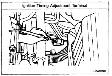

In addition, there is a ignition adjustment cable you should check if timing is an issue. Make sure it is getting power, is clean and tight, and no damage to the wiring. See attached pictures for location. I have also attached pictures of many of the sensors located under the hood because if the converter and timing check good, I want you to get a live scanner and check the coolant temperature sensor. (CTS). It tells the PCM the engine's temperature and from that, the computer adjusts air and fuel mixture. If it is too rich or lean due to an inaccurate reading, it will cause drive-ability problems.
