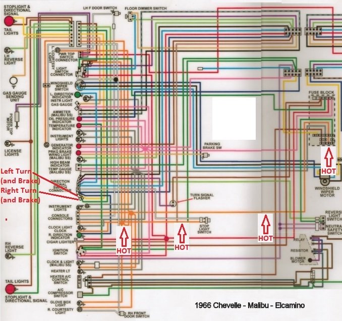

Plug that plugs into brakelight switch has a constant power to the switch and will not shut off.

When switched, the brake light switch sends power over to the turn signal switch.
Gets its power from the fuse box (constant).
See wiring diagram that I doctored up below.
Return with news!
