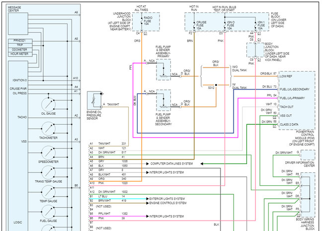

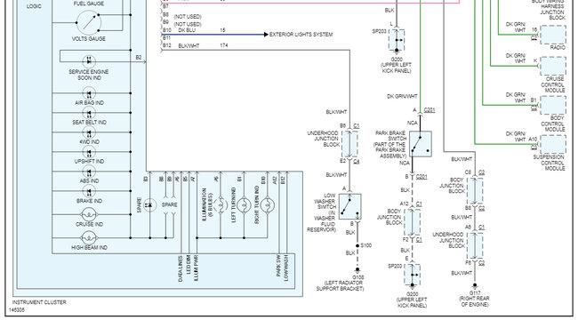

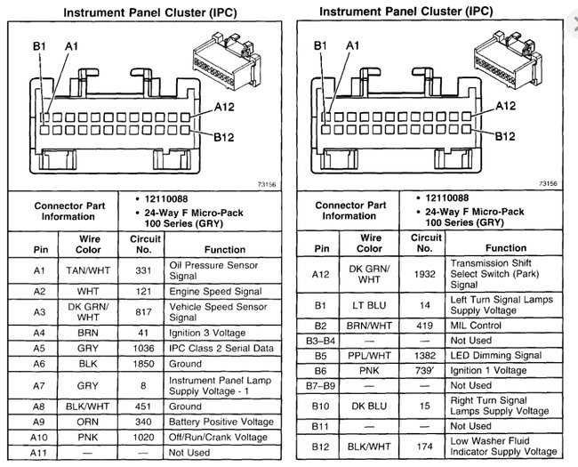

No power to Instrument cluster displays.
Monday, June 27th, 2022 AT 12:49 PM
2 Replies
SHANE SANDERS
MEMBER
2 POSTS
I believe the wiring harness pins are loose and need to be removed and tightened or replaced on the vehicle side of the harness.
Monday, June 27th, 2022 AT 1:19 PM
SQM
MECHANIC
6,383 POSTS
I have attached the wiring schematics for the gauge cluster as well as the pinout.
Let me know of any questions.
