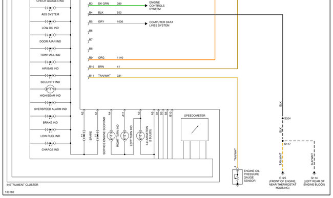

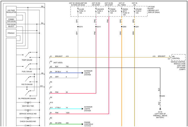

I need the wiring diagram under dashboard for the van listed above.

Please see below, I had to split the diagram. Hope this helps.
