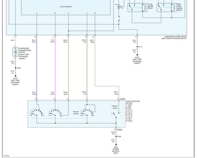

windshield wipers only work on high and do not return down when turned off. Washer quit working at the same time

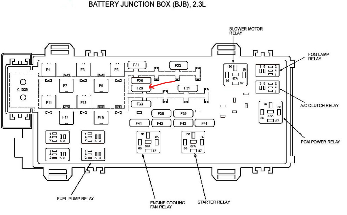

Lets check the fuse # f29 - 30 amp in the fuse panel under the hood on the left side. This guide can show you how and I have the location in the images below.

both fuses were ok.

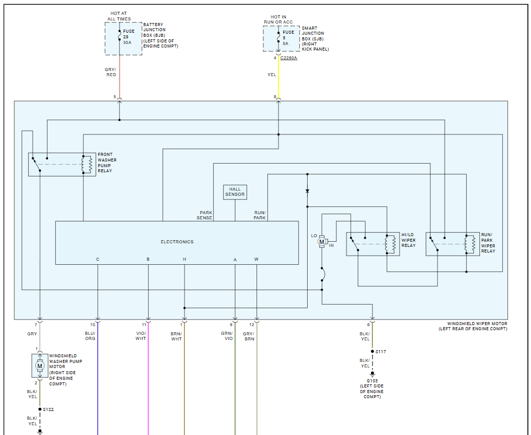

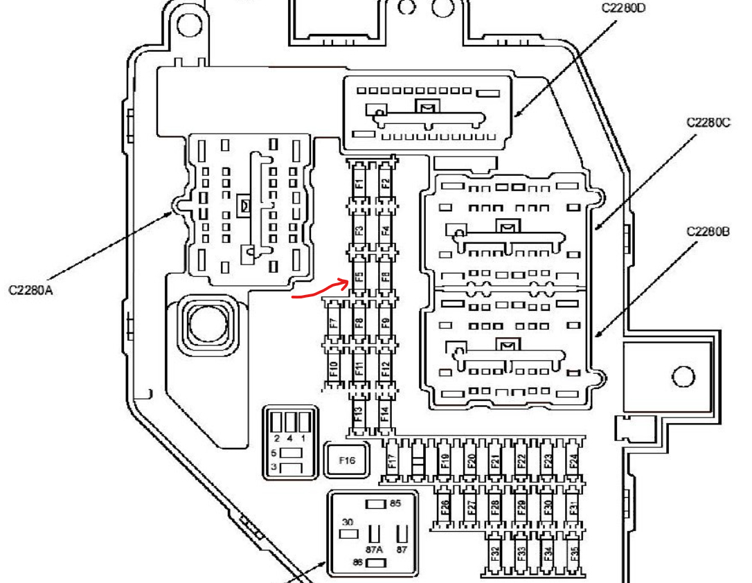

Sorry, I should have you check the 5 amp fuse #5 in the smart junction box at the same time which is at the right kick panel. Here is the location. Check out the images (below). Let us know how it goes.

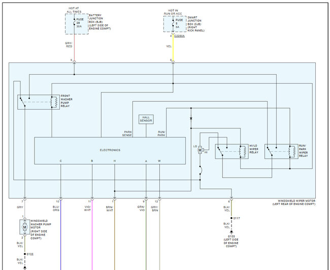

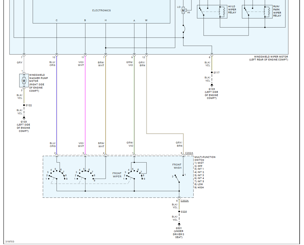

This wiper system has a logic module and a switch that controls it, Also, check the ground G103 at the left side of the engine compartment. Here is the wiring diagram for the system so you can see how it works. If the fuse and ground are good chances are the switch or wiper motor are bad, you can use a voltmeter to test through the switch by following this guide.
If the switch is good replace the wiper motor. Check out the images (below). Let us know what you find.
