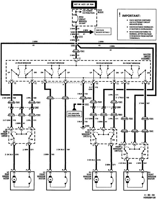

HSGGUZ
  • 1996 BUICK CENTURY
  • 6 CYL
  • FWD
  • 49,000 MILES
Put new window motor in. Now the front windows won't work. Back windows work. Checked power coming out of the switch-good. Checkedpower going to the motor-good. But nothing moves. Could it be a ground problem? Puzzled? Front passenger side worked before and had problem with driver side. Now niether side don't make a sound. Getting power. Tested with light Please help
Monday, August 24th, 2020 AT 12:16 PM (Merged)
BMRFIXIT
  • 19,053 POSTS
Unplug the motor and place a bulb in the connector switch up and down does the light work if so motor no good
If not check for ground and for power when switch in up and in down position
Check wiring harness and switch too

  • 130,000 MILES
Removed old motor installed new one, window does not work. Removed new motor, installed different new motor after checking voltage it is getting 14 VDC at motor through master switch module. Window still not working. Any suggestions?
STEVE W.
  • 15,671 POSTS
Where did you test for voltage? That motor uses polarity reversal so if you connect a meter at the motor leads and push the window switch it should read battery voltage one way and reversed polarity battery voltage the other. If it does you can test the motor the same way, use a couple jumper wires from the battery, it should move one direction with the leads connected, then the opposite direction if you reverse the power feeds.
If that checks out then I would suspect that the switch or the wiring has an issue and is not allowing the proper amount of current through. That is where a VOM has a downfall, it will tell you that there is voltage but it cannot tell you if the circuit can carry enough amperage to make the window work.
To test that is not hard. Go find an old headlight bulb and wire it so that you can connect it in place of the window motor. Now try the switch, the bulb will provide a higher load on the circuit. If the bulb barely lights up you have a bad circuit, if the other windows all work okay then the only point for the bad connection would be the switch or its power connection at the switch.
