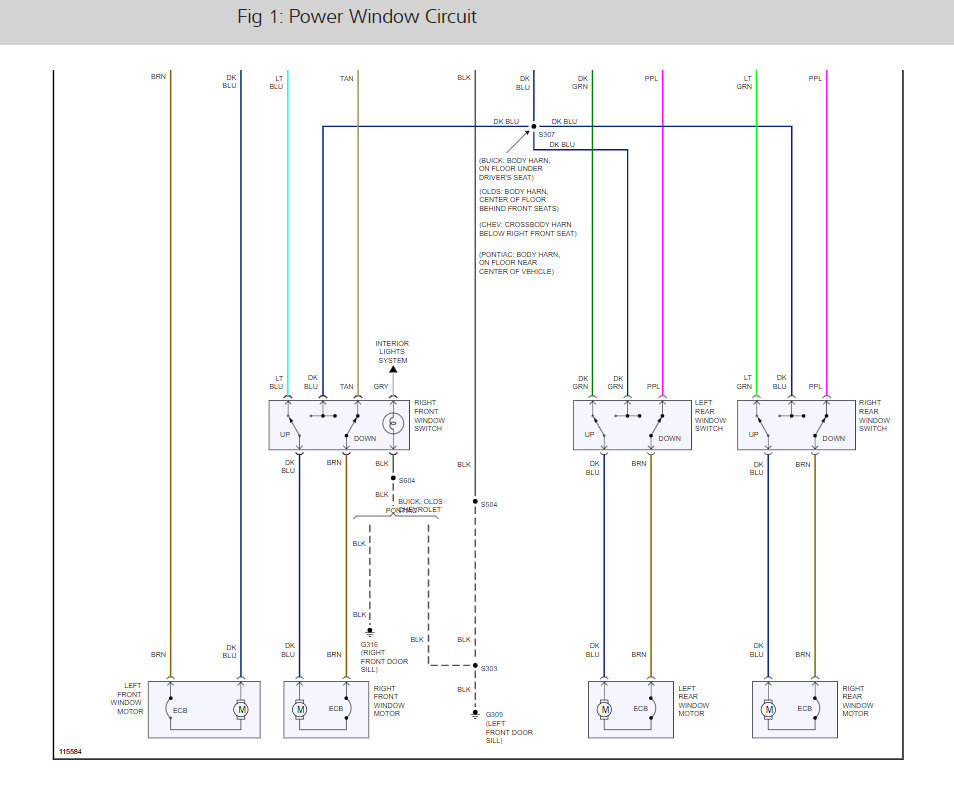

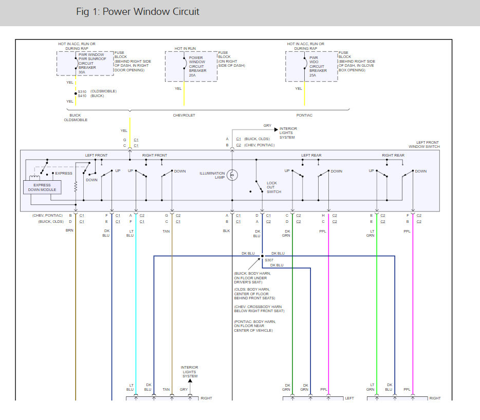

No power to circuit breaker, I'd like to know the wiring diagram from the breaker to Power source.
Thank you! Carl
Sunday, June 1st, 2008 AT 9:34 PM
20 Replies
JDL
  • 16,098 POSTS
If your vehicle has ( retained accessory power, rap ), the voltage to the circuit breaker comes from the accessory timed delay relay, the voltage to the relay comes from ign 2 maxi fuse 60 amp, should be under the hood. I didn't look to see what else that fused circuit controlled. As far as a blown fuse, I don't usually get that lucky. Check out the diagrams (Below). Please run this test and get back to us.

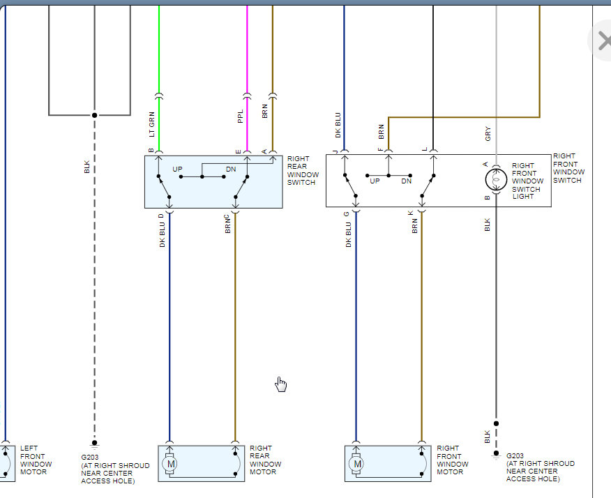

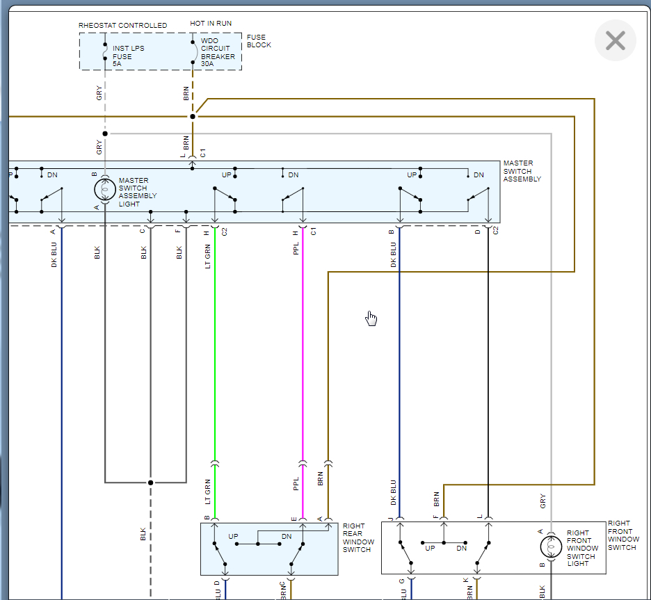

I recently bought a 1994 Buick Century. The front Power windows will not work. I bought a new motor and removed the front passenger drive motor. I tested the old one and found it to be really weak. I have lubed the track and moved on. At the switch on the passenger side I only get voltage for the Power Locks. I get nothing for the windows. I have checked the "circuit breaker" for continuity-it's fine. I get voltage at the fuse pannel for the windows (the rear ones work fine). My Chil#on manual is dissapointingly vauge on this subject.? Are there any fusible links involved in this system? Does the passenger side switch rely on the driver side switch for voltage? Any bases I haven't covered? Throw be a bone, please. I.E. Test points etc.
Tuesday, August 4th, 2020 AT 12:34 PM (Merged)
SERVICE WRITER
  • 9,123 POSTS

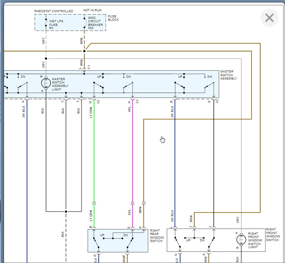

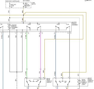

https://www.2carpros.com/forum/automotive_pictures/30961_buicen_1.jpg
Based on the diagram, I would say the passenger switch relies on the master switch.
However electrical is not my strong point.
+2
HAZGRAY
  • 10 POSTS

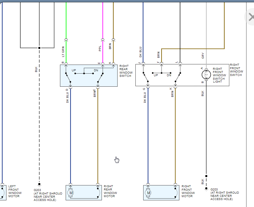

Thanks for the quick reply. I'm a bit of a retard when it comes to electrical diagrams. Ask me to rebuild a SB Chevy, no problem. Tell me to install an am Radio and my-you know what-puckers right up! Based on your diagram, which points should I "jump" over to supply the passenger side directly with power? Your diagram is much more enlightening than the chilton B&W garbage. The resolution is a bit weak in this format. Are the "up and down" legs going to the passenger side switch assy. GRY and DK BLU?

Thank you for the donation, I sent you the diagram in full. IF there are anything that is still not clear, I can try to help.

Thanks to all. The problem is solved. The large ground wire going through the driver side door was broken. A 5 cent connector solved the problem. Later, I'm going to post a "lessons learned" rundown for future viewers.

5) Slice open the boot leading from the body of the car to your door. This is where I found my problem. The large ground wire (black) was broken. It is the largest wire going through the hole, which makes sense because any break in the insulation of that wire will focus stress at that point when you open and close your door.
6) Start the process at the drivers side. The switch on this side feeds the entire passenger side. A broken wire, bad switch or any other Gremlin here will throw you off on the passenger side.

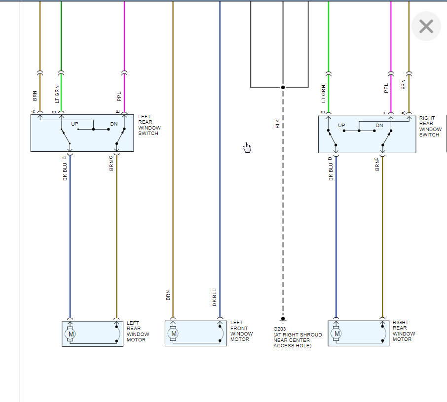

Hello. I have recently purchased a 94 Buick Century. And I tell you what. This is deadly driving without being able to roll windows down. I’ve checked the main areas all seem to be in place before I do anything dramatic. Like break a window. Jk. I think I’ll cut the boot between the door and vehicle to see if any wires are crimped torn or frayed. If that’s not the case maybe there is a main fuse somewhere. Although the back
Passenger window works Any thought or ideas.
Anything helps.
Sedgewick M
Tuesday, August 4th, 2020 AT 12:35 PM (Merged)

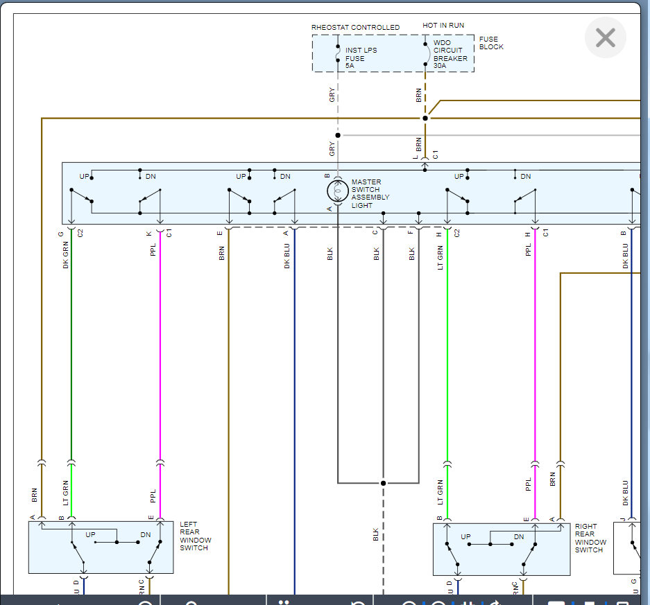

Take a look at the attachments. This is the wiring diagram for these circuits. You will see that each of the motors is run off of the same 30 Amp fuse which feeds directly to the master window switch. Then each other switch is feed off of that. You may not be wrong that it could be a wiring issue to the motor but it is not a fuse if the passenger rear works.
Let's check the wiring as you said and then maybe just run new wiring from the switch to the motor to see if it works. If it does then it is definitely wiring.
