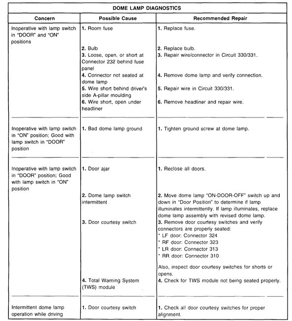

MARCUS585894
  • 5 POSTS
I took the ground cable off cleaned good put it back on and the car started right up. For some reason the dome light still does not come on bulb may be blown. Thanks for your help.
Sunday, September 23rd, 2018 AT 4:15 PM
  • 110,194 POSTS
Happy to help. Let me know if you have other questions. By the way, there was a technical service bulletin for intermittent dome light issues. It is not a recall, but the TSB indicated there were several concerns. I attached the diagnosis flow chart for you to see in case the bulb itself is not the issue.
I hope this helps you.
