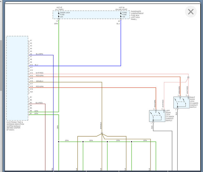

When I pull up/push down on the driver side door lock knob, it should lock/unlock the other doors (according to the manual). However, mine does not. I've already tested the ETWIS and both the front door key cylinder connectors.
Jun 13, 2022 at 7:28 PM
So, if the door switch is not unlocking any of the doors, then we need to go to the ETWIS and check to see if the switch is giving the input to the module.
Here are a couple guides that will help with this:
https://www.2carpros.com/articles/door-panel-removal

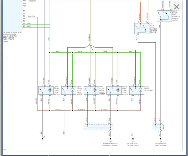

I am attaching the diagram below but if the switch is working and sending voltage to the module then we will need to check the output voltage, but I suspect the module will be the issue.
However, if you say you already checked the module this way then the switch or wiring would be the likely cause.
Let's start with this and go from there.
Thanks

Okay, I fixed it but I'm going to explain it here for anyone else who may have this problem.
So it turned out to be my door lock actuator in the driver side front door. The door lock actuator gets power from the ETWIS and it, in turn, sends the signal for whether the lock is up or down via continuity check. What really tipped me off is the behavior it exhibited when I unplugged it. It was almost as if continuity was restored for a brief moment, activating the power locks.
