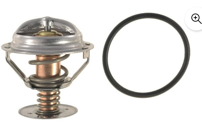

I replaced the fan thermostat. I started the car and turned on the A/C. The fan started to work almost immediately. After 30 seconds the fans stopped. Started again in 20-30 sec, stopped again. Is this normal? (Not run continuously)
I thought I have fixed the issue if the behavior is normal. But I was lost after I tested the old thermostat. Looks like it is good and behaves the same as the new one. (I learned from a YouTube video: put to ohms and touch the pin using a multimeter and use a hair dryer to heat the thermostat and I saw the reading going down.)
Really do not know what’s going on. In the summer it was super-hot in the front and my hand could not even touch the hood support rod.
I also bought the round thermostat (see attached picture). It can be installed inside the coolant tube. When the coolant temperature is high it will open and let the coolant to circulate. But I do not think I need it. Yesterday I drove the van for about half an hour. Then I touched the coolant tank and could feel the coolant inside is hot. That means the coolant was circulated. If the thermostat is bad and never open, the coolant should remain cold all the time. Am I correct?

Merry Christmas to you as well, if the A/C system is on the fans should not cycle. When the A/C system is off the fans will cycle. Hope this helps.

It sounds normal really. Modern cars tend to run very hot. Coolant temperatures well over 200 are normal while running. If the light or gauge isn't showing hot then it may be normal. What I would do is get a non contact thermometer and check the various parts of the system with that to see the real temperatures. I would suggest not driving with the hood on the secondary catch, I have seen the results of that and it wasn't a good thing.
