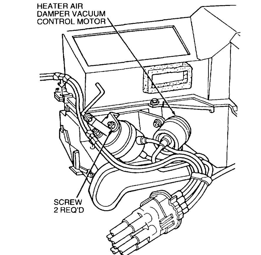

Is there a way to manually working defrost door without tearing dash apart? Don't care about A/C right now. Defrost and floor heat would be nice. Hot air flows great through vents not defrost or floor.
Tuesday, August 27th, 2019 AT 9:42 PM
There is a vacuum motor in the diagram I sent you. That is for the modes. You would have to move that arm and lock it in the position you desire. That does not require dash removal. It is accessible from under the dash.

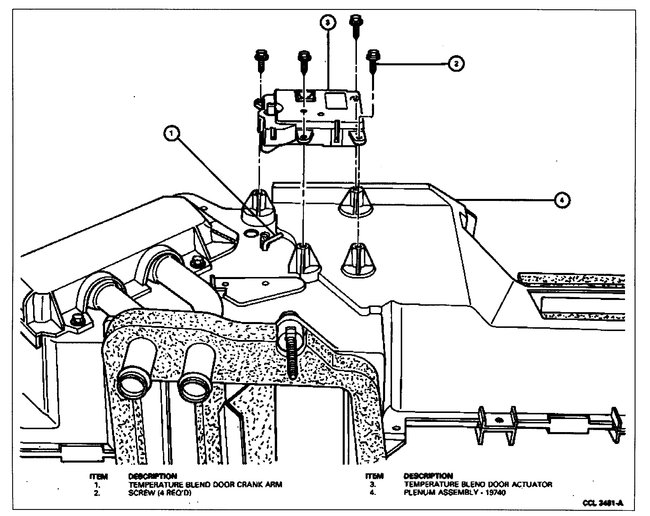

5) If both hoses are hot, then the problem is in the vehicle. A component called a blend air door actuator is likely not working. This actuator moves a door in the HVAC system which allows warm or cold air to enter. Here is a link that shows in general how one is replaced:
__________________________
Here are directions specific to your vehicle for replacing the blend door actuator. The attached pic correlates with the directions.
1996 Lincoln Town Car V8-281 4.6L SOHC
Air Door Actuator
Vehicle Heating and Air Conditioning Air Door Actuator / Motor Service and Repair Procedures Blend Door Motor Air Door Actuator
AIR DOOR ACTUATOR
Removal
1. Remove instrument panel assembly. Refer to Instrument Panel/Service and Repair. See: Instrument Cluster / Carrier > Procedures
2. Disconnect the electrical harness, to the temperature controller on the control assembly, from the blend door actuator.
Temperature Blend Door Actuator
Pic 1
3. Remove four screws and remove the blend door actuator from the plenum assembly.
Installation
1. Position the blend door actuator on the plenum assembly. Be sure the actuator cam is properly engaged with the temperature blend door crankarm.
2. Install the four screws that secure the blend door actuator to the plenum assembly.
3. Connect the temperature controller electrical harness to the blend door actuator.
4. Install instrument panel. Refer to Instrument Panel/Service and Repair.

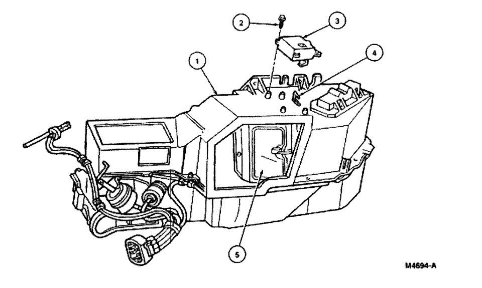

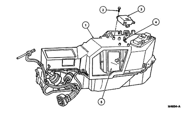

RACEFAN966
  • 5,029 POSTS
It sound like a heater blend door problem or blend door actuator (which is on the top of the blend door). This is what directs the air coming in and when it fails or brakes it will not direct the air through the heater core. Here is a pic of a blend door and like I said the actuator is on top if it. Also be sure both heater hoses are hot, verifying water circulation in the heater core
https://www.2carpros.com/forum/automotive_pictures/249564_379286_2.jpg
See the guide below on replacing a blend door actuator..its not vehicle specific, but will show you what is involved
See the diagrams below for the actual components of your vehicles HVAC plenum
