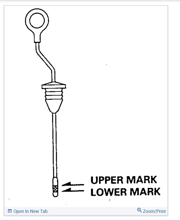

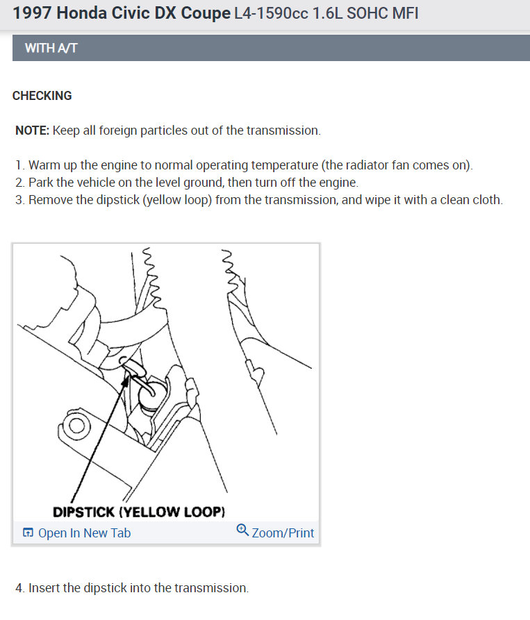

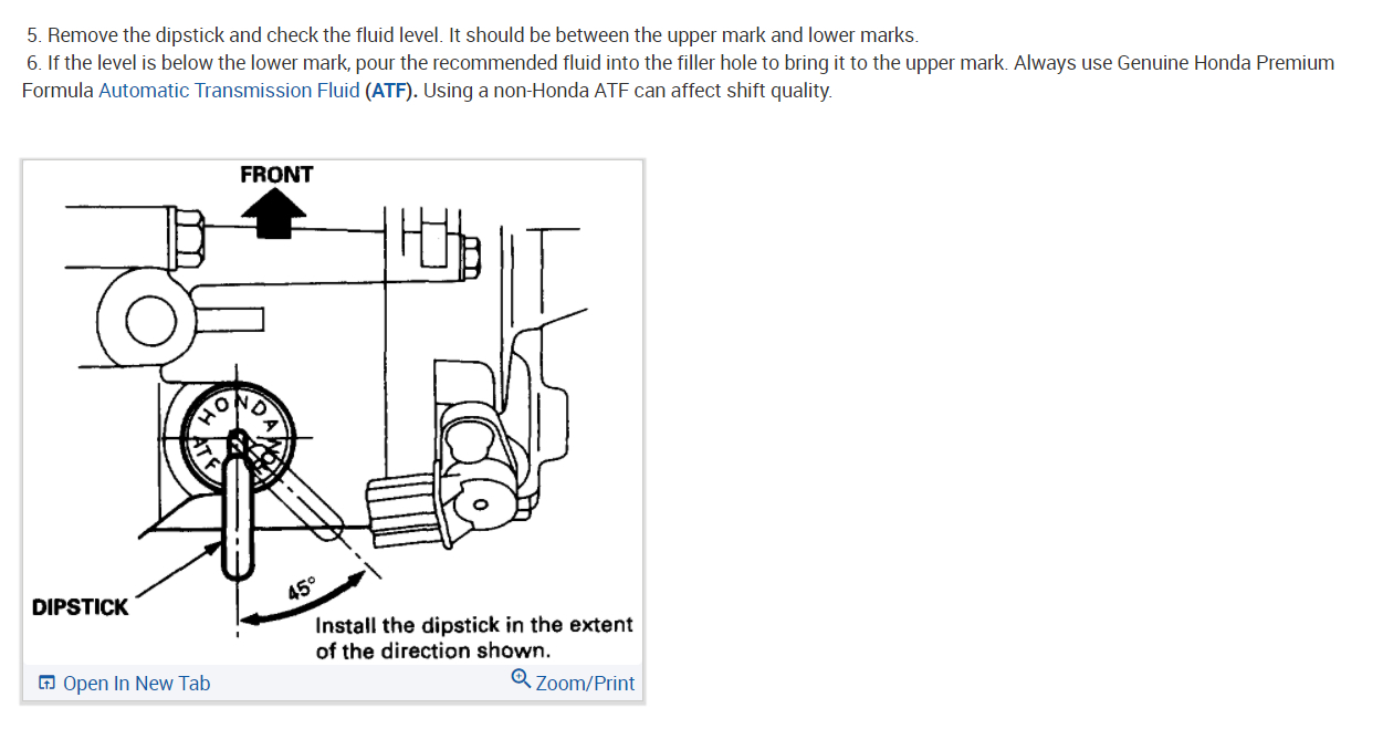

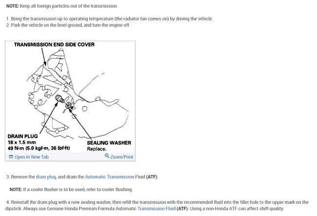

Here is a guide to help walk you through the service with instructions in the diagrams below to show you how on your car:
Automatic Transmission Fluid Capacity:
2.7 L (2.4 Imp qt.) at changing
5.9 L ( 5.2 Imp qt.) at overhaul
Fluid Type .................... Genuine Honda Premium Formula ATF
Sep 11, 2020 at 4:39 AM
