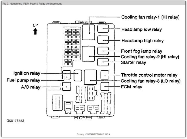

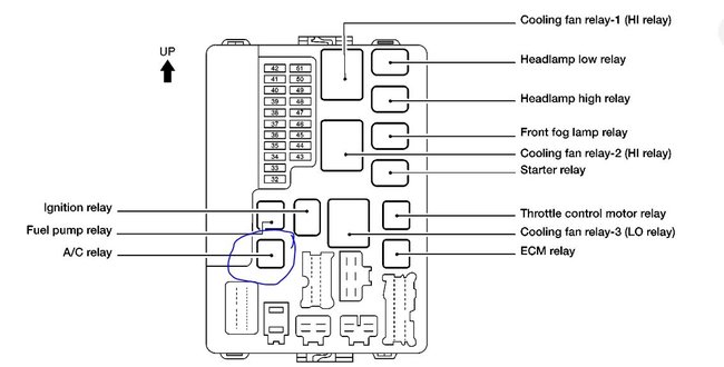

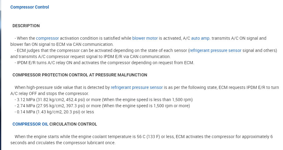

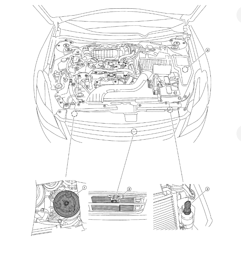

Compressor operation is intermittent. Relay is suspect. Where is the compressor relay?
Sep 13, 2020 at 7:43 PM

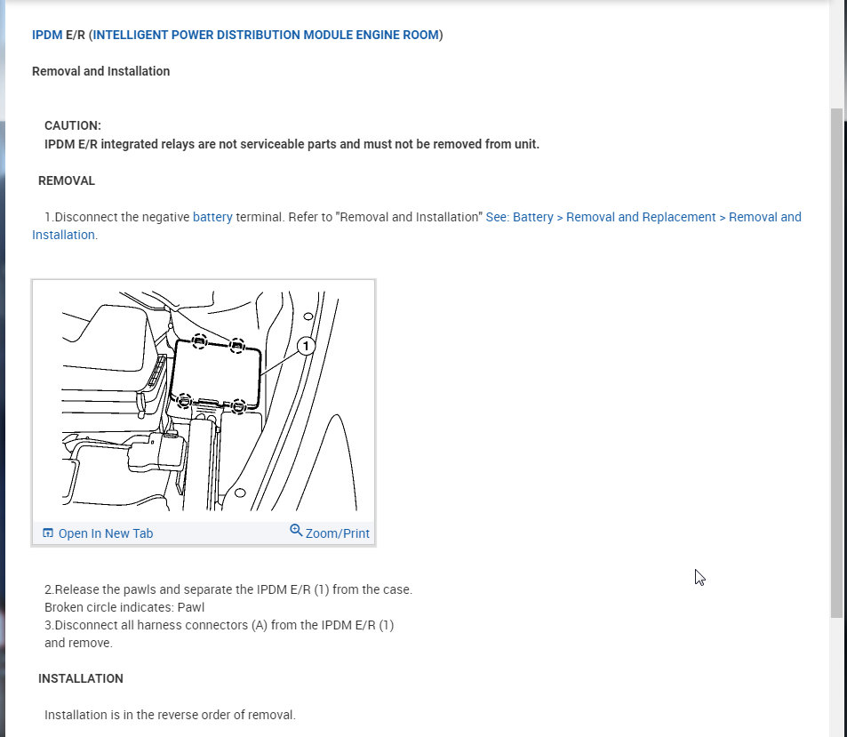

This is part of the IPDM E/R. It does not appear to be serviceable. To confirm this, we need to check power coming out of the relay when this is acting up. If the power is coming and going then you are probably correct. However, if there is constant power, then your compressor is most likely the issue.
Let me know what questions you have after reviewing this. Thanks

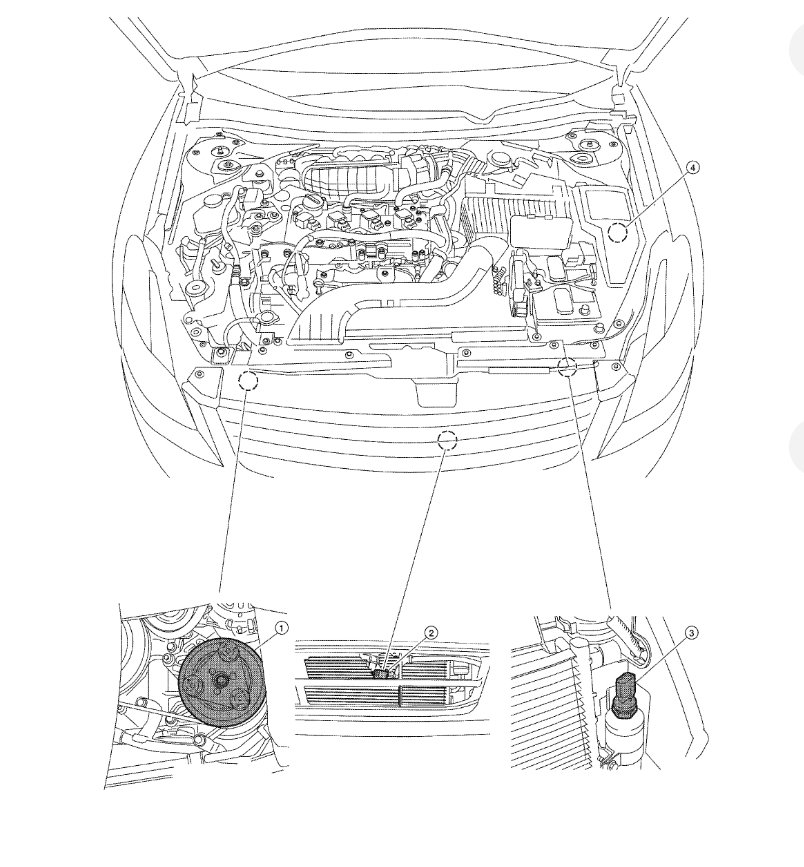

I know that the compressor relay is located in the intelligent power distribution module (IPDM) located under the hood. See the attached pic.
The relay is not replaceable separately,
Let me know if I can help.
Joe.

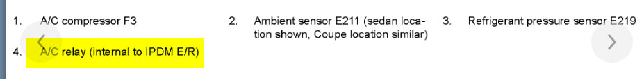

According to the service manual the relay is internal to the IPDM. Unfortunately that means it is not servicable. Please let me know if you need more information. Thanks

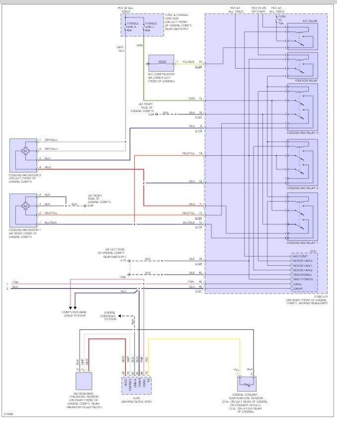

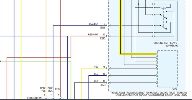

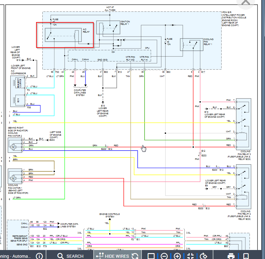

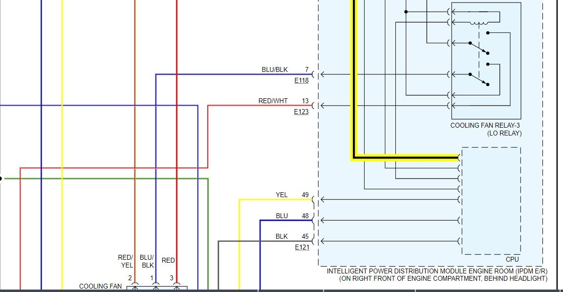

The relay is integrated into the IPDM behind the front headlight in the engine compartment on the passenger side.

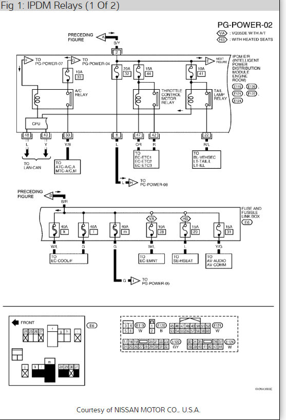

Here is a wiring diagram to help troubleshoot it:
and
Let us know how it goes, we are here to help. Best, Ken

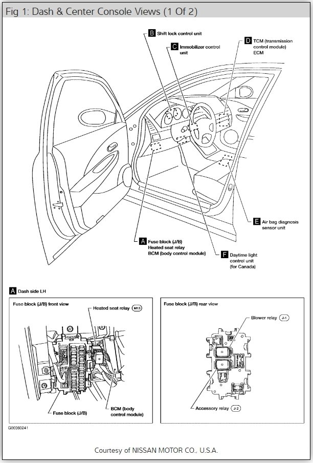

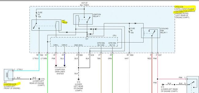

On some cars they have it as a blower motor relay but is goes to the compressor that why it's so hard to find. Check out the diagrams (Below). Please let us know if you need anything else to get the problem fixed.

The air conditioner relay is in the power distribution center under the hood, Here is a diagram (below) that shows its location in the fuse block. Here is a guide that will help you test it as well.

Where is the exact location on my car listed above, A/C relay, so i can check it to be replaced?
May 24, 2021 at 7:07 PM (Merged)

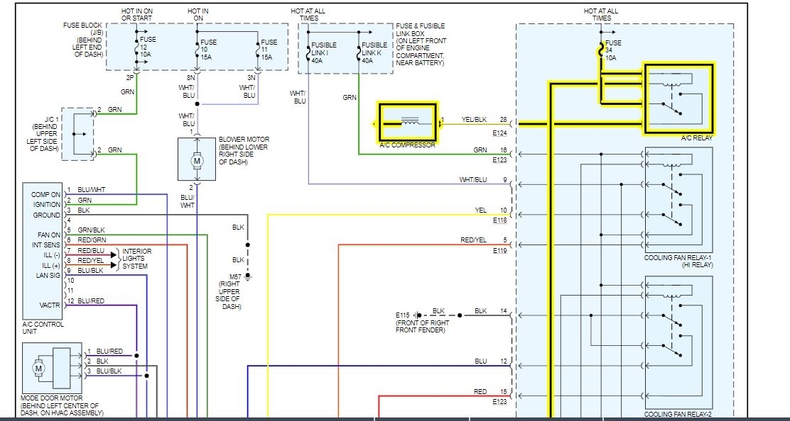

Good evening,
I attached a wiring diagram for you to view. Check the fuse in the fuse panel for power on both sides.
I also circled the location of the relay.
