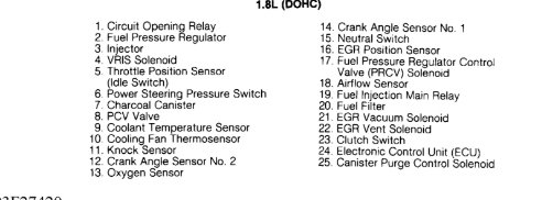

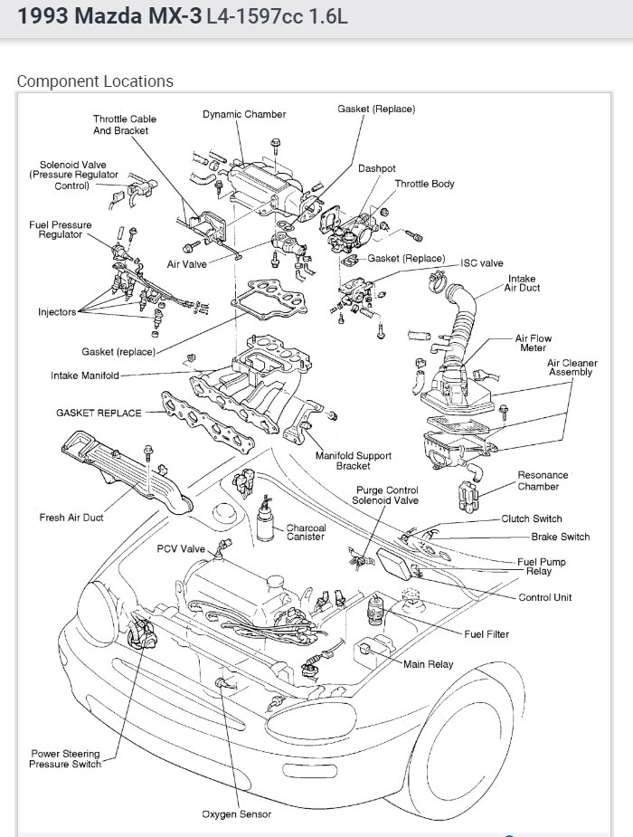

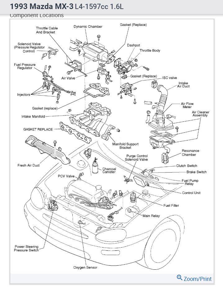

The diagram of the car you posted is for a six cylinder car. Would you possibly have one for the 1993 1.6l 4 cylinder car?
Saturday, September 8th, 2018 AT 9:58 PM
KEN L
  • MASTER CERTIFIED MECHANIC
  • 55,322 POSTS
Opps, here is the diagram for the four cylinder but I do not see the location. It should be near the thermostat housing.

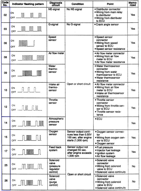

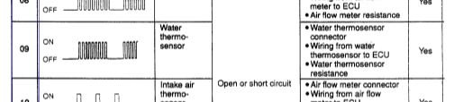

Hi and welcome back. Ken is out of town so I am going to jump in.
The code you have indicates there is either a short or open circuit. Chances are there is either a broken wire (bad connection which you already checked) or the wiring to the PCM is damaged. I have attached the flow charts for testing this circuit. If you are unable to enlarge the pictures or cannot read them, let me know.
Picture 1 shows the code and its meaning, two is cut from the page which explains what could be the issue, and three is the flow chart and wiring schematic.
The misfire is a result of the fuel mixture.
I hope this helps.

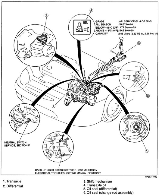

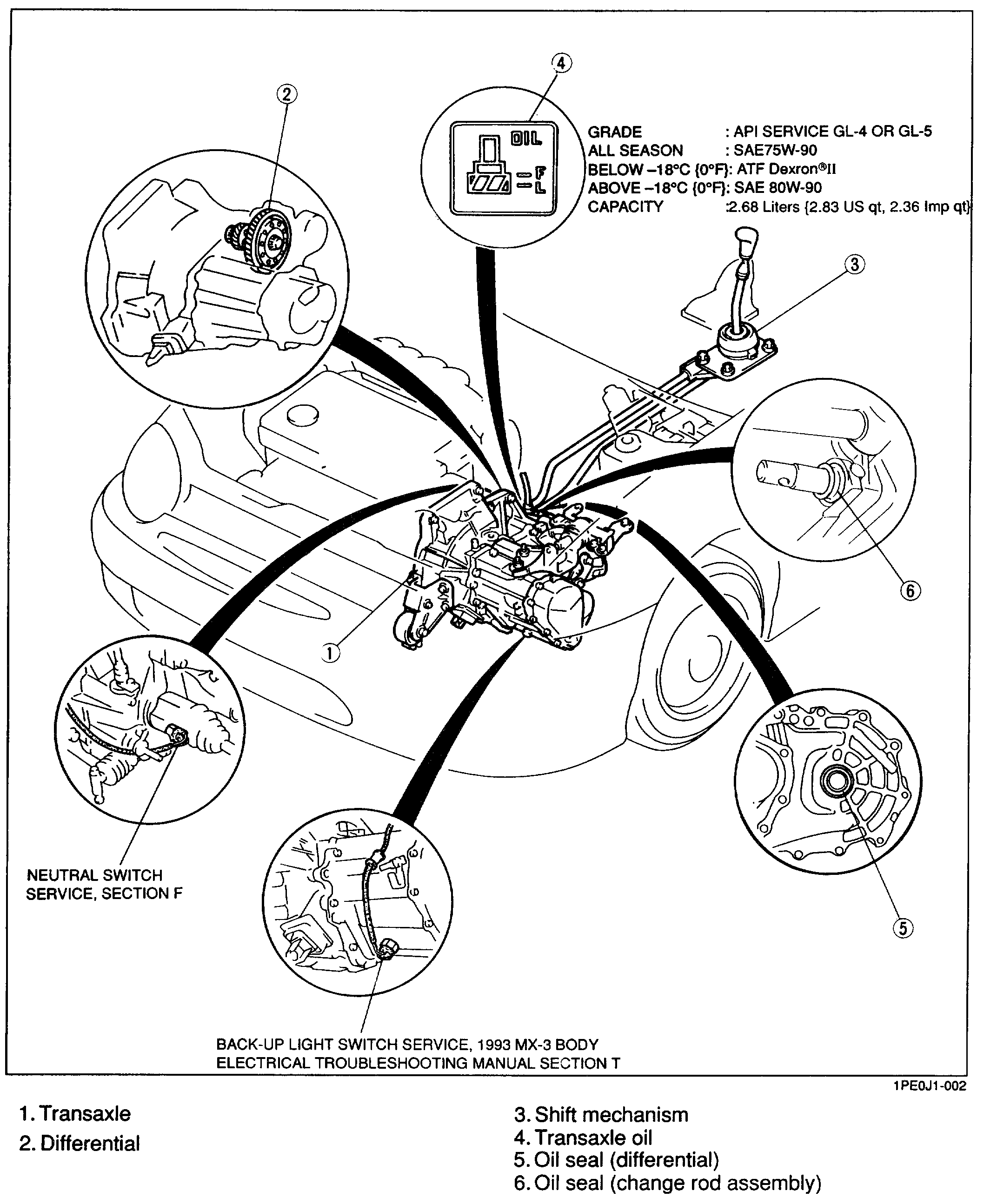

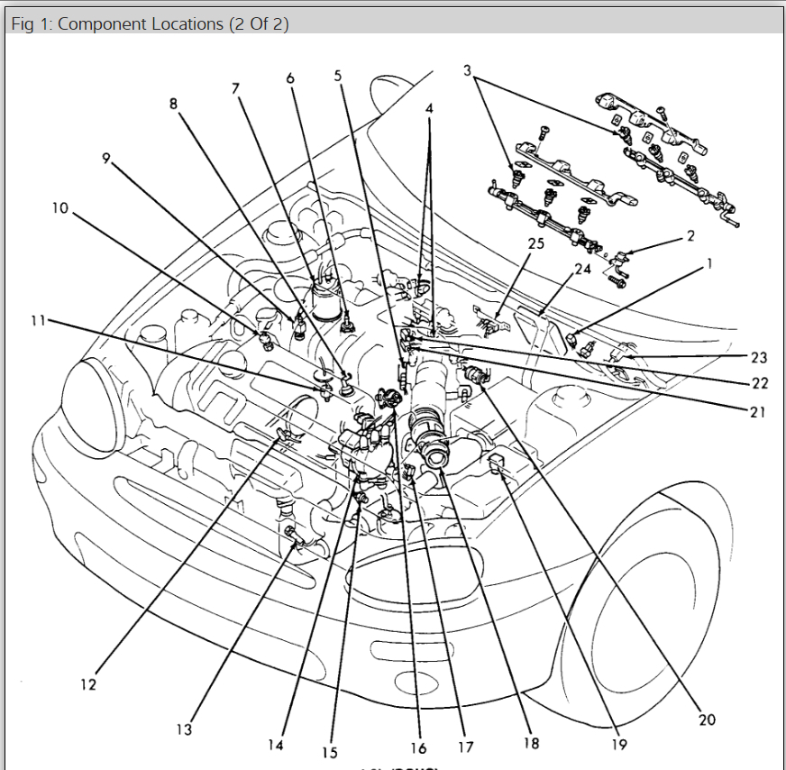

The component you are referring to is the neutral switch service. I cannot see how it could be causing this issue. See the attached picture.
If the fuel pump pressure is within the manufacturer's specs, a new one wont make a difference.

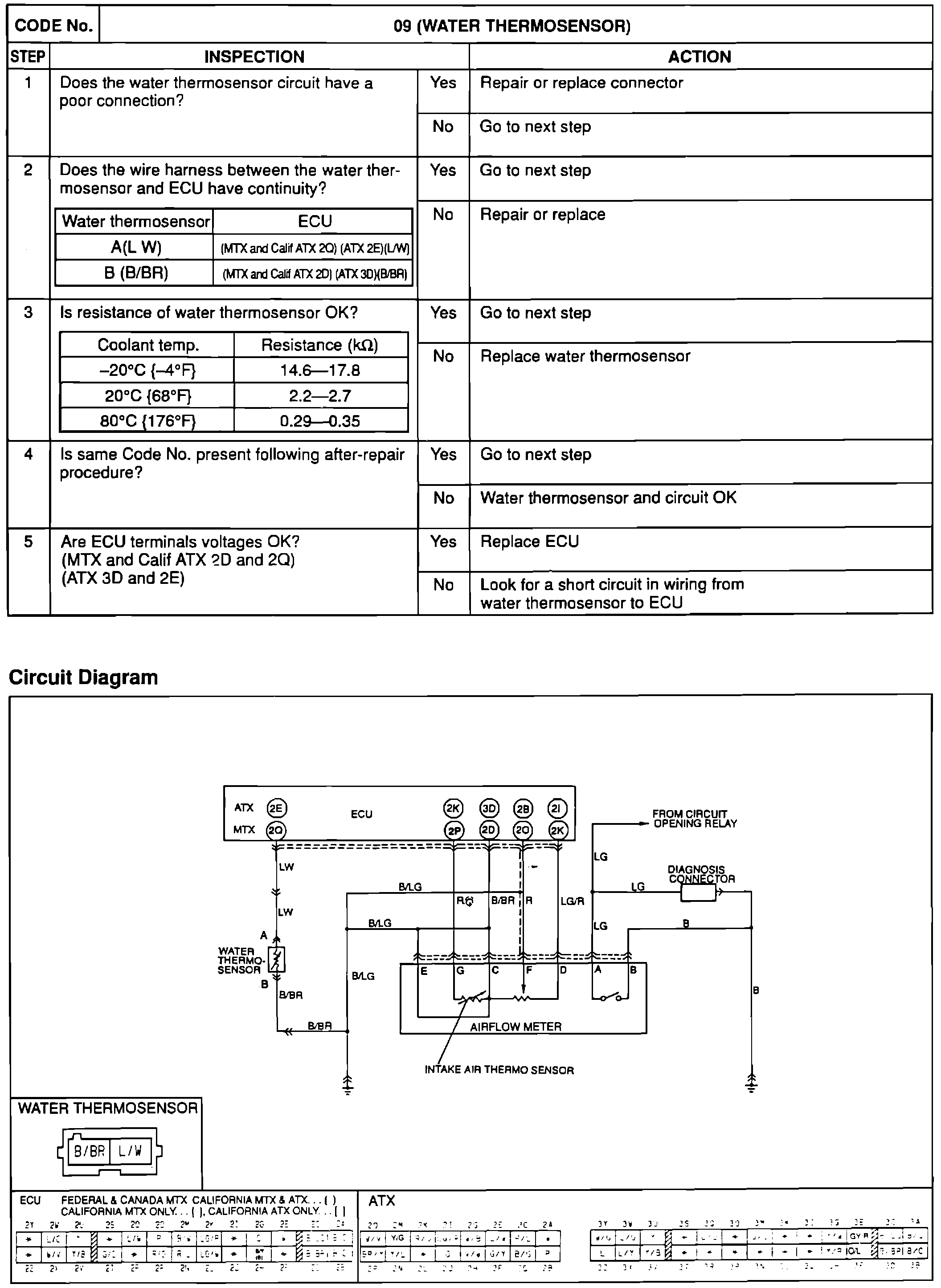

You mentioned a code 9. Either you have a short in the ECT wiring or a wire is broken and no signal is being sent to the ECU. I hate to say it, but it is time to start tracing wires to see where that issue could be. Make sure the pins at the ECM are clean and not corroded, bent, or pushed into the plug. If it all is good, you need to check continuity for an open or a short.
I have attached a diagnostic flow chart for this problem. Follow it step by step. It is picture 3. Let me know what you find or if you have other questions.
