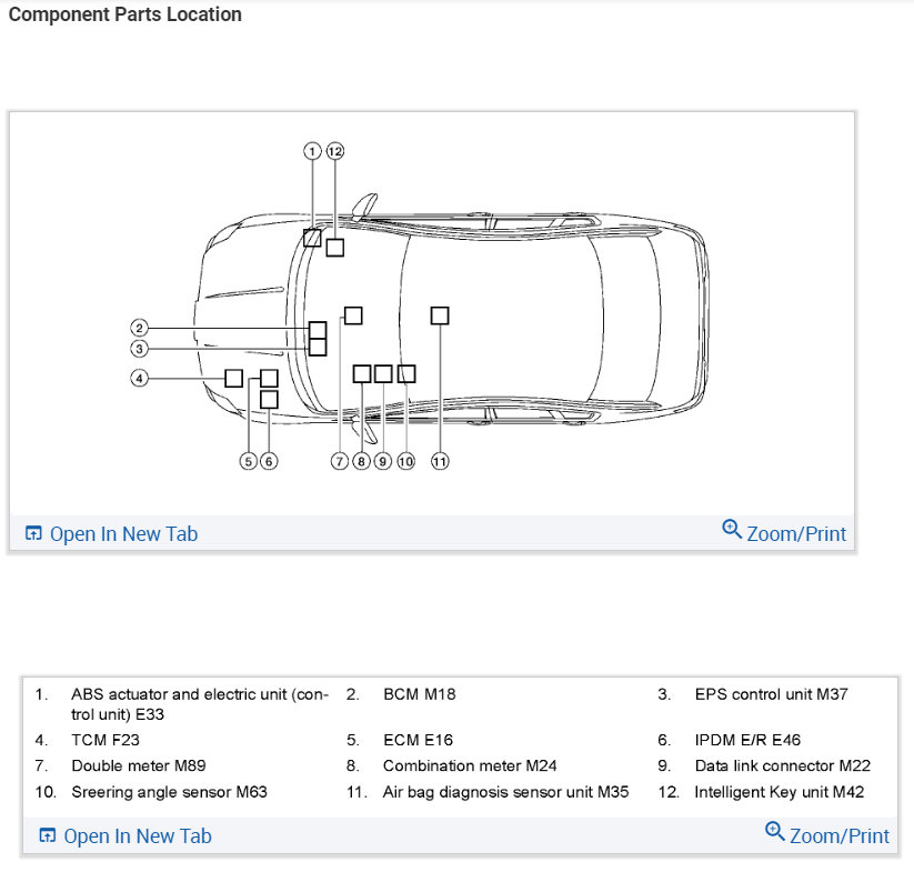

KEN L
  • MASTER CERTIFIED MECHANIC
  • 55,512 POSTS
That would do it. Here is the location of the ECM you will need to have it programmed to the car should cost about $130.00. Check out the diagrams (below). Please let us know what happens.
