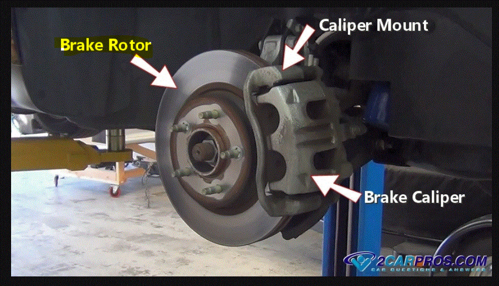

If you look through the wheel, you should be able to see the brake rotor. The brake rotor should be smooth without cuts or grooves cut into it. (See pic 1 for what a rotor looks like).

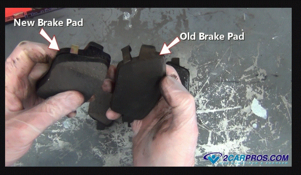

Next, pic 2 shows brake pads. They are mounted in the brake caliper and press against the rotor to stop the vehicle. You can see them from different angles, but oftentimes the wheel needs to be removed.

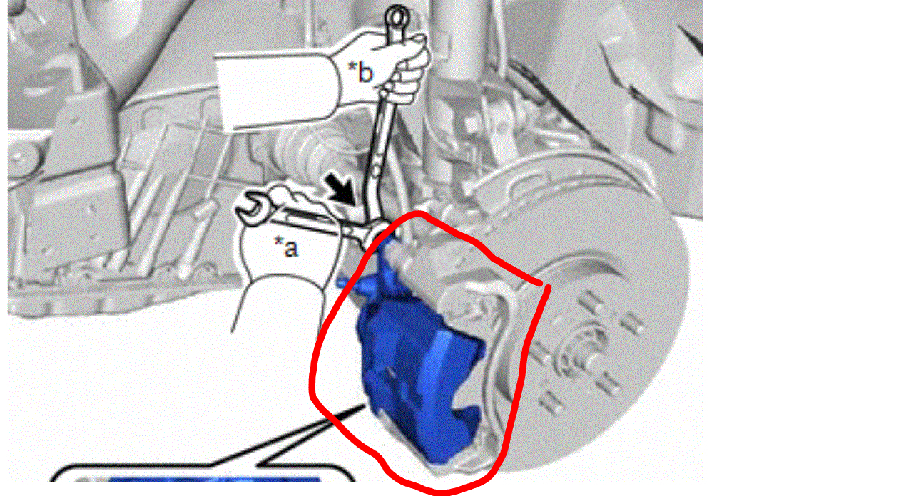

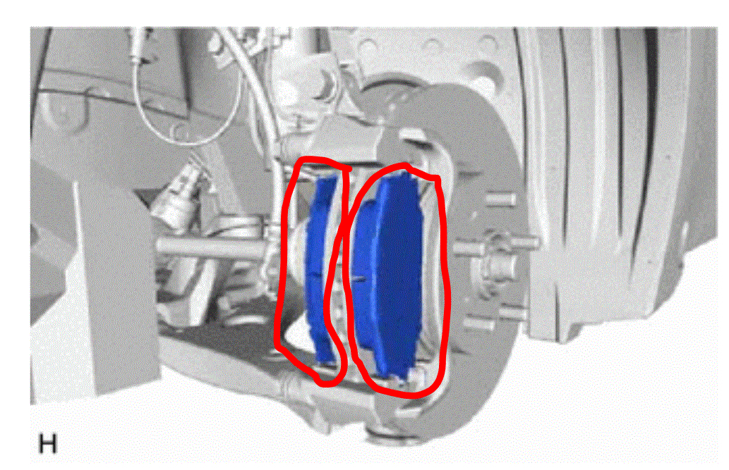

It can be difficult with the wheel on. Usually, you have to look at an angle. If you are still unable to see the pads, the wheel will need to be removed. I attached two pics below that may help. In pic 1, I circled the caliper. Pic 2 shows the brake pads after the caliper is removed.
