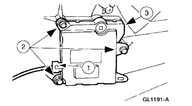

This sounds like the blend door actuator motor that is failing. The gears inside the blend door are stripped causing that noise.
I attached a picture and the procedure for you.

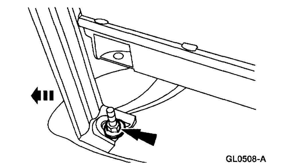

REMOVAL

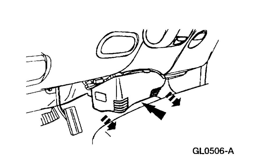

1. If equipped, remove the floor duct panel.
Remove the two plastic push pins (one each side) and release the expander clip.

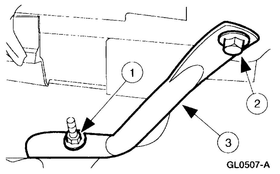

2. Remove the RH instrument panel brace.
1. Remove the lower nut.
2. Remove the upper bolt.
3. Remove the brace.

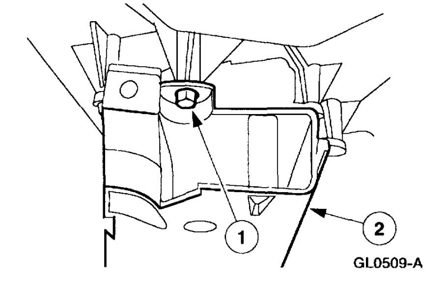

3. Remove the LH instrument panel lower nut and position brace aside.
4. Remove the floor duct.
1. Remove the two screws (one each side).
2. Remove the floor duct.
5. Remove the electronic actuator.
1. Disconnect the electronic actuator electrical connector.
2. Remove the three actuator screws.
3. Pull down to release the actuator shaft and remove the electronic actuator.

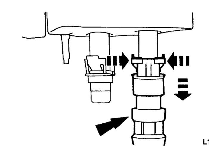

Do you know if the rear heater core will be affected if I bypass the front heater core? I am hoping by bypassing the front the extra little boost of coolant flow will kick the rear heat back on and I can live with that and maybe a heated seat cover until I have time to take the dash out and replace the front. Just tell me my theory is good to go even if it's not, because I'm about to just use it for target practice.
Thursday, October 15th, 2020 AT 1:30 AM
Bypassing the front core will not effect the rear core at all. It will not increase flow either.
There is a special tool to release the heater hose clamps. I attached a picture of the core connections for you to view.
