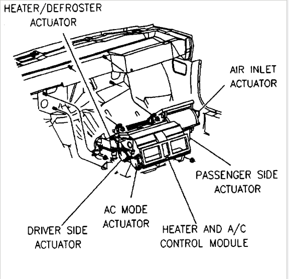

Most of the time this will be a problem caused by "mode" actuator. I would remove the actuator but leave it plugged in and then turn the system on to make sure it moves when working the controls. You can also move the blend door pivot by hand to see if it makes a difference. Here is the location of the actuator and a guide to go over as well.

Okay, I just ordered it. Also, regardless of if it's just one bad actuator, would you recommend changing all of the 3 actuators on the driver side? Since they're all the same age. Thanks.

I replaced the top 2 actuators. The bottom one (AC Mode) was the only one working fine. But it still doesn't seem to blow colder from the middle and driver side vents. Could it be some sort of blockage or a problem with the evaporator itself?

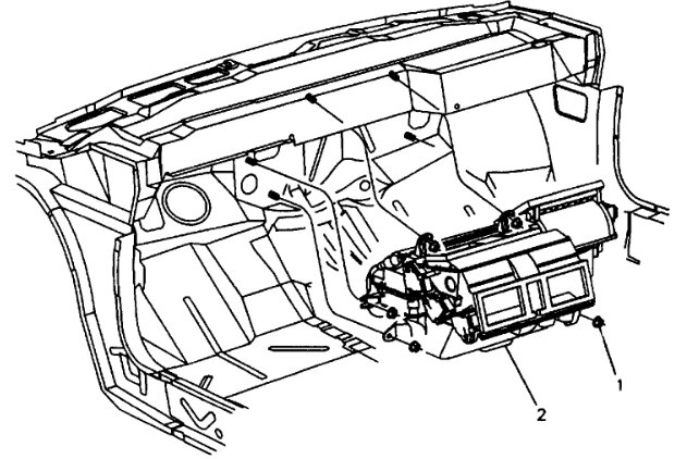

O ya, what happens is people drop things down the vent system which can hold the blend doors open, such as coins, toothpicks, ink pen etc. I would remove the actuator on that side and work the blend door pivot by hand, see if you can hear it close in both directions. This guide may help:

So upon closer inspection the middle actuator (Driver Side Actuator) was not turning at all when operating the AC settings. I tried to turn the pivot by hand and I couldn't. But with some small pliers I was able to turn it. However I turned in both directions as far as I could but there was no change in the meek airflow coming out from the middle vents.

Hmmm this is a bummer, this means the blend door has fallen apart internally the HVAC box will need to be removed and disassembled, sorry.

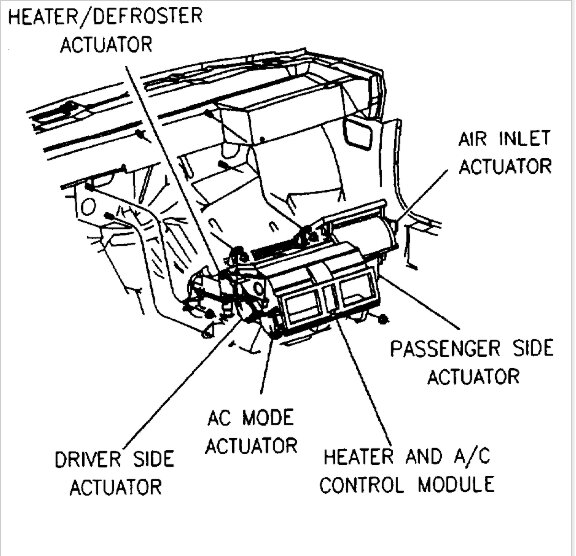

Ok I see. Would you happen to have a diagram if the HVAC box?
Sunday, August 3rd, 2025 AT 11:59 AM
KEN L
  • MASTER CERTIFIED MECHANIC
  • 55,481 POSTS
Sorry, this is all they give us.

You are welcome, please upload pictures or videos in your response of any problems so we can see :)
