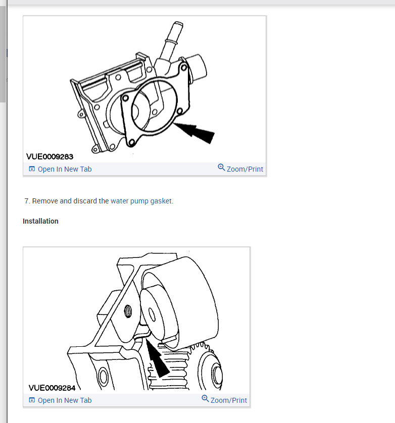

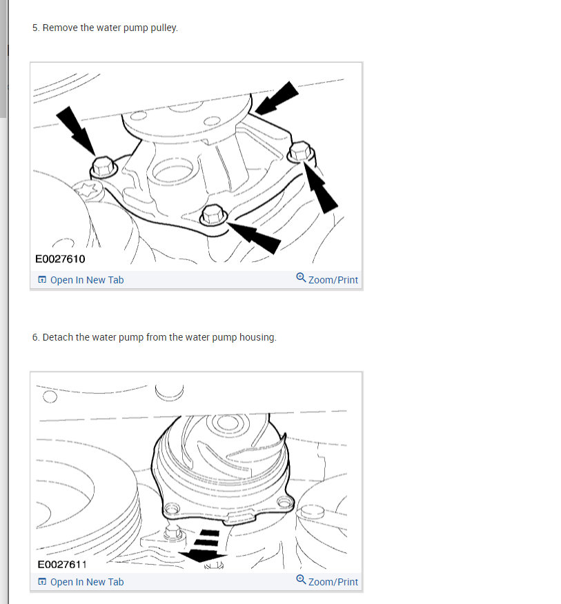

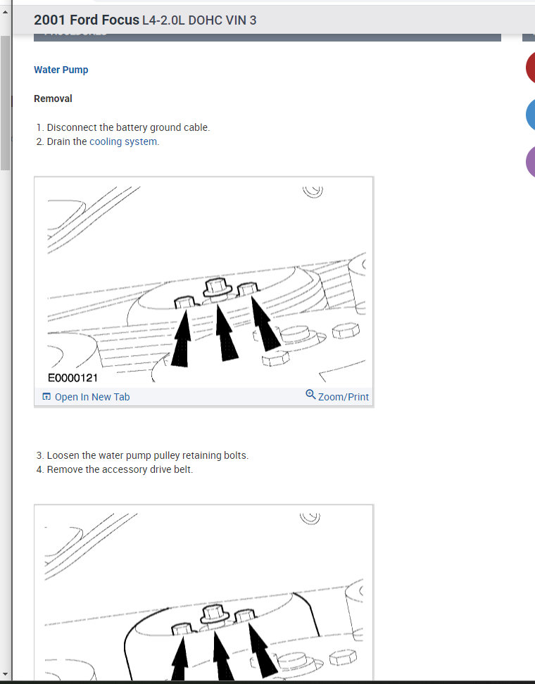

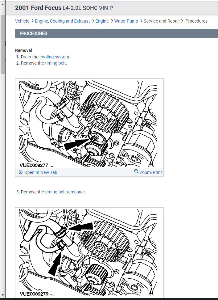

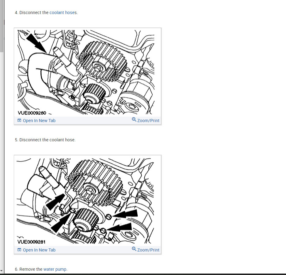

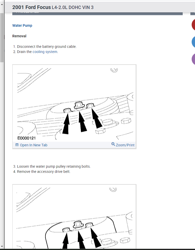

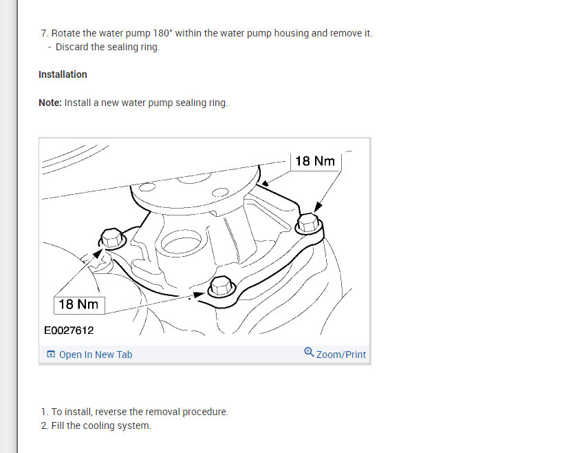

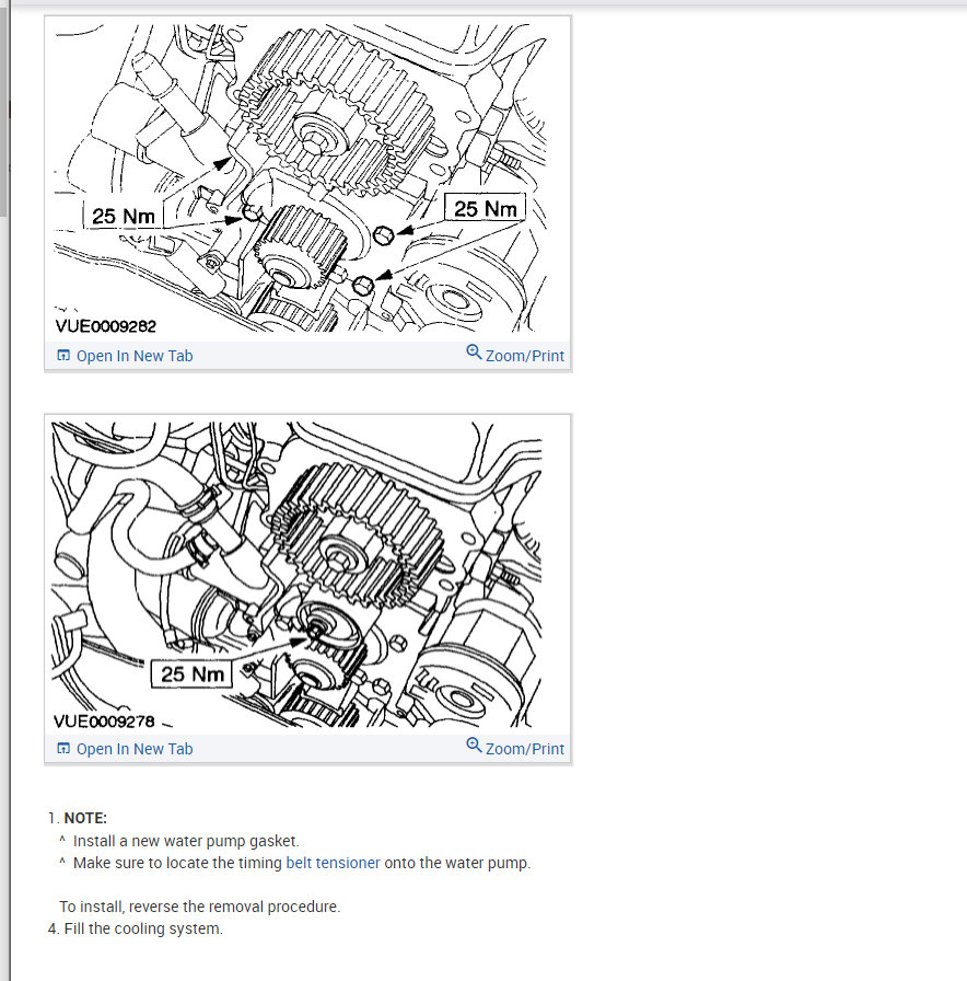

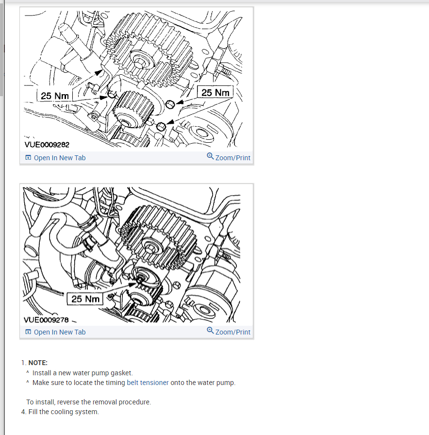

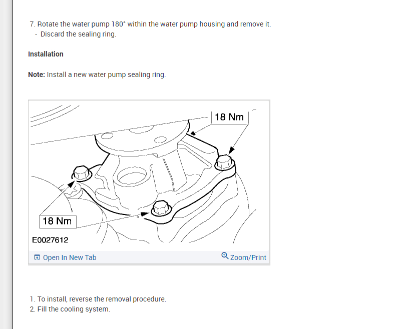

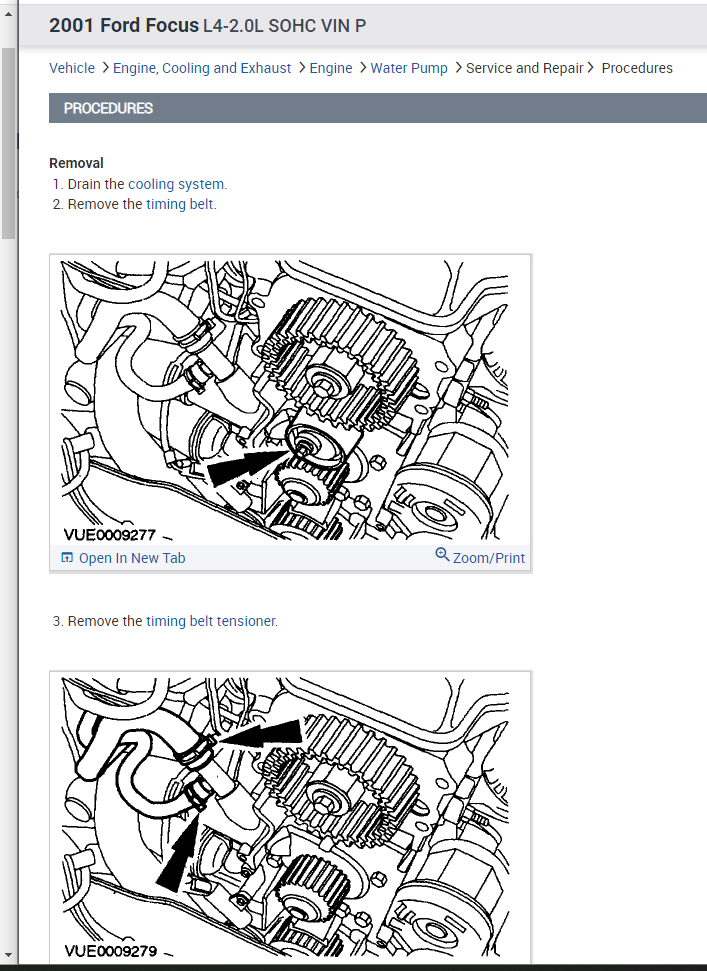

Bought a kit it came with 3 rings from what I gather they are oil seals not sure if I need them just doing pump and belt.
Sunday, September 26th, 2021 AT 1:24 AM
MECHANIC
18,907 POSTS
More than likely you do not need them as they will include seals for somethings that you may remove but are not required too.
Here is a guide that will help with this:
https://www.2carpros.com/articles/water-pump-replacement
Also, I am attaching the process for both engines, the single overhead cam (SOHC) and the dual overhead cam (DOHC).
Please run through this info and let me know what other questions you have.
