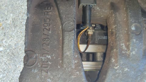

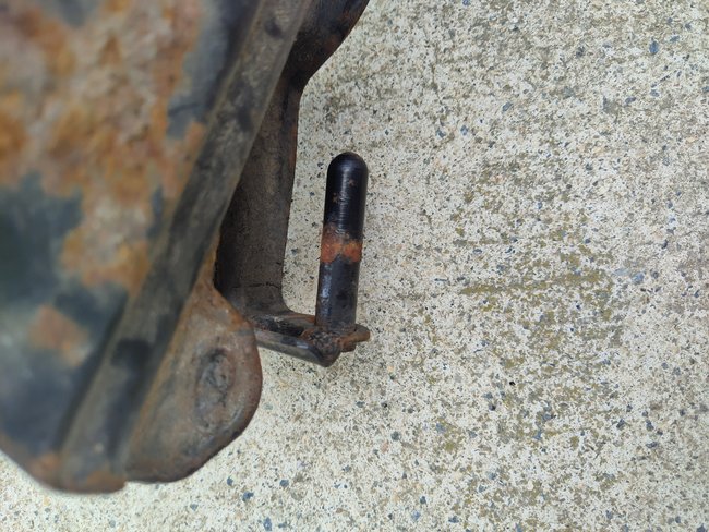

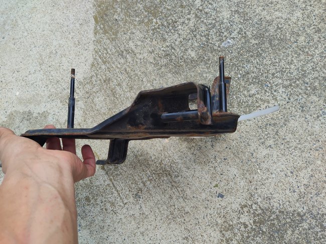

GENESIS88
  • 140 POSTS
I'm thinking it's the caliper. The wear pattern on pads looks really weird. The video the caliper seems lazy there Is a small gap that doesn't go away on outer pad.
Sunday, July 3rd, 2022 AT 8:26 AM
  • 110,192 POSTS
Wow, yes something is hanging up. Does it have caliper pistons on each side? If it does, replace the caliper. If it only has the piston on the inside of the caliper, the slides are not moving, or the brake pad is seized in the mount.
Let me know what you find or if I can help in any way,
Sunday, July 3rd, 2022 AT 7:53 PM
GENESIS88
  • 140 POSTS
Single piston caliper. I went back and lubed everything still no difference.
