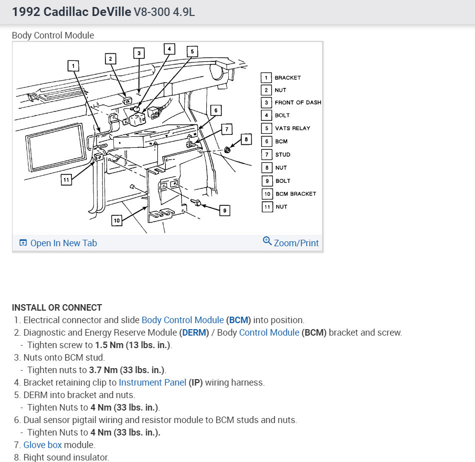

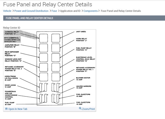

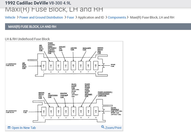

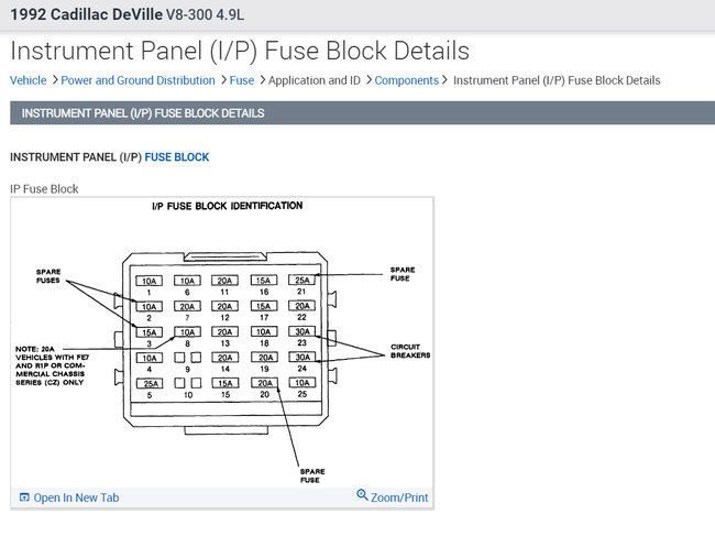

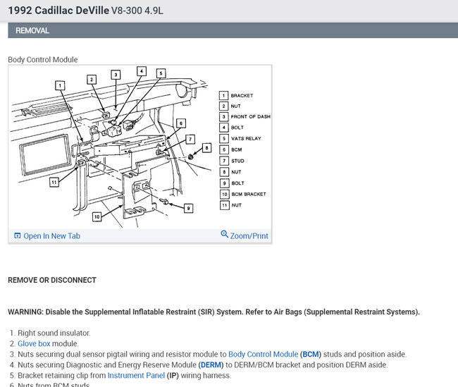

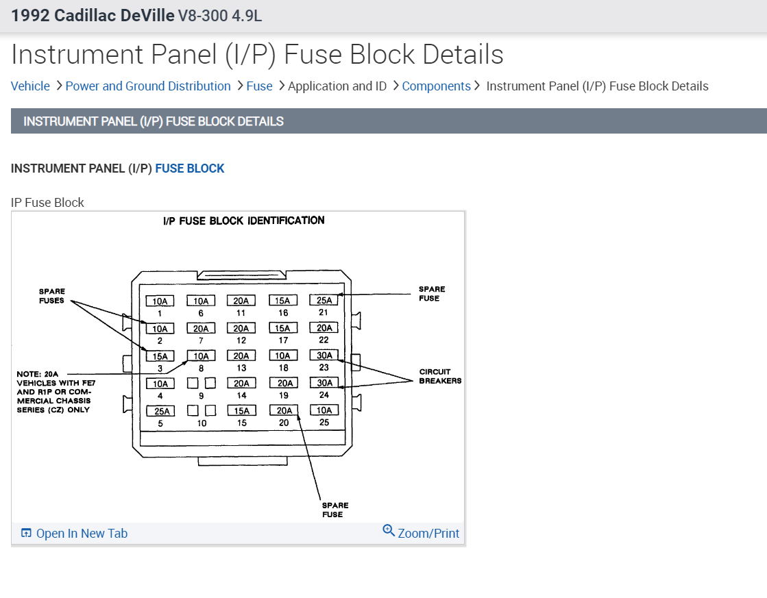

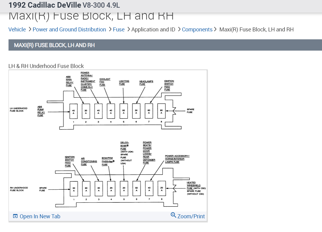

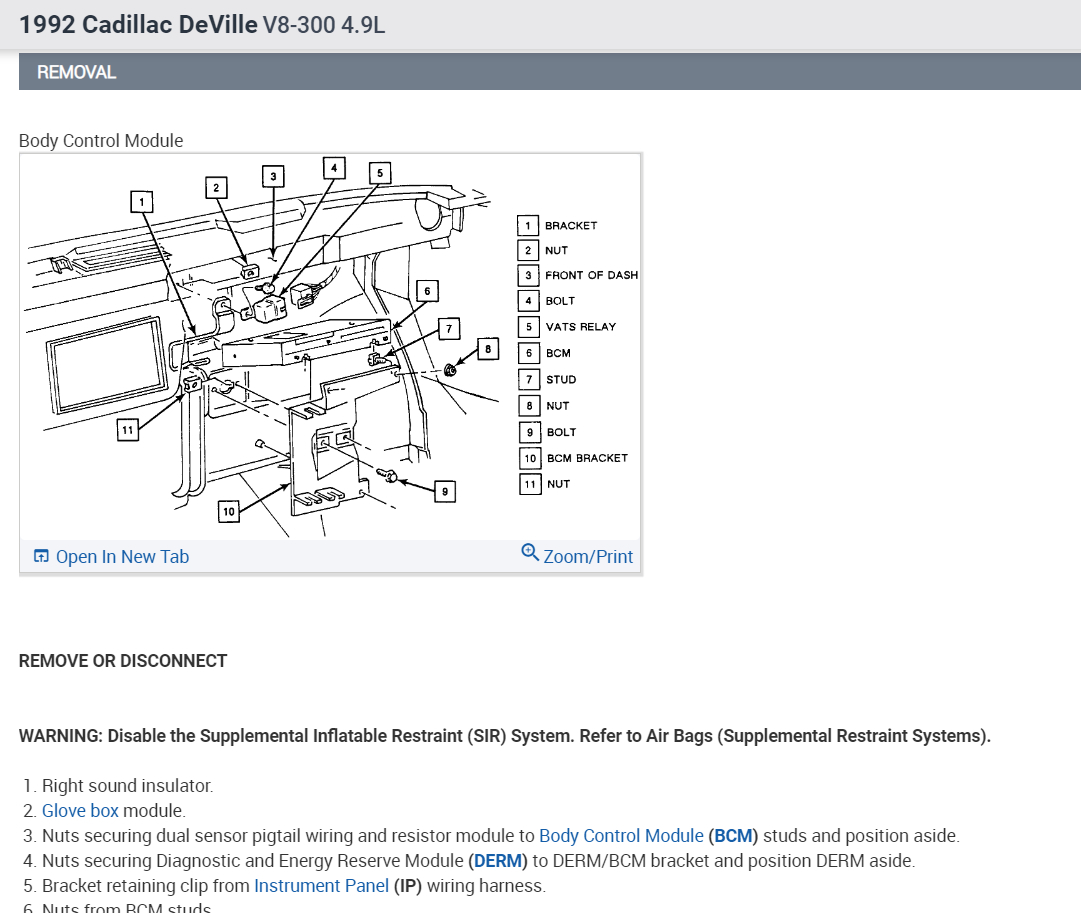

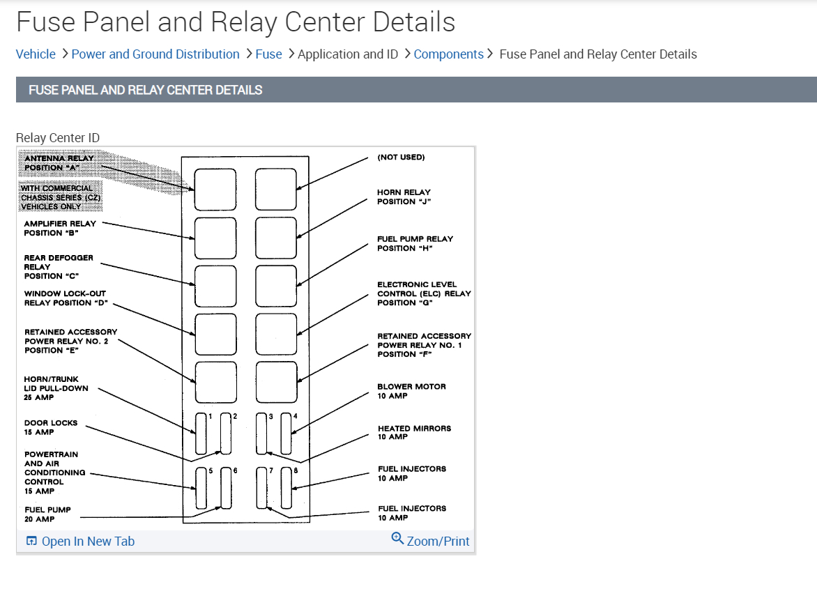

The F32 code says the BCM is not communicating with the other modules. We should check all fuses first before replacing the BCM. Here is a guide to help you and the fuse locations in the images below:
The F52 code is nothing really. Here are the instructions to replace the BCM in as well in case you need them. Check out the diagrams (below). Please let us know what you find. We are interested to see what it is.
