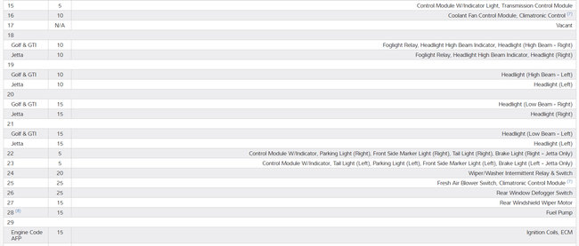

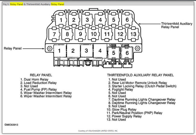

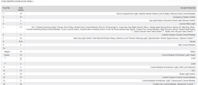

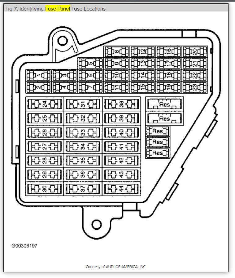

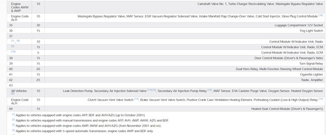

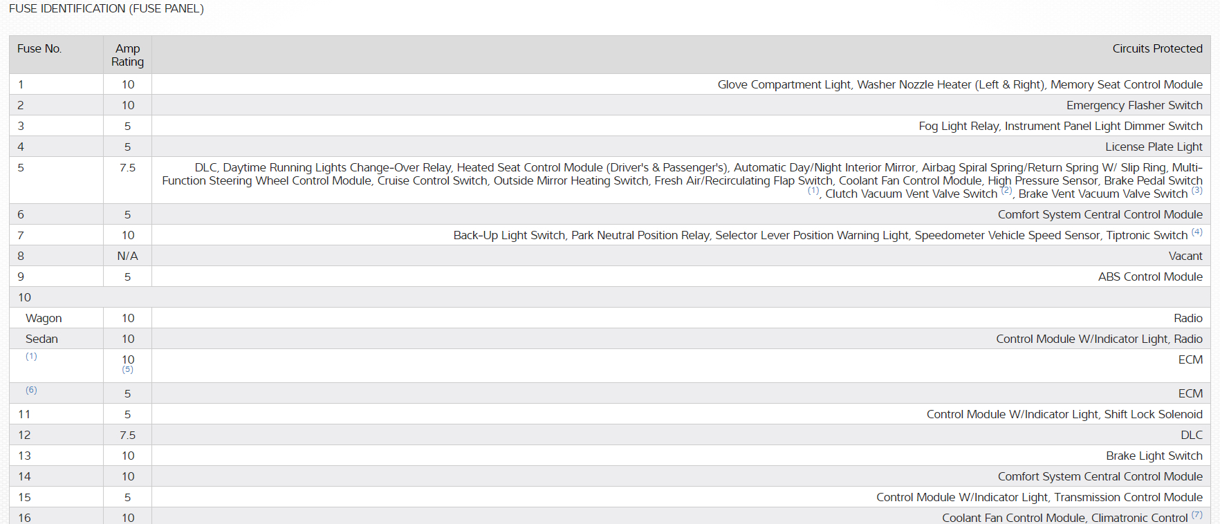

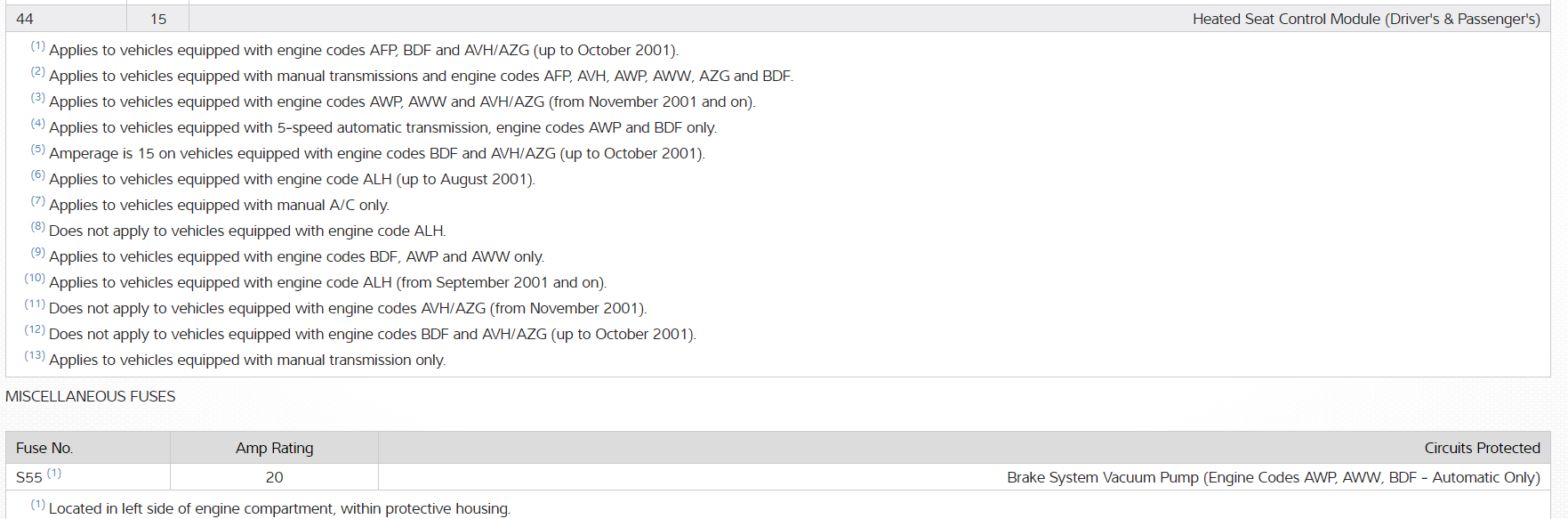

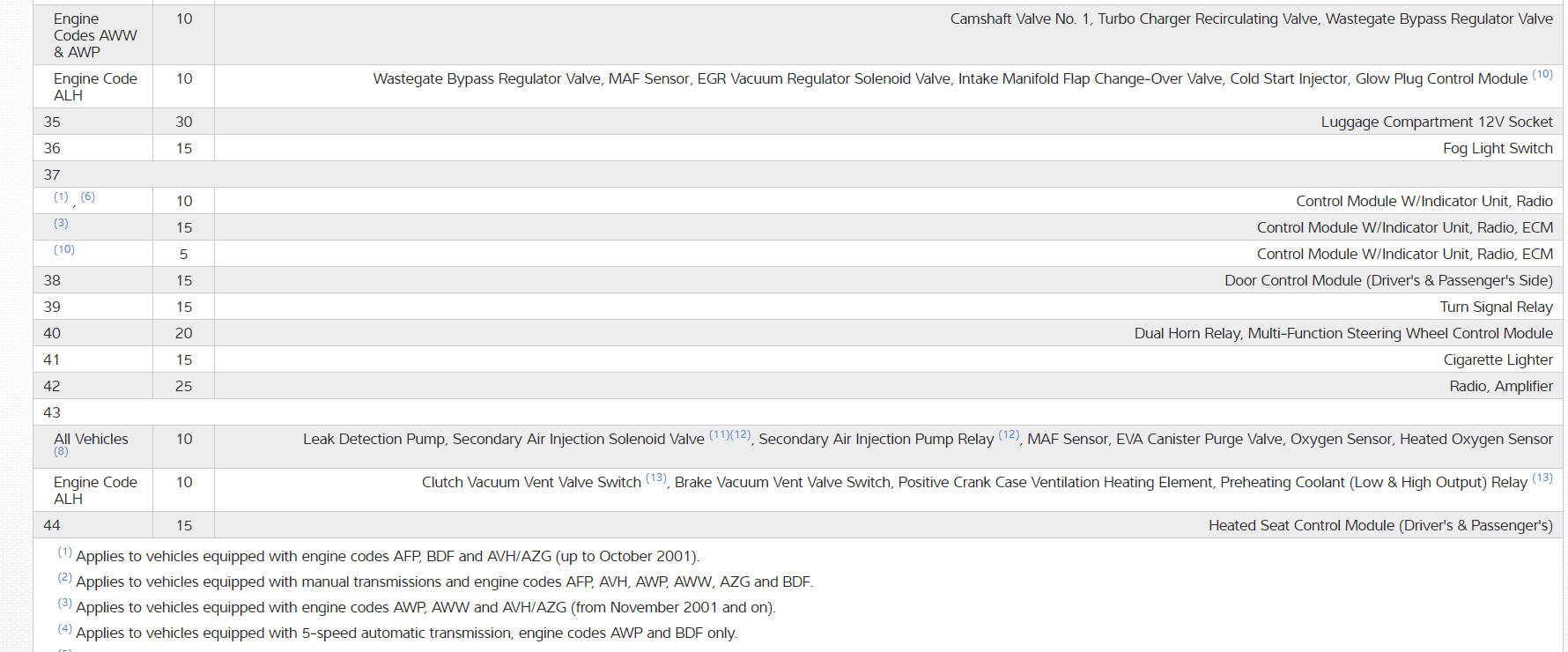

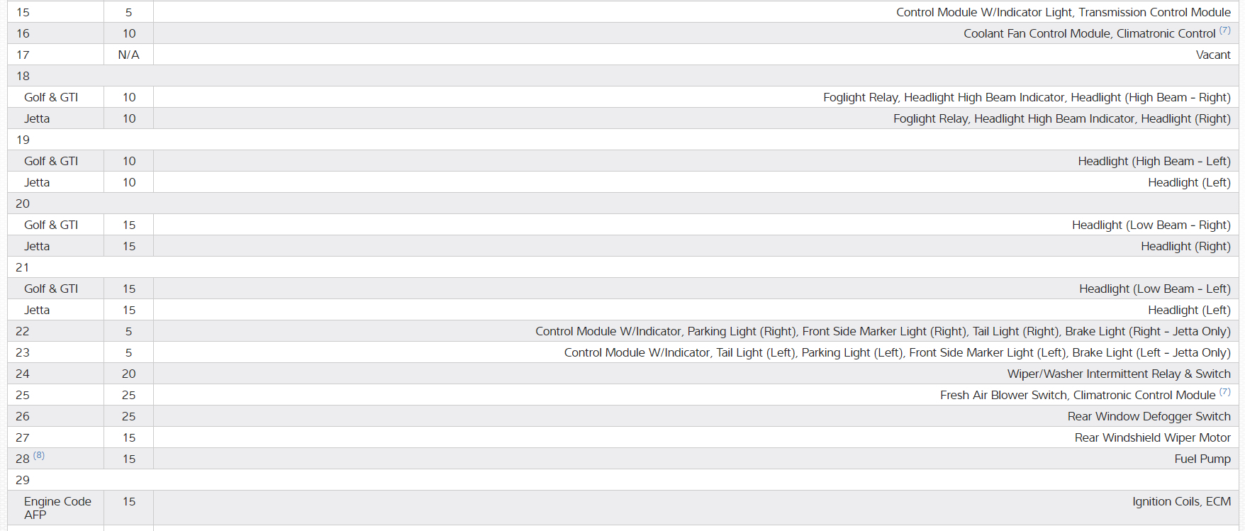

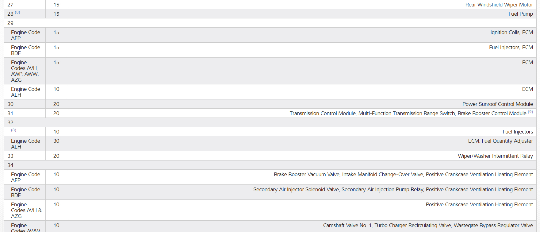

I have found these guides and diagram below that will help you check things out.
and
Diagram (Below)
Please let us know what happens so it will help others.

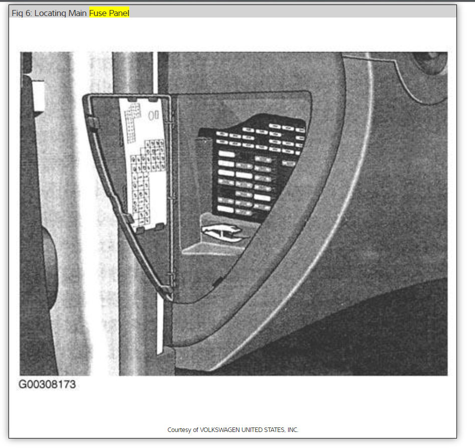

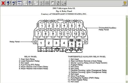

Your vehicle's fuel pump relay is located on the relay panel (under left side of dash). The fuse panel is behind the left side of dash, why are you needing to replace the entire fuse panel for? Do you mean just the fuel pump fuse?

Okay, as stated before the fuel pump relay is located under the left side of the dash. Will have to get underneath there and check it out to find it, just pull it from it's mounting location and disconnect electrical connector to replace. The fuse panel is behind the left side of the dash as well. first disconnect the battery for safety. Remove the fuse panel cover and disconnect all of the electrical connectors. Once connectors on disconnected just remove any bolt(s) holding the panel in place and then remove panel to replace.

where would the fuel pump relay be located on a 2001 VW jetta VR6?
Oct 13, 2017 at 4:25 PM (Merged)
  • 75,992 POSTS
Here you go
https://images.2carpros.com/forum/automotive_pictures/12900_fuel_pump_relay_volks_1.jpg
