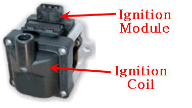

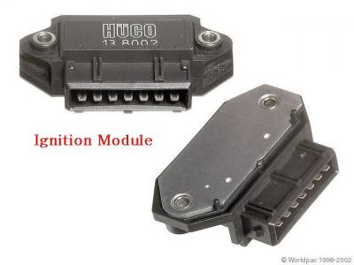

ESCOTTY77
  • 13 POSTS
Does this car have a separate ignition module?
Should it be on the firewall on the engine side or behind the dash. Or is it somewhere different?
I added a picture of one type of module for other to see. And I added a picture of the ignition coil that my car has.
I will change it next week if I can find it.

NO. My pic of the underhood electronics is of poor quality, I cant tell where the ign module is. Is the pic of the one your car calls for?

I added a new pic. This is the type of ignition coil and ignition module that is on my car. The ignition module is under the coil but it is part of the whole piece. It is not a separate module as in some other models.
For the car (Vento 2.0 GT 1992 4cyl) the part number from VW is: 6N0 905 104
The crank sensor part number from VW is: 051 905 381
As my ignition coil/module is new I will try replacing the crank sensor to see if that makes a difference? I have seen that over 90 people have looked at this topic. Is everyone experiencing similar problems? Anyone have any luck?

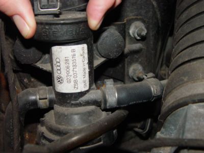

POWERPRORANGER
I am having a similar problem with a 97 VW Jetta. I suspected the engine control unit which is mounted to the coil as yours is. (The picture looks exactly like mine)
I believe I have traced the problem to the purge valve located near the air cleaner.
One forum I read online suggested problems could arise from changing fuel octane. I checked with the customer and he said he put premium fuel in the car a few days before the trouble occured.
That is where I am in the process. When I tap on the purge valve the car will start and run but it is rough. The car hesitates when I press the accelerator.

ESCOTTY77
  • 13 POSTS
I added a picture of the purge valve from my car. I took this picture so it is the actual one in my car at this time.
I have not changed it or looked at it yet but I will get around to it this week.
Powerproranger
Were the symptoms similar? Like 18 to 24 miles with no problem? And then continuous problems? Then when the engine is completely cold the same situation.

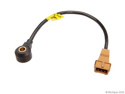

ESCOTTY77
  • 13 POSTS
Hi there.
The crank position sensor should be easy to find and replace. It is a sensor that is checking the teeth on a gear wheel to the side of the engine. As the crank is at the bottom of the engine you will probably have better luck looking under the care , just above the oil pan.
I have attached a picture of a common VW crank position sensor. I believe that my 1992 Vento 2.0 does not have this sensor. I have also been investigating the knock sensor. I attached a picture of it also ( the larger picture).

I am not a mechanic, I am just trying to to identify the potential issues. As my problem only occurs when the engine is hot I was thinking that it could have been the knock sensor as it is attached to the engine block.
After driving to work today I know that a new knock sensor did not solve the issue. I cleaned the throttle body and purge valve and did manage to drive 100 miles with no problems. Just when I was feeling good about the situation the problem came back.

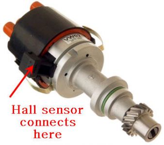

ESCOTTY77
  • 13 POSTS
I changed the distributor. The problem was not the rotor or distributor cap. The problem was that when the distributor got hot it was not always allowing the hall sensor to send a signal to the ignition coil to fire.
I changed the complete distributor including all the pieces such as:
1. Hall sensor
2. Rotor
3. Distributor cap
4. distributor body with seals, gears etc.
I changed everything you see in the picture.
When you buy the complete distributor the hall sensor should be in it.
I changed everything because it came as a complete unit. But you may be able to buy the distributor body separate or used.
My car runs like a new car.
I hope this helps all the people that have visited this post.
