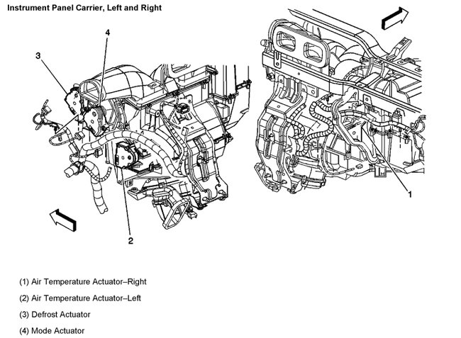

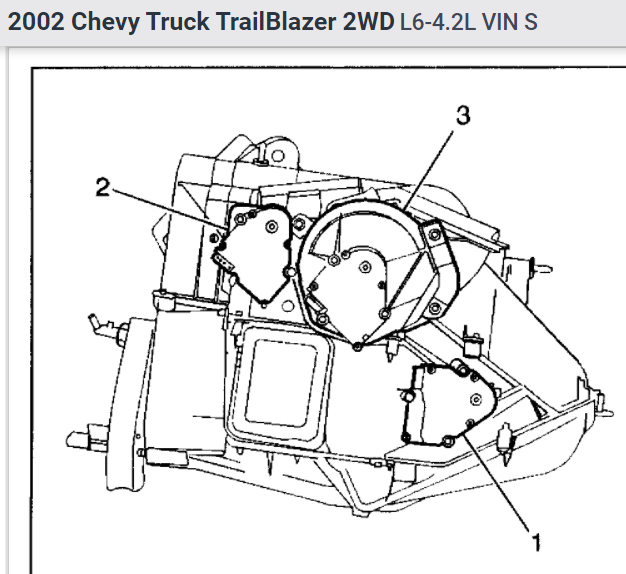

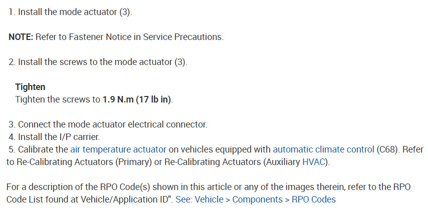

Only my defrosters and the floor vents push air. How do I know which actuator is the issue and are all the actuators the same?
-1
Friday, February 12th, 2021 AT 10:20 AM (Merged)
Got it.

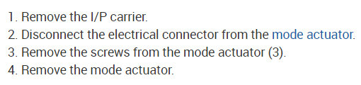

Below is the procedure and a picture is attached of the mode door actuator for air through the vents.
1. Remove the left side sound insulator screws.
2. Remove the left hand floor duct. Refer to Floor Air Outlet Duct Replacement - Left Side See: Air Duct > Procedures.
ImageOpen In New TabZoom/Print
3. Disconnect the electrical connector from the mode actuator.
4. Remove the screws from the mode actuator (1).
5. Remove the mode actuator.

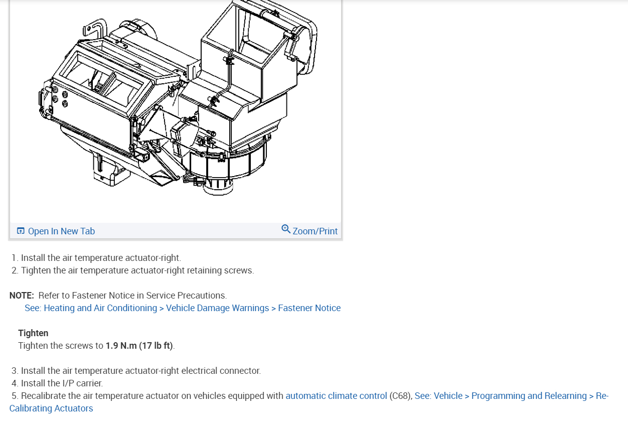

RICKDEW1961
  • 2002 CHEVROLET TRAILBLAZER
  • 4.2L
  • 6 CYL
  • 4WD
  • 180,000 MILES

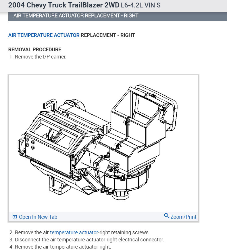

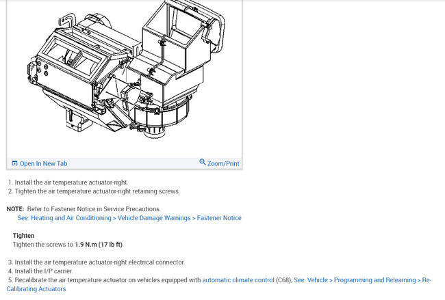

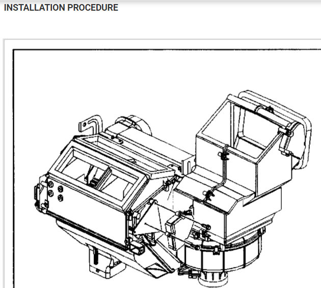

I need the location of the temperature blend door actuator on passenger side dual zone climate (electric). All cold in vents floor defrost. Vent on dash and rear when heat on 90 on passerger side. Drivers side is all hot like it should be. Please help it is winter. Thanks, Rick
Friday, February 12th, 2021 AT 10:21 AM (Merged)
HMAC300
  • 48,601 POSTS
Here is a guide that will show you how to change the actuator step buy step and the location of each blend door actuator with diagrams below to show you on your car.

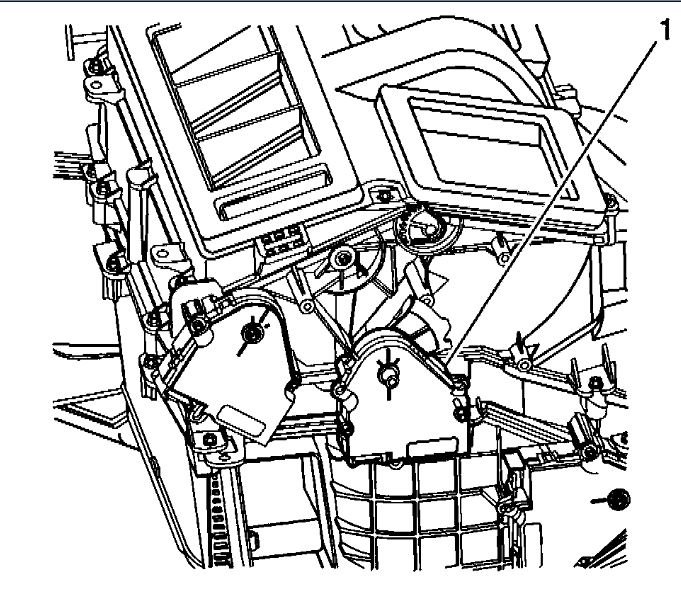

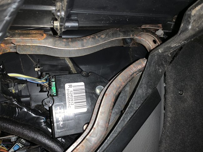

I know where actuator is, but how do I get it out with the frame bar blocking it?
Really need to turn it to heat with winter approaching.

SRMYER95
2004 trailblazer. Passenger side actuator not easily accessible with the frame bar in the way. Need to get heat going. Only blows cold air.
KEN L
  • MASTER CERTIFIED MECHANIC
  • 55,512 POSTS
That is rough, will the brase unbolt? This is how the book says to do the job but they don't mention the brace it must come out of there. Check out the diagrams (below). Please let us know what happens.

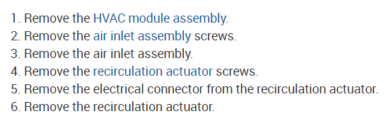

STEVIESTEES
  • 4.2L
  • 6 CYL
  • 2WD
  • 145,200 MILES

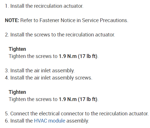

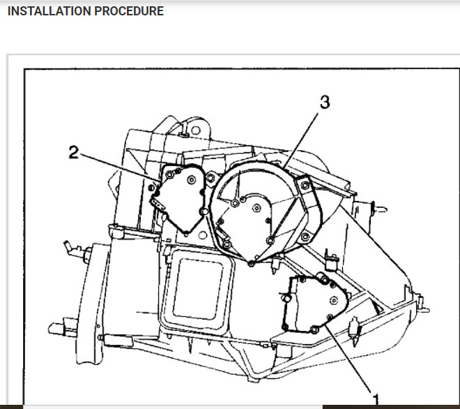

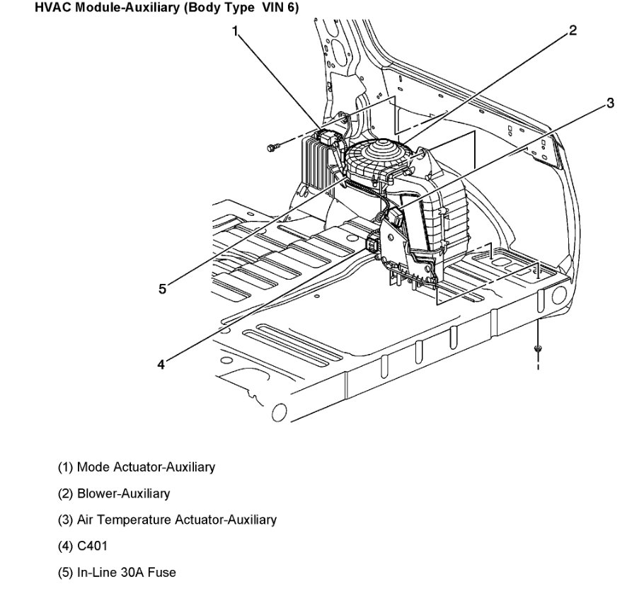

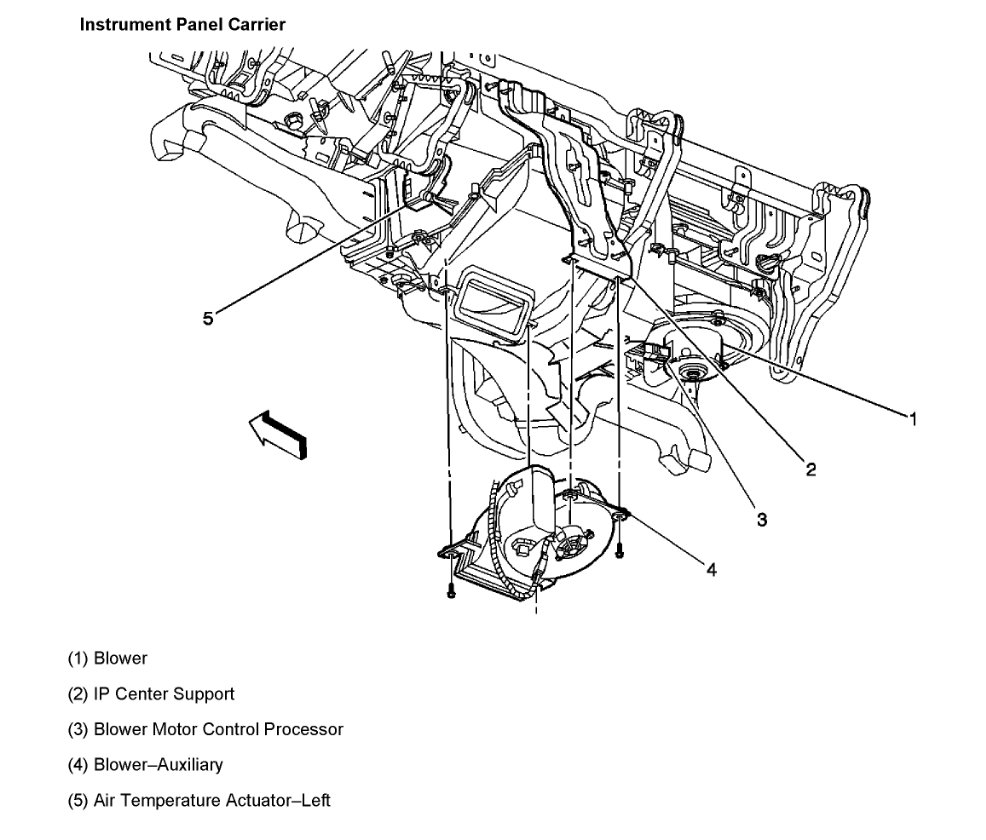

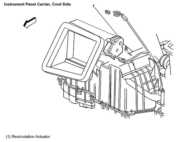

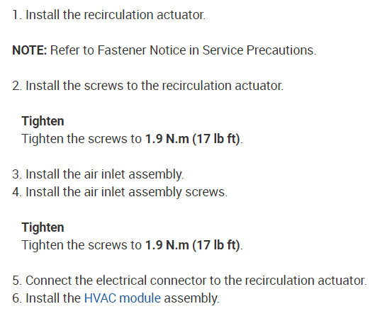

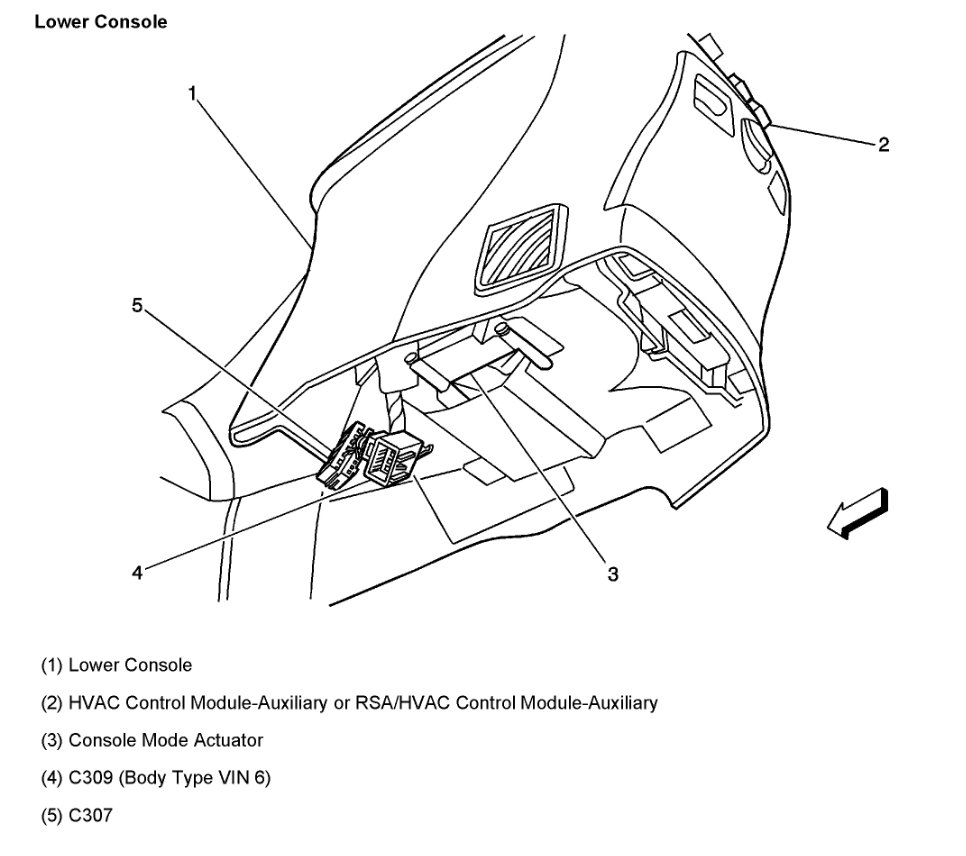

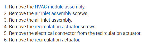

I've determined that the re-circulation actuator is faulty as with the glove box and lower dash cover panels removed you can look through and watch the "door" slowly fall open then the actuator struggle to close it once more before it gives way again. I will be ordering/replacing that actuator soon. My pickle here is; I got little to no flow out of my driver's side floor vents and the rear seat vents. It's an LS model with just the simple mode selector switch for the rear. When I set it to floor I have excellent flow on the front passenger floor only, vent comes out all front vents just fine but nothing comes out of rear vents or floor aside from a very weak flow. Also have air lightly leaking from front defrost. Should I replace another actuator in conjunction with the re-circulation one? Would the mode/blend actuator or defrost actuator cause the lack of airflow to driver's floor and rear of vehicle?
DANNY L
  • 5,648 POSTS
Hello, I'm Danny.
Yes, it sounds like you may be having an issue with the mode actuator. Before I attach repair guides is your HVAC system manual or an automatic controlled system? Let me know and we'll go from there. Hope this helps and thanks for using 2CarPros.
STEVIESTEES
Manual system.
DANNY L
  • 5,648 POSTS
Hello again.
Here is a quick tutorial for you to view on blend door actuator replacement:
I've attached picture steps below of both the blend door and re-circulation actuators for your vehicle below.Let me know if you have any further questions on this issue.Hope this helps and thanks again for using 2CarPros.
