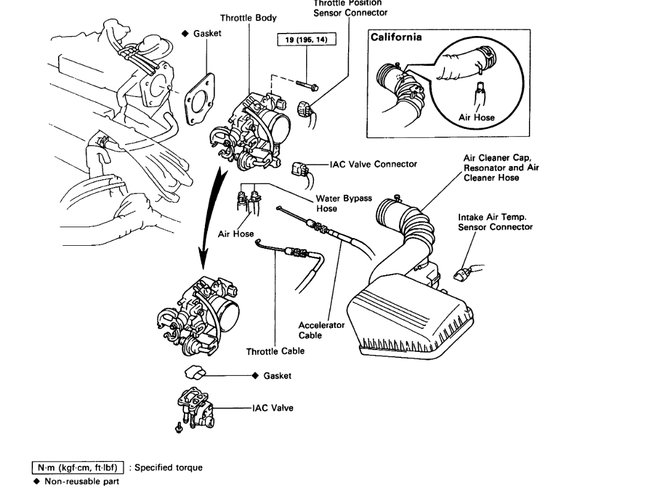

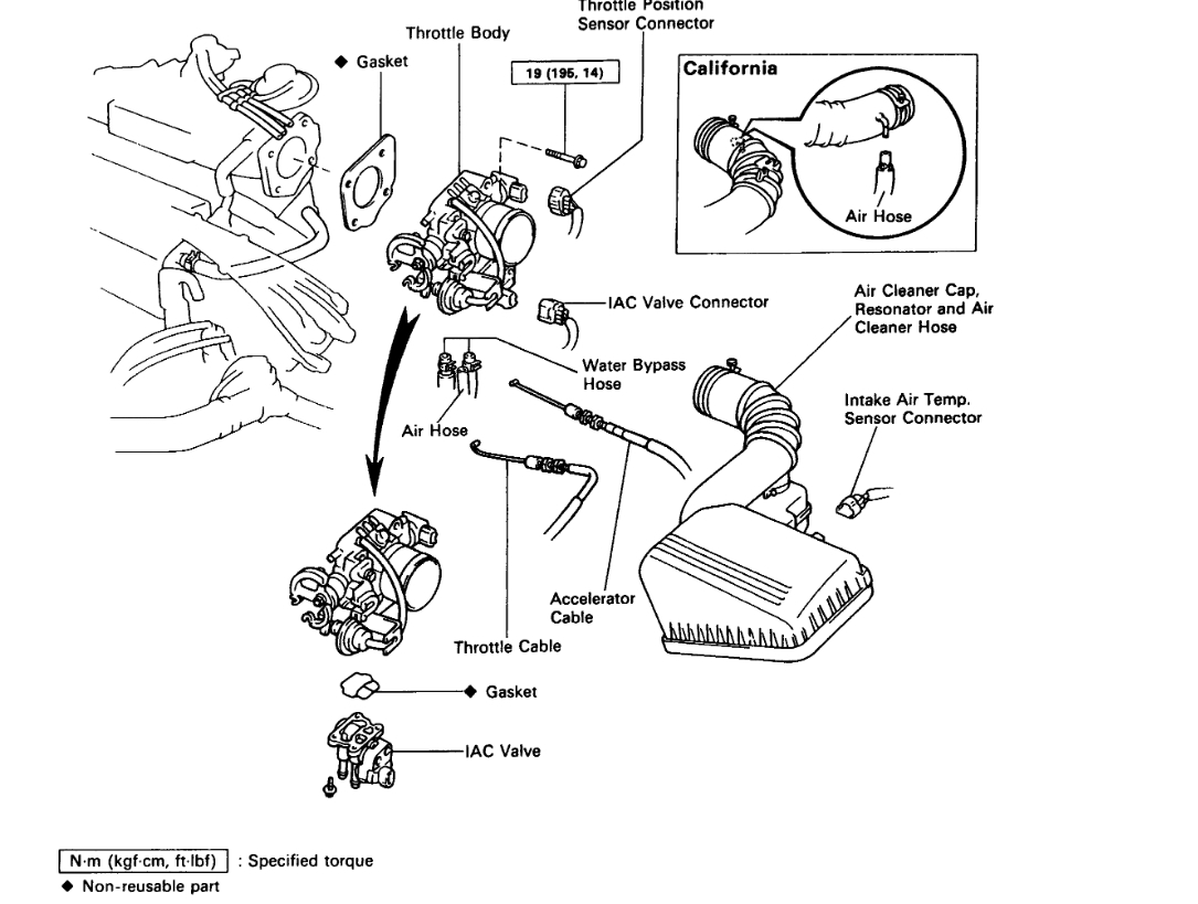

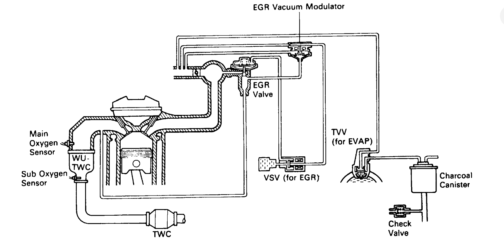

Okay, then it sounds like a vacuum leak, or the IAC valve needs to be serviced. here are to guides to help you, make sure the engine is cold before you do the vacuum leak test:
This is a generis guide to help you see how to do the job with diagrams below for your car:
https://www.2carpros.com/articles/idle-air-control-valve-service
Check out the diagrams (below). Please let us know what you find.

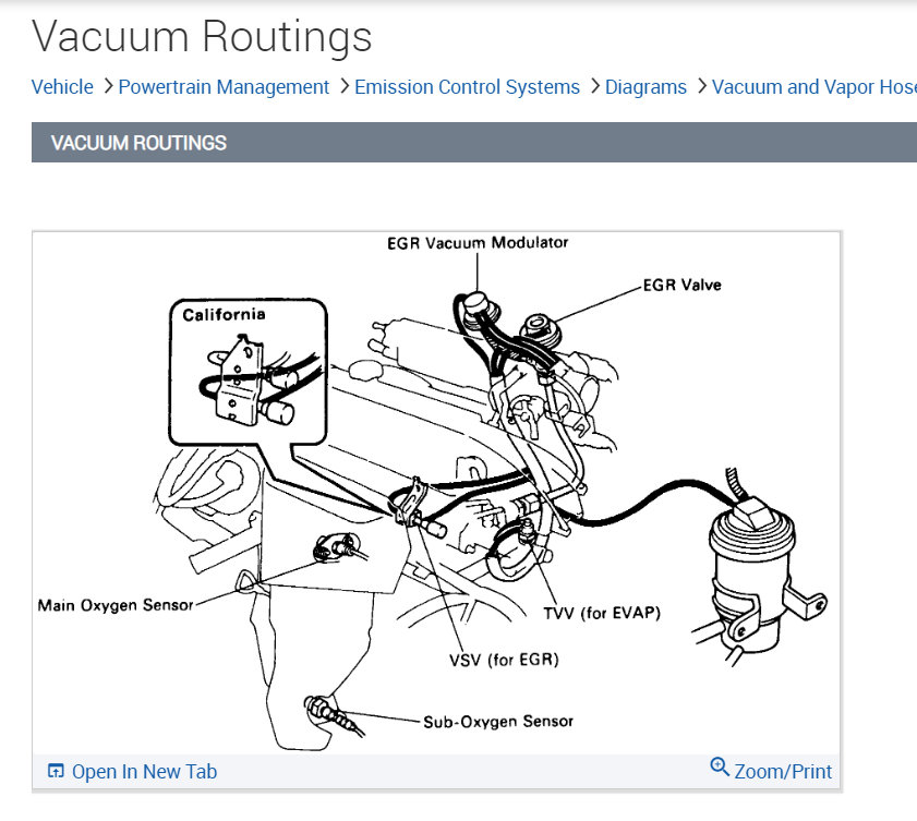

Okay, then it sounds like a vacuum leak. Please send me a clear picture of vacuum diagram for me to check if the vacuum hoses were properly routed including EGR and EVAP VSV.
For the IAC, I replaced throttle body when I noticed that the previous IAC Revs higher at idle and when you disconnect the IAC connector and it drops to normal. So let me check vacuum lines first. Thanks

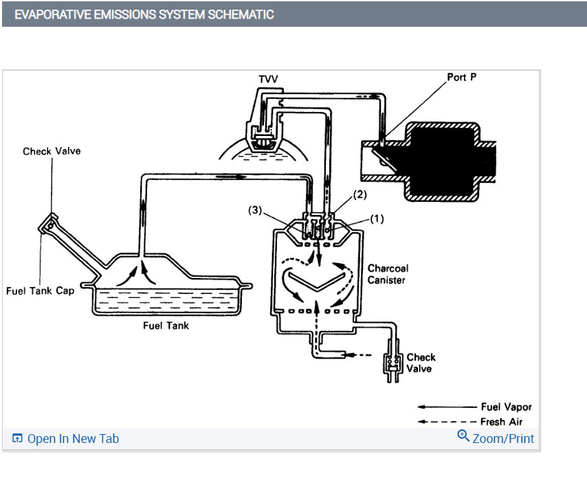

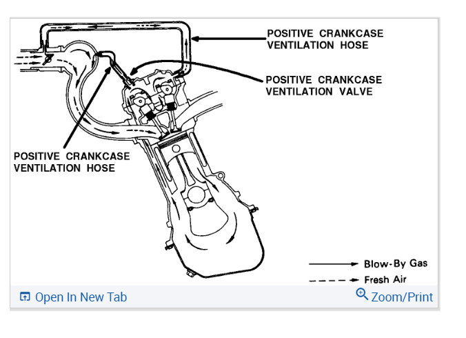

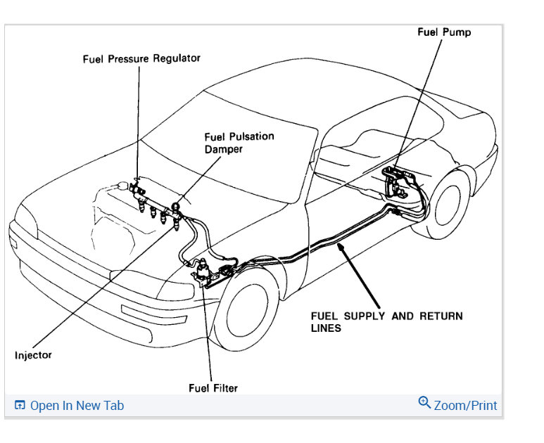

Here are the vacuum line diagrams AllData offers in the images below.
Friday, August 19th, 2022 AT 11:32 AM
MALLYBOY
  • 338 POSTS
I did not understand the routing of this diagram, I have all data, but I am not understanding it that's why I ask for picture not line-diagram.
Friday, August 19th, 2022 AT 12:09 PM
KEN L
  • MASTER CERTIFIED MECHANIC
  • 55,488 POSTS
This is what we have, I am not sure where to get an actual picture. Sorry we couldn't have been more help.
Saturday, August 20th, 2022 AT 4:14 PM
MALLYBOY
  • 338 POSTS
I have checked and noticed that EGR vacuum switching valve and pressure up vacuum switching valve are broken and there was no hose to them and I replaced them and routed the hoses to them. Then the higher idling at 3000rpm drops to 1,400 RPMs, then I loosen the stop-screw and the throttle plate fully close and the rpm drops to normal at 1000rpm and if you engage gear, it drops to 750rpm. I test-drive it and it didn't stall again only that sometimes on reverse if you throttle it, it will move backward and if you remove your leg from throttle pedal as to hold brake pedal, it will jerk as if it will stall and at this time the rpm drops below 750 and it will come to normal again. But on forward(drive)gear, you will not notice anything unlike before when the vacuum are bad.
