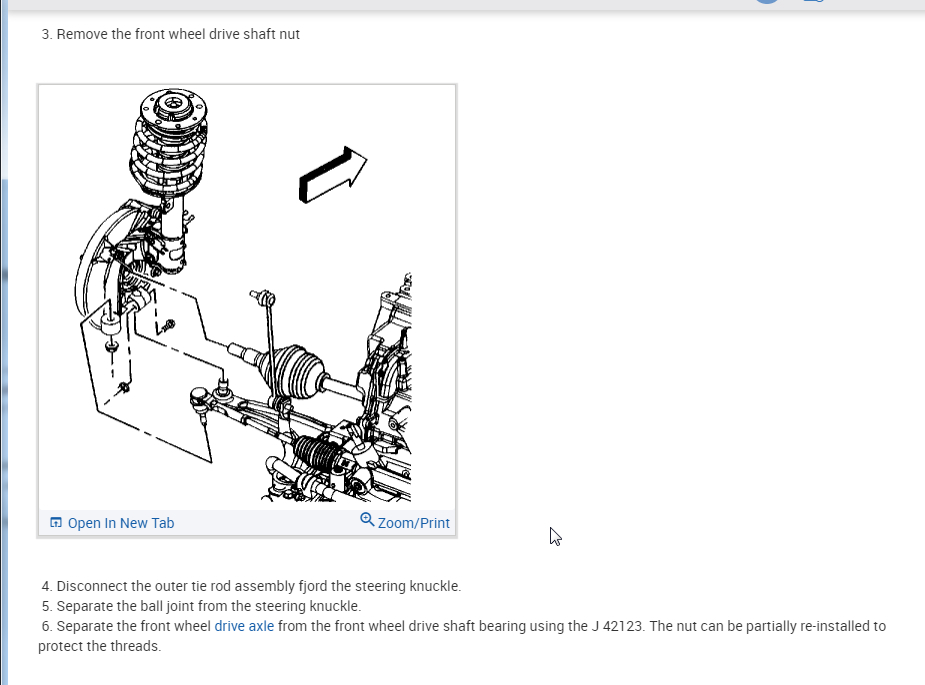

Great job narrowing that down. That is clearly clunking with the rotation of the axle shaft. If you watch the passenger axle shaft it wobbles and you can actually hear it has a double clunk. This means it is a second order vibration or noise. Second order means two anomalies in one rotation. If it were me, I would replace that axle shaft and go from there.
Tuesday, March 24th, 2020 AT 5:38 PM
SNOOK187
  • 13 POSTS

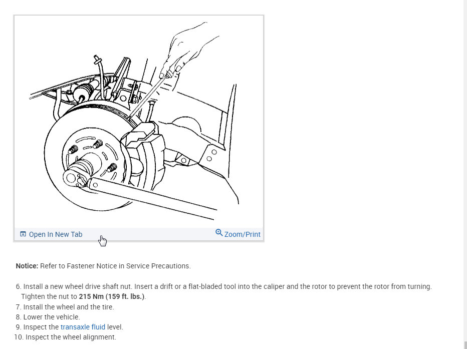

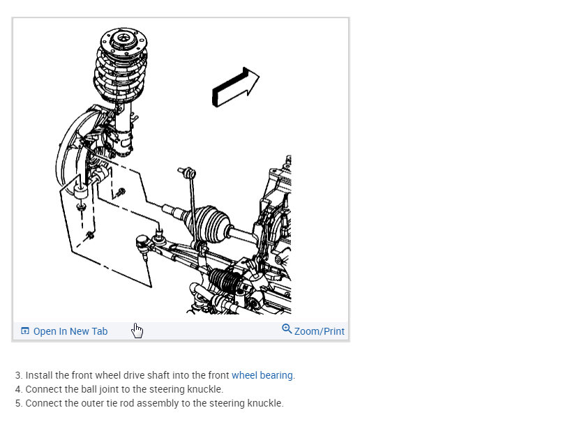

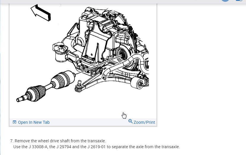

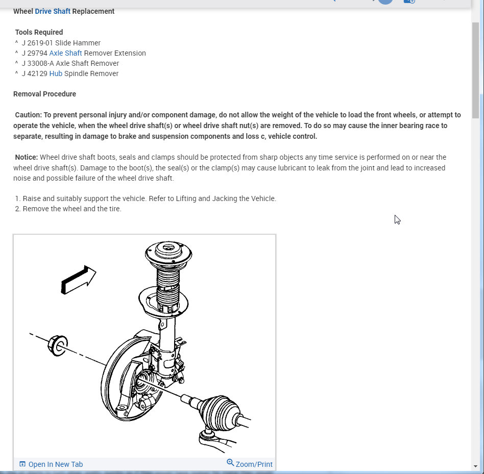

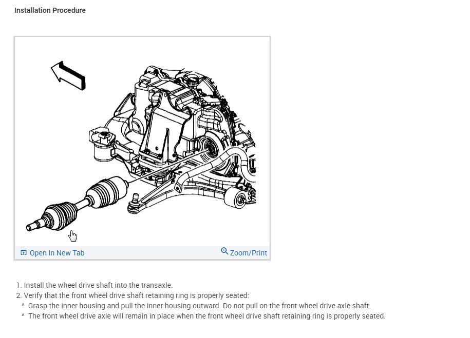

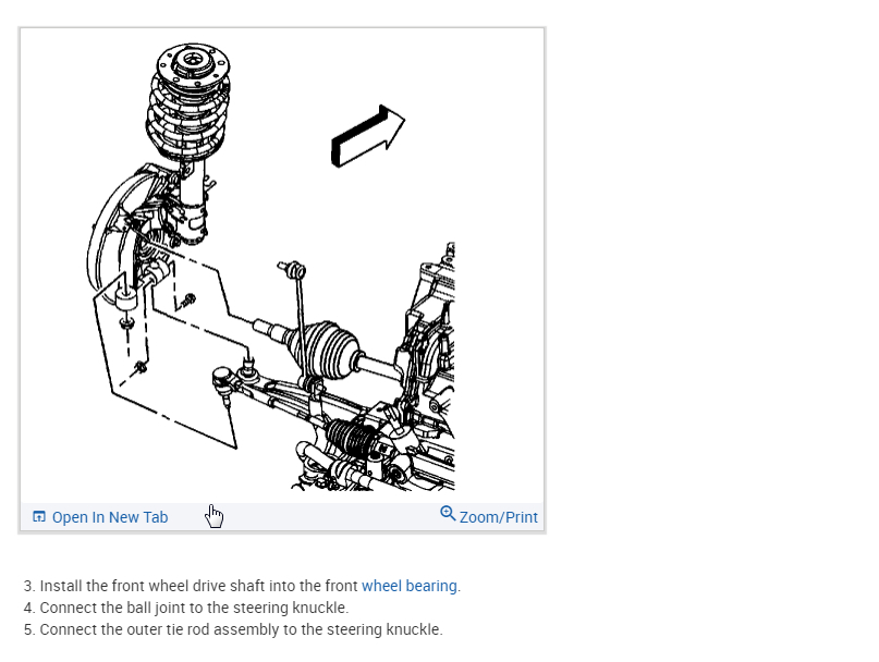

KASEKENNY1 suspected the axle the to be faulty so I bought new ones to put in after the video I uploaded earlier today. I swapped out the passenger side axle and replaced it with the new one, but the noise or the vibration did not go away. So I'm completely stumped.
Tuesday, March 24th, 2020 AT 5:54 PM

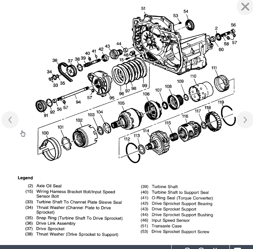

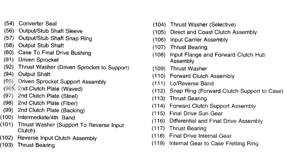

Bearings in the transmission normally make a growling noise but you must have an issue with the thrust bearing in the differential. If this is the issue it could be allowing the axle to walk like it is. I am surprised that was not the issue but if the axle is new then it is clearly inside the unit. There is no question that this axle is actually making the noise, it is just determining what is causing it to walk like it is and the only way to find that out is to remove the transmission and tear it down. This is not something you will want to do in your driveway. It can be done but is not fun at all.
