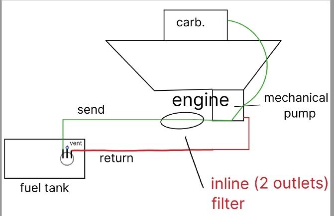

I think I'm having some vapor lock issues, and was wondering if you could help me with a fix? Truck runs great, but lately, as the temperatures have warmed up, if I sit in traffic, or idle for a few minutes, or stop and try to start the engine again, it will just shut off, sputter/choke like it's starved for fuel, or won't start unless I hold the pedal down for a bit. I've attached a diagram of the current fuel system setup. I'm planning on getting a heat sleeve for the fuel line, but anything else I need/should do?

First, I assume this is a C-20. Is that correct? Also, have you had any issues in the past when it was warm outside? Is the fuel line set up the same as it was from the factory?
If that is the case, the heat sleeve is a great idea anywhere the fuel line is near excessive heat such as an exhaust manifold. However, I want you to try something. When it doesn't start, see if it will if you use starting fluid. If it does and then stalls, then we know it is a fuel-related issue. If there is no change, then it is likely ignition related and not a vapor lock issue.

Yes, it is a C20, and yes, the fuel system should be factory set up again after my rebuild. Only thing missing is the second fuel tank/selector switch, which I've bypassed, going directly from the sending unit to the fuel pump, with an inline filter in-between.

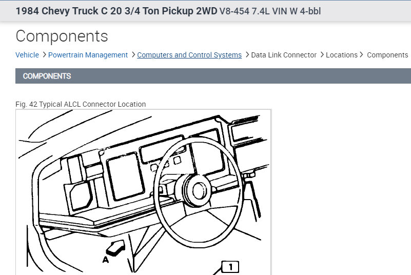

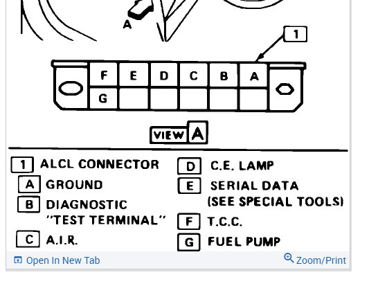

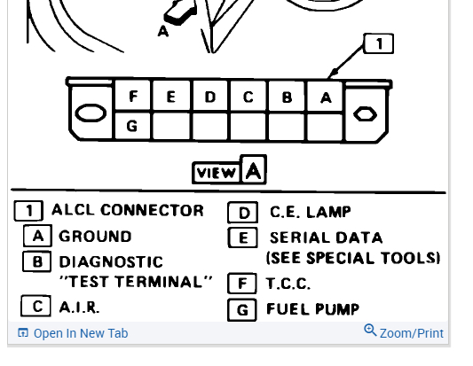

It should be below the steering column. I attached a pic below showing the location or at least where it should be.
Let me know if it's there.
Tuesday, May 23rd, 2023 AT 8:44 PM

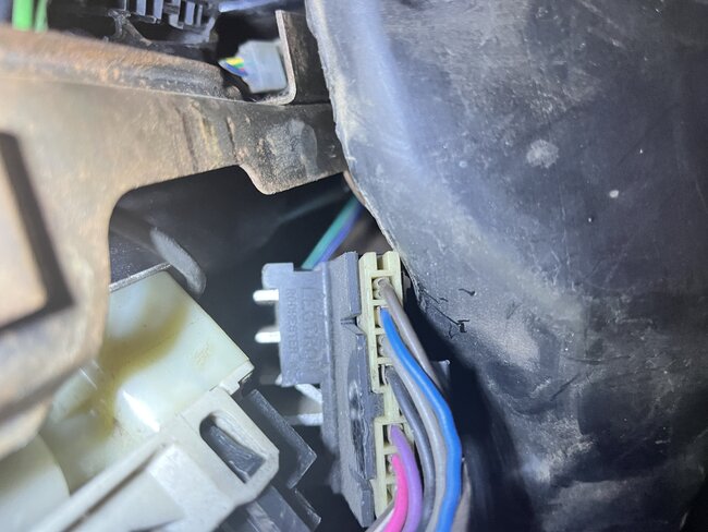

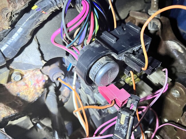

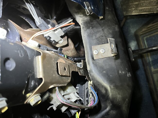

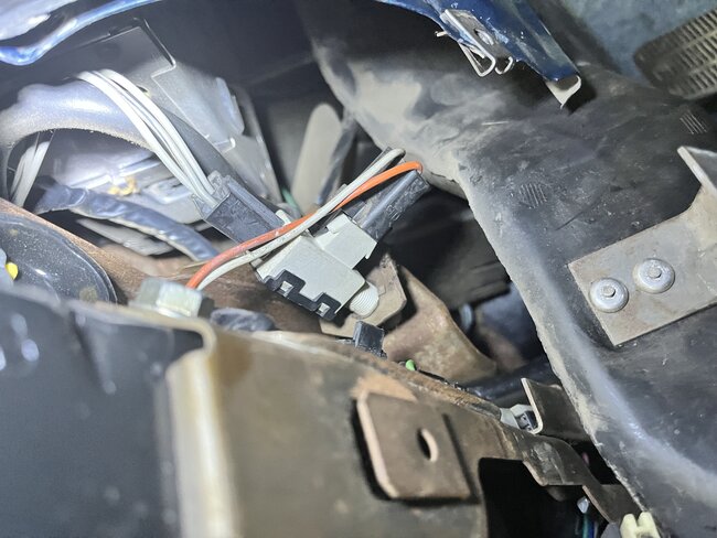

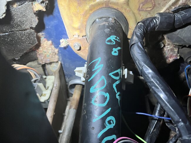

Sorry Joe, no luck. Attached are what I see underneath.
Wednesday, May 24th, 2023 AT 9:06 AM
  • 110,192 POSTS
On some of these, they placed it on the passenger side. Did you check there as well? Also, if you are still experiencing the issue, do me a favor. When it stalls and doesn't want to restart, see if it starts if you use starting fluid. If it does and stalls, the problem is related to the fuel system. If there is no change, check for spark at the plugs.
