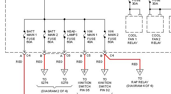

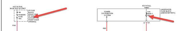

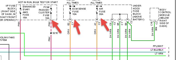

Did you scan for codes? Fuel pressure should 52-59psi chec elec eng andfuel inj fuses in fuse box. Also check ignition relay may not be working. If not these then it must be scanned and can be a fuse box problem or corroded relays it also may be the pcm connection has a problem.

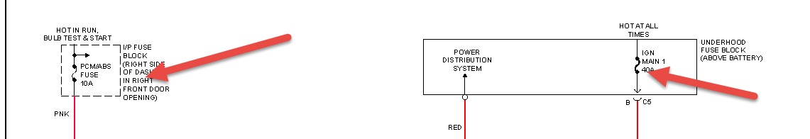

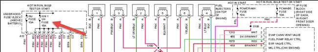

See pics also elek ign fuse in underhood fuse block. Use a test light so you don't pull fuses out lot easier and faster. Also what is fuel pressure?
