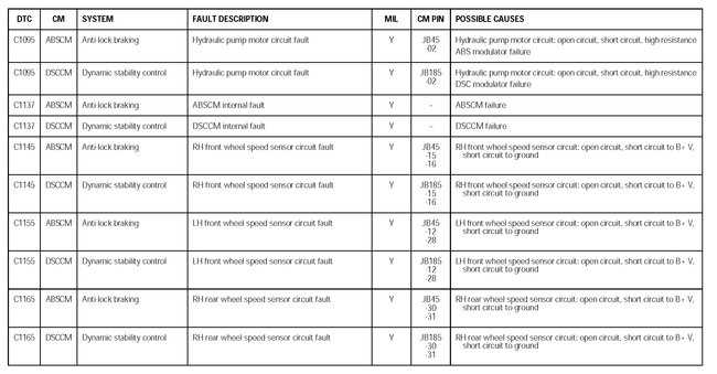

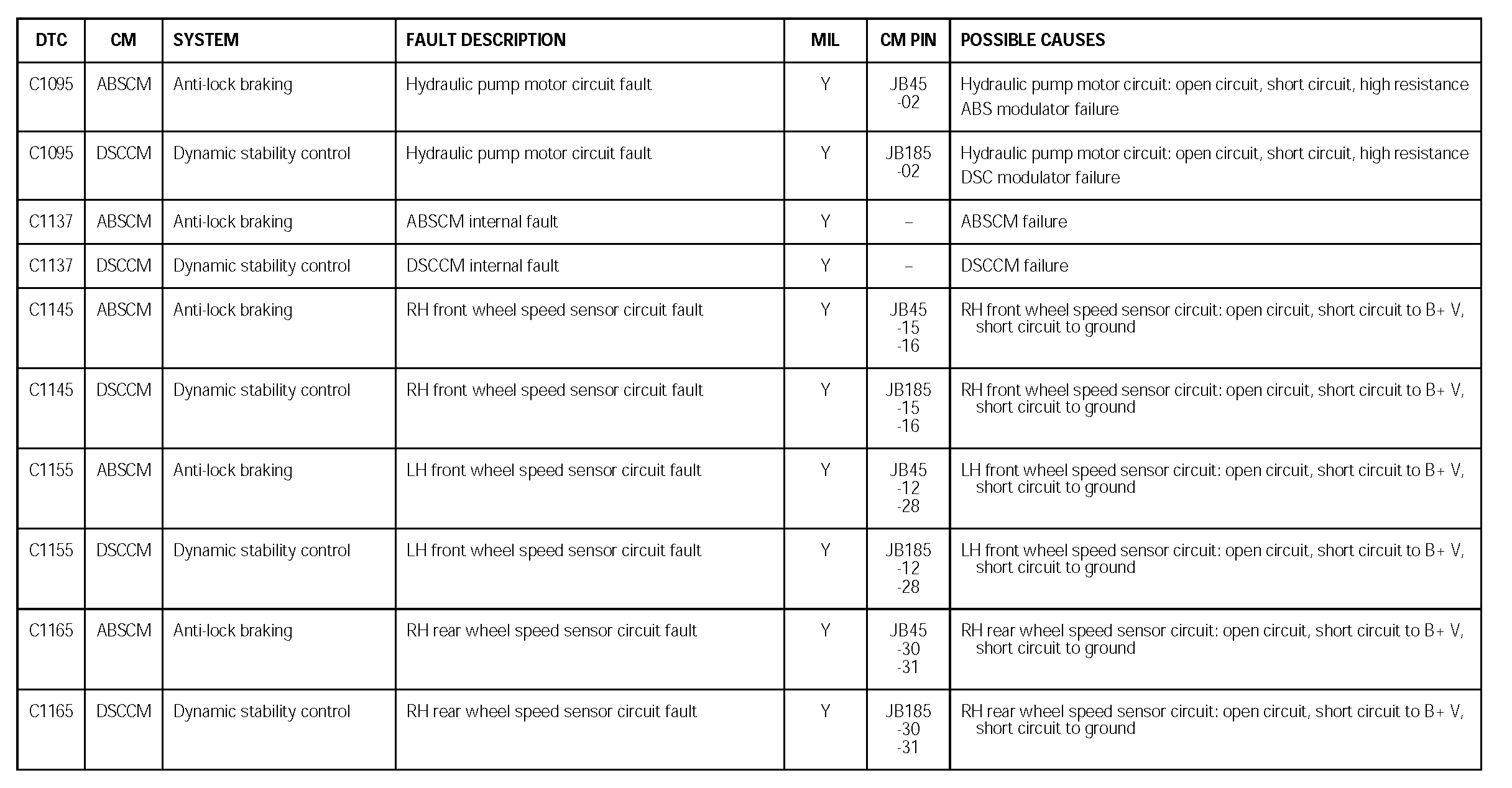

Hi guys, hope all is well. I am still having a problem I have a code C1155 which is the left front wheel speed sensor. I change that. The light went out for about 120 miles then it came back on and stayed on. Then I change the harness nothing happened light still on. I drove two minutes and it came back on and I continue to drive for on 80 miles, light still on. Second problem I hear a whining noise on the right side of the engine when I press on the gas. I am thinking it may have something to do with the AC. Can you help me guys? I surely appreciate it thank you, Kenny

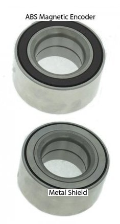

The speed sensor issue sounds like a bad magnetic encoder on the wheel bearing itself. They can crack and cause codes. The only good way to see that damage on those style units is to connect an oscilloscope or a very good graphing multi-meter to the sensor at the hub and then rotate the wheel and watch for the signal to change in shape. A common voltmeter is not going to read the break because it is a very small change and only for an instant.

They are fairly common on that bearing design, they are also somewhat fragile. You need to be as careful as baking a souffle when installing them. Also be careful to install the bearing the correct direction, if you install it with the shield toward the sensor, you get to do it twice. However I would try to test it first. Even a cheap single channel scope will work if you wanted to DIY. A scan tool is somewhat useless as it would not show the break either.

Hey Steve, thank you. It tested out the bearings magnetic so I ordered some I will put them on this weekend. I hope I can get a sticker after this that is the only code I had. But when I first began I had about six codes then I change the coils the plugs the valve cover gaskets the manifold gasket upper and lower clean all the electrical connections change the breather hose which had a big split in the bottom of it change most of the radiator hoses. Then all the codes went away except to C1155. So I should be good. I will keep you informed.

Just be careful about the direction and installing the bearing, no hammer use on install, just the correct bearing tools, that encoder ring is real easy to damage.

Hey Steve, I am so sad right now after replacing both of the bearings went out drove the car this morning both codes came on c1155 and C 1156 both wheel sensors. Before I only had one c1155 I was told when you change wheel sensors or anything electrical you have to reset/reboot the system is that so and if so how do I do it. I am thinking the guy put the bearings in backwards but it did not look like he did. I do not understand why both codes would come up. Help, need your advice. Thank you, Kenny

Well, that is not good. You should not need to reset anything as long as the sensors are correct and the bearings are in the correct direction. I do not see a C1156 just the 1155. But it still says it is a wiring/sensor issue. About the only thing to do would be to connect a scan tool and watch the speeds reported to the system. All four corners should match. If you have three that say you are driving at 30 and one says zero then there is something wrong.
