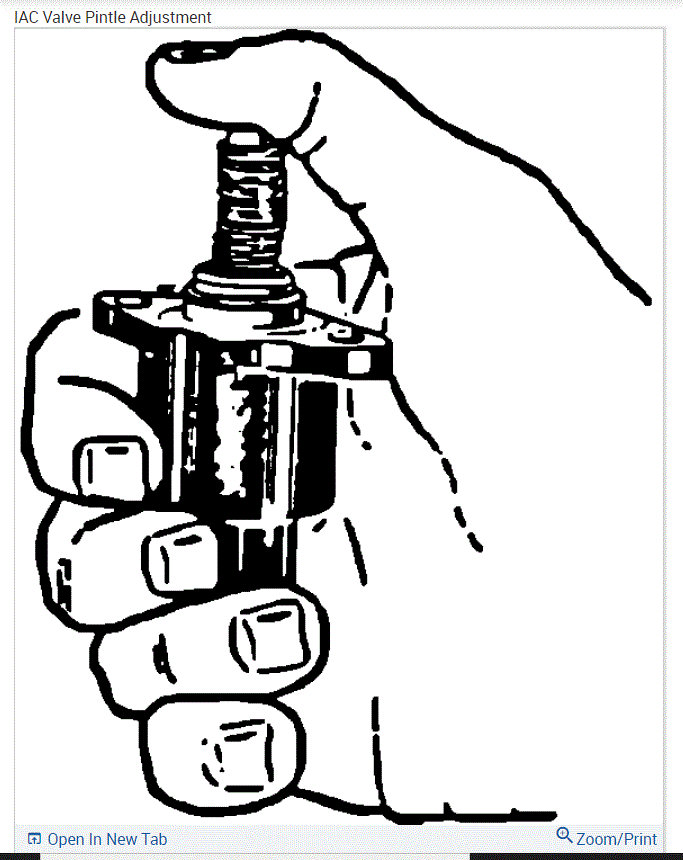

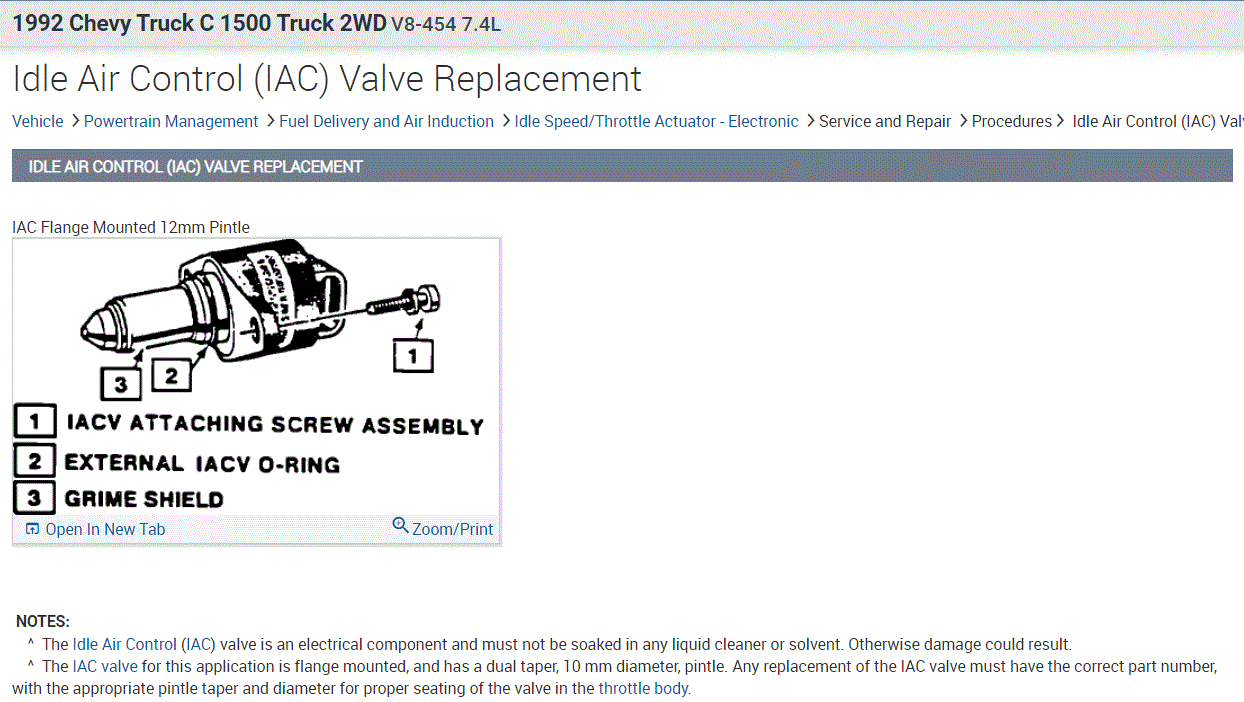

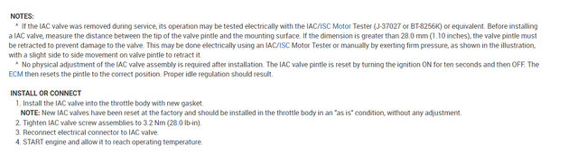

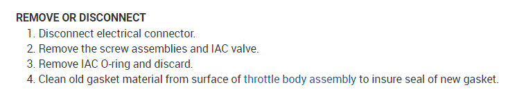

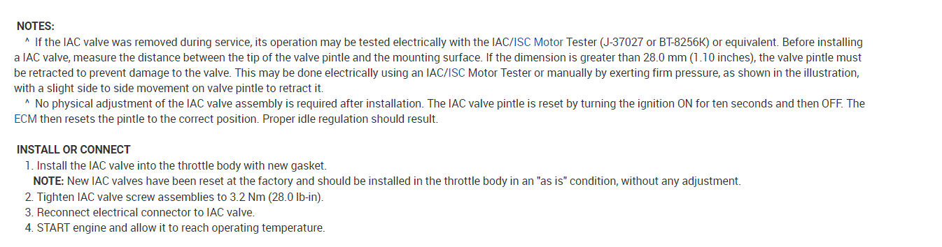

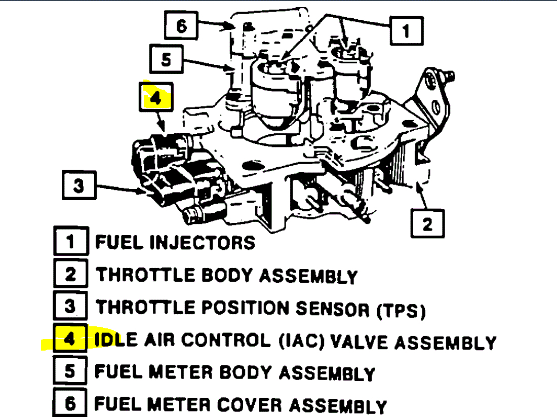

What you described sounds related to a faulty idle air control valve (IAC). All engine idle speeds are controlled by the control module through the Idle Air Control (IAC) valve mounted on the throttle body. Oftentimes, looping (up and down idle) is a symptom.
What I suggest is this: Remove the IAC and check for carbon or dirt where it enters the throttle body. Also, with it removed, have a helper cycle the key from off to on. You should see movement (slight) in the pintle.
Here are a couple of links you may find helpful:
https://www.2carpros.com/articles/idle-air-control-valve-service
https://www.2carpros.com/articles/how-to-replace-an-idle-speed-control-motor-iac
If you look at the attachments below, the first pic shows the location of the IAC. The remaining pictures are the directions for replacement specific to your vehicle.

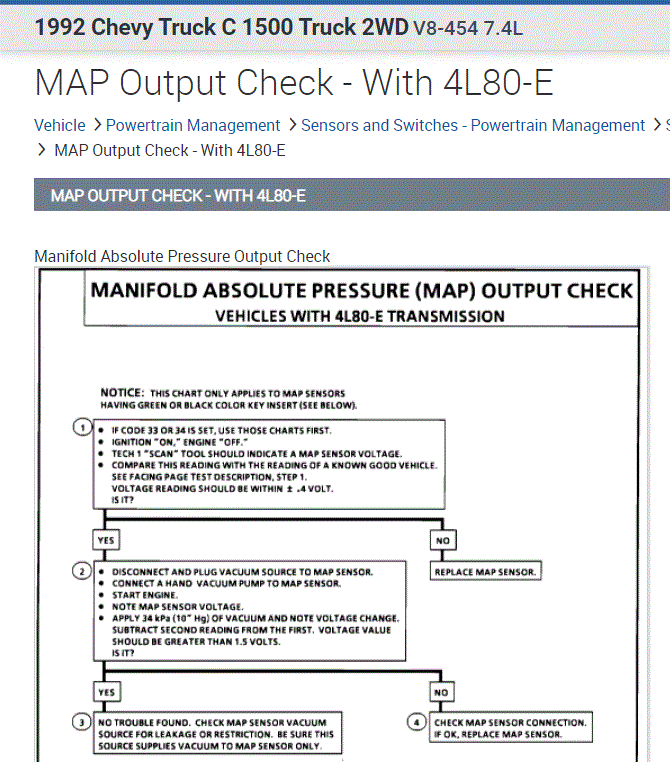

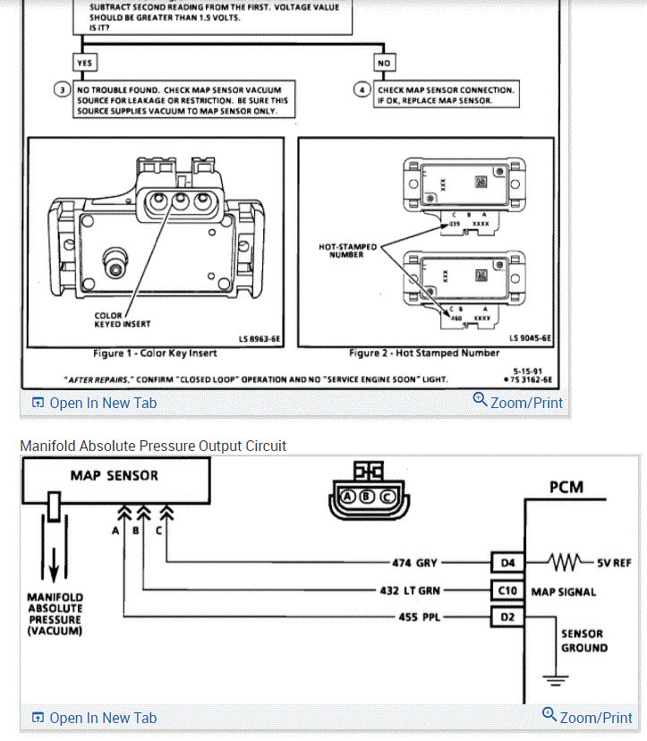

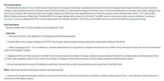

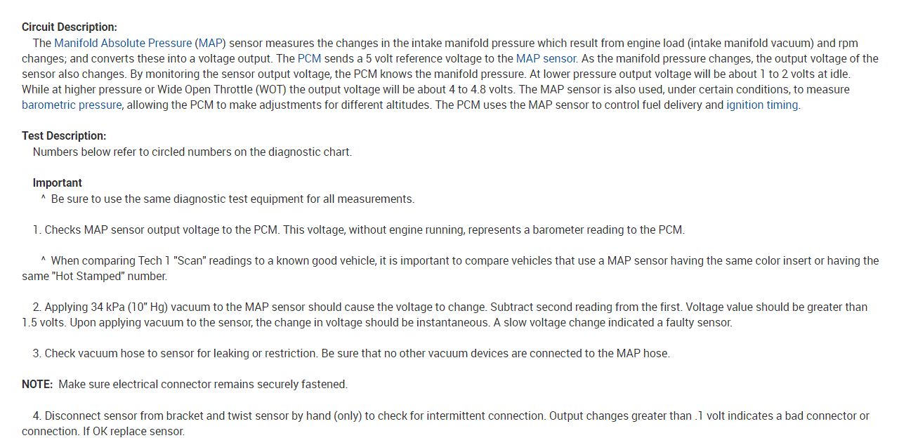

If you unplug the electric to the MAP, pull the vacuum hose off (engine running). Is there a good strong vacuum?
I have a feeling it is tied into the map circuit. I attached the diagnostics below for testing the MAP circuit. Let me know if you have already done this.

Okay, my vacuum pump handle is broken so I couldn't do that test. But here is what I have:
These are on the Map - Purple wire, key on not running -12.05v (checking ground) on the white wire 5.07v - on the green wire 1.84 v. I started the truck and checked voltage on green wire. Keep in mind the idle is surging. It was between 1.3 v and.284. I unplugged the vacuum line from the sensor and put a vacuum gauge on it. It was idling sooth at about 1400 rpm and 23hg of vacuum.
Monday, May 10th, 2021 AT 7:34 AM
  • 110,194 POSTS
I have to be honest. The reason it surges is likely because of the voltage variation in the signal from the sensor. Did the 5v reference from the PCM change?
If it didn't, my first suspect is you got another bad MAP sensor. The vacuum is excellent. The only thing we aren't sure of is if the sensor holds a vacuum. Since the sensor signal goes crazy when you plug vacuum to the sensor seems to indicate the sensor.

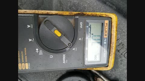

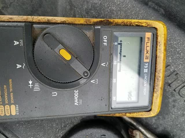

Okay, installed the new replacement MAP sensor. Problem is still present. Little or no change. I will try to attach a video of my meter connected to the output wire on the sensor. I checked the reference wire and it was still stable at 5.07 V. This new sensor is going from "open lead" to about 2.4 v as it surges.
Tuesday, May 11th, 2021 AT 4:48 PM
  • 110,194 POSTS
The OL is indicating infinite resistance. Are you sure there isn't a faulty wire or connection?

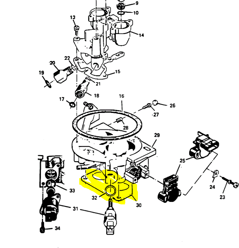

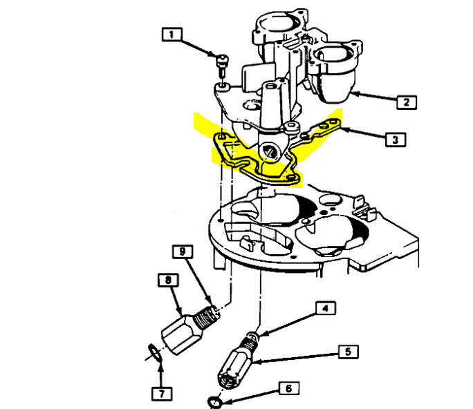

Things sound normal (other than idle). I spoke with a GM tech and the owner of the site regarding this. Both told me that the TB gasket needs to be inspected because a vacuum leak may not show up.
It's a thought. For both of them to say the same thing leads me to believe there is a possible issue.
I attached a pic below of the gasket I'm referring to.
See pic below.

I did replace the gasket on the throttle body. No change, I'm going to do the intake gaskets today. I will report back. A vacuum leak makes sense of everything we are seeing.

That sounds like a plan. One other thing I just thought of. Have you checked the gasket at the base of the fuel metering body? If that is leaking, it could cause a lean mixture as well.
See pic below.
