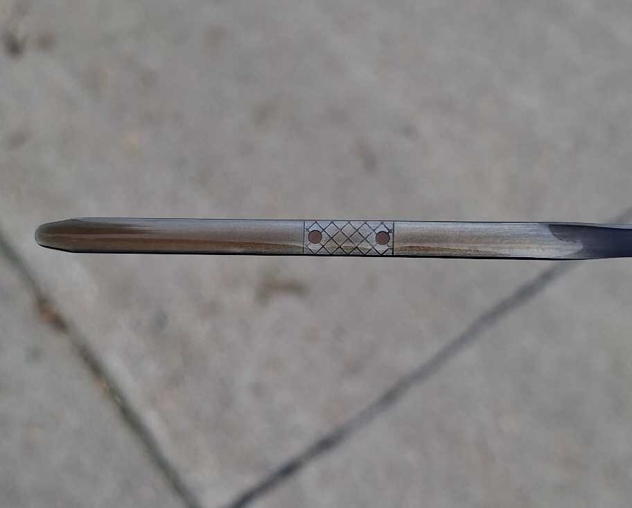

Okay I took a picture of the transmission fluid on the stick again I really appreciate it guys thanks. Sorry it keeps telling me the file type is not supported from my phone I'll try to convert it sorry about this.

Is this with the engine running with the car on flat ground? If so the unit is overfull.
Aug 29, 2025 at 4:20 PM
CANNON1349
  • 861 POSTS
Like Ken mentioned, the vehicle should be running in Park on a level surface. In any case this fluid has a reddish hue to it, and I would declare this to be good and able to be serviced. Only dropping the pan and inspecting the magnet will give a clear view of what is going on.

Yep it needs to be in the the cross hach marks also when checking it keep the stick vertical it shouldn't be sideways because the fluid will run upward on the stick
