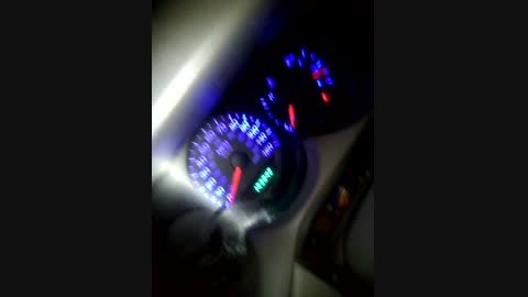

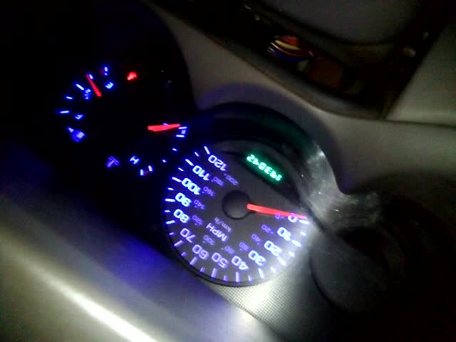

Well it shows here. Lol I a'm stumped. I have completely changed my transmission.

You mean the loud growl/chatter that show up around halfway through the video correct?
Does it happen all the time or only if you are hard on the throttle? Does it get better/worse while turning?
I take it this was happening before you replaced the transmission? What else did you replace? Either axle?
It almost sounds like brake chatter or a bad CV joint.

No after the transmission was replaced and I have replaced my brake pads and checked my CV axle and joint both good only thing us my control are is a a little worn would that cause it and no it only happens every other time if I drive it normal on over drive but if I go from first to third overdrive it does not to it and if it is grinding and I step on it gets worse until about forty then disappears.
