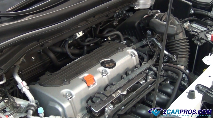

Begin with the vehicle on flat ground engine off and in park with the emergency brake on. Wear protective eyewear and gloves. You will need to use a floor jack and jack stands to raise the car for the inspection and service. Start by checking under the hood to inspect coolant hoses, engine wiring, intake boot and tube, battery, vacuum line routing and the serpentine belt for any abnormal wear. Also look for any fluid leaks and try to pinpoint their source and report the problem to the dealership for repairs.

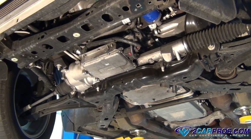

Inspect under the vehicle to observe suspension components, driveline and universal joints while checking for excessive wear or torn lubrication boots. Also, inspect for "rust dust" on any frame member, universal joints, sway bars, locating arms, strut rod mounting bolts and any other main frame or suspension components. This rust colored dust is created from metal on metal contact and is an indication that a component is experiencing abnormal wear or is loose. Use a floor jack and jack stands to raise the car and look underneath. Many defects can exist on a new car such as missing or loose bolts on engine mounting brackets and suspension parts such as sway bars and strut mounts, also wiring harness routing failure and engine, transmission or differential leaks.

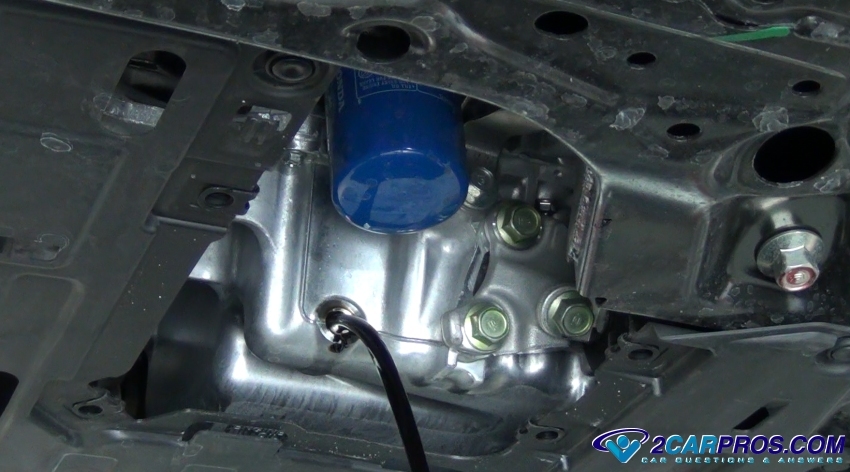

An engine oil and filter change is mandatory at every service interval. This engine maintenance is the most vital of all car services. We recommend performing your own oil changes to ensure the correct oil filter and motor oil is installed.

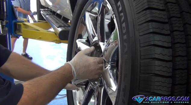

You can do your own tire rotating by removing the tires and using a floor jack and stands to raise and the front and rear of the car at the same time. This is because the tires should be rotated from front to back on each side. Never rotate tires from side to side. A tire rotation is needed to ensure proper tread wear patterns which protect the tire from early replacement costs. We do not recommend jacking up one side of the car. A tire rotation can also be done by a local tire or repair shop. Some cars have different size tires front to rear in which case the tires cannot be rotated.

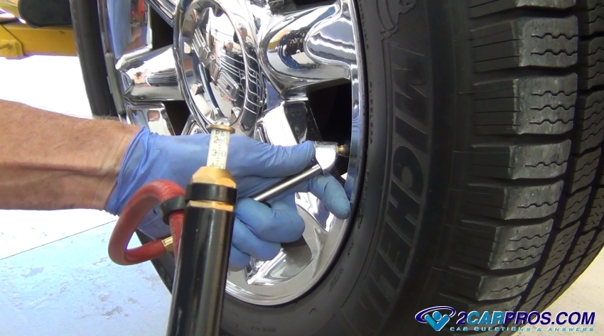

Tire pressure can sometimes be problem when it comes to getting your new car from the dealer. This is because the manufacturer typically delivers the car with the tire air pressure a little low which helps the car ride smoother. The downside of this is decreased fuel economy and increased tire and vehicle wear. Check the side of the tire which will tell you the max pressure the tire should be inflated too which is what we recommend you run your tires at.
