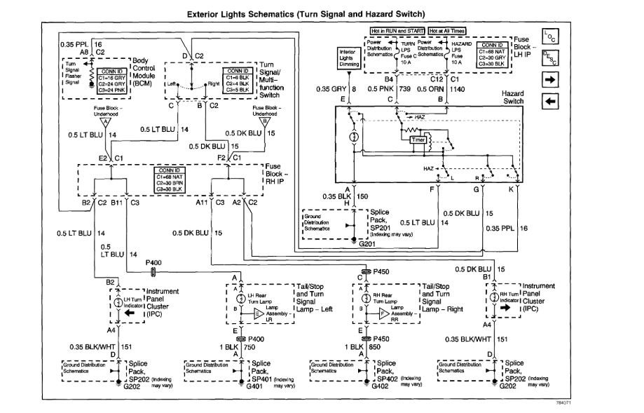

The hazard lights work, the high beams work, but when I turn the signal switch left or right they do not light up. I already changed the fuses and still the same result, the lights all still work and I do not know what to do.
Tuesday, November 6th, 2018 AT 9:07 AM
Good afternoon.
The first thing I would do is use a test light to verify power at the fuses for the turn signals. I attached a diagram for you to view and the fuses are marked.
The turn signals go through the four way flasher as well as the BCM.
