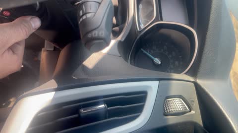

so i am working on a buddies focus and the car starts sometimes and wont start other times.... when u turn the key with the car in neutral and the clutch to the floor some days the cluster lights up and the car starts with a blip of the key and some days the cluster wont light up and wont crank at alllllll but everything else works such as AC and the windscreen wipers... on the days it do start i have been driving and the cluster will just completely die and shut off but the car will stay running and drivable.. ive checked fuse 69 from what people say passengers will kick it since its under the glove box and can damage it but that's not the case it seems ive read that it could also be a cluster issue itself or a fault in the ignition please helppppp

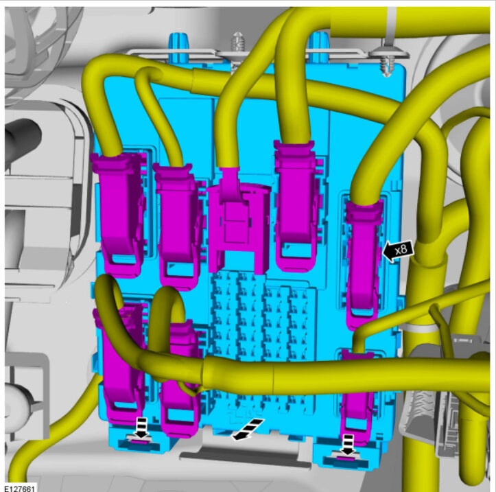

I have seen the BCM go out in these cars which can cause the problem, but also, I would disconnect the battery and remove the electrical connector from the BCM to check for correction which can cause the issue as well. The BCM is on the lower right side of the dash and can get wet to cause the issue. Please upload a short video in your response of the problem, so I can see what's going on. Check out the images (below).

So so sorry for such a late response life hit and some stuff happened but we back, I tried to run my scanner and no power to OBD 2 port no power to cluster when turn key can hear ac and windshield wipers turn on even with jumper pack on battery no power to obd port

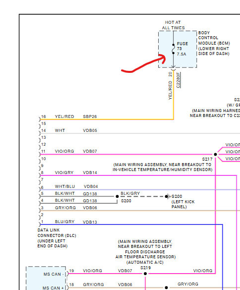

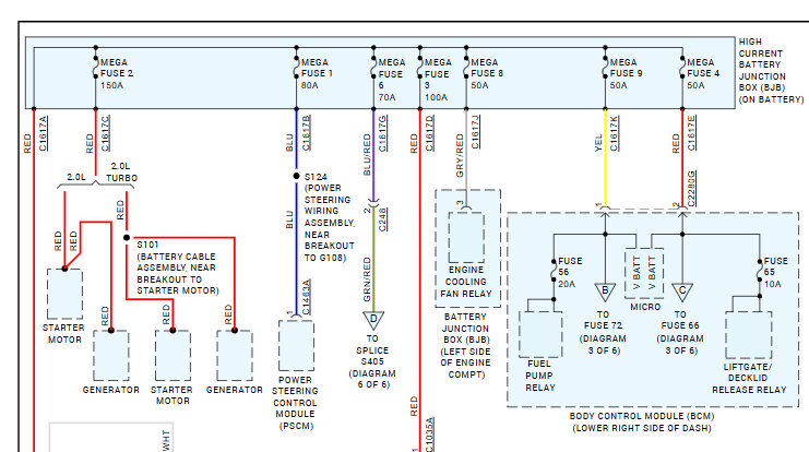

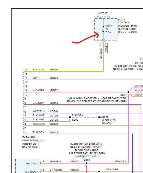

No worries, glad to see you back. So with the key on I would check the fuses and fusible links for power, here are the fuses to check and a guide to help you check the fuses for power on both side.
The fuse for the data port is fuse #73 on the BCM so check that as well. Also, check the main battery for 12 volts. If the voltage is low the car will act strange.

See if you have power at fuse #73? Also, check the blk/wht wires and the data port connector to see if they have ground. This guide can help.
Please go over this guide and get back to us.
