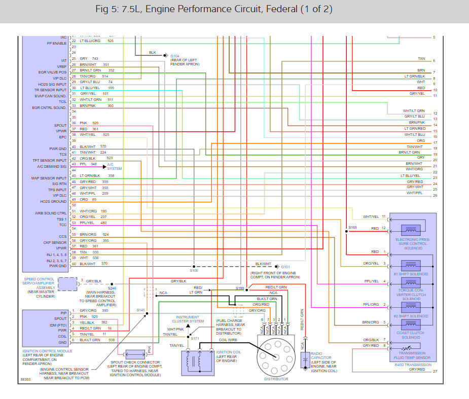

Not sure how else to test the spark I don't want to keep buying new parts if there not bad could it possibly be something to do with the icm not sending enough power or something I checked continuity on all my grounds and the other wires for all the parts on the ignition system do you know where I could find a diagram of the ignition system with a distributor all the diagrams and stuff have to be for the 1997 Ford f250 HD 4x4 with the 460 5.7 L gas with dual gas tanks I guess it makes a big difference when looking for stuff for the regular 250 as opposed to the 250 heavy duty which is HD they are different I guess and maybe some wiring diagrams so I can make sure all the wires are in the correct places and I read some places that it should have a crank sensor but then other places says that it don't so I'm not sure which one is right and unless it's hidden pretty good or in a completely different location I'm not really seeing it.

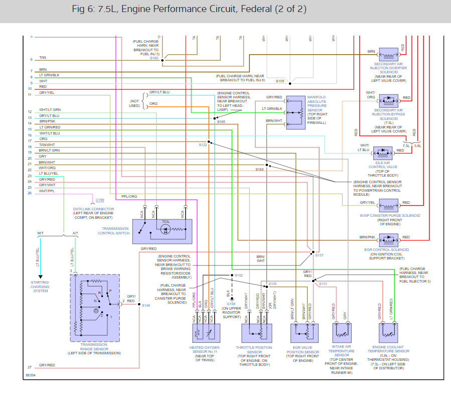

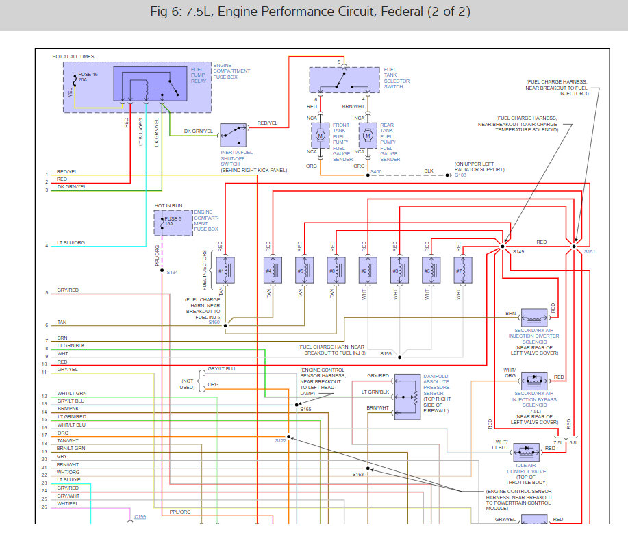

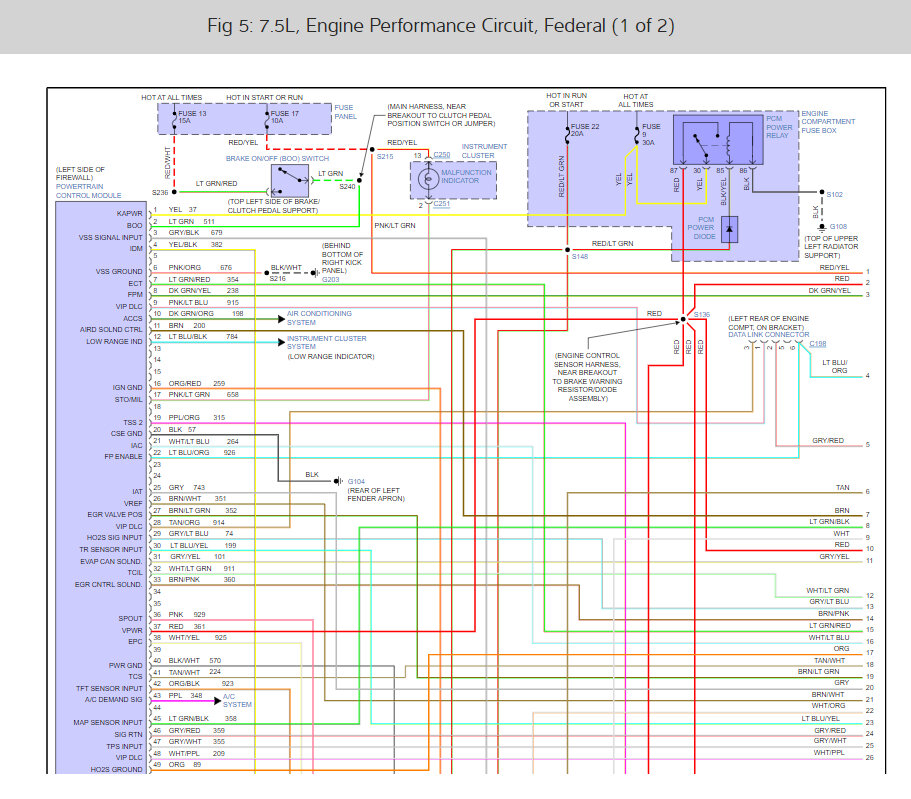

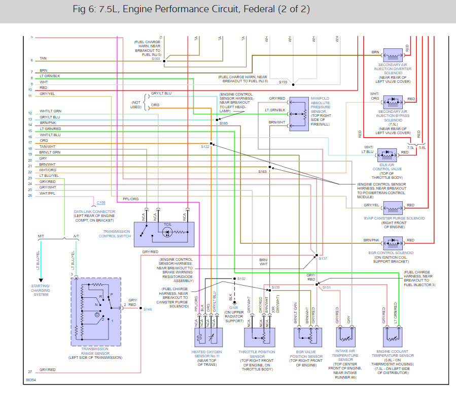

I don't think the reverse and brake lights are wiring to the ignition system, here are the wiring diagrams for the truck listed. This guide can help you with the testing:
