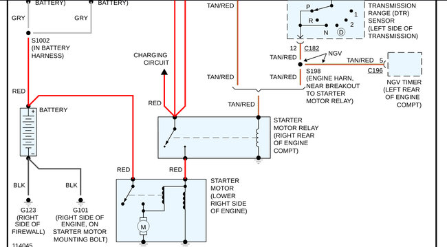

The battery is good. No electric to the starter. No lights. They wont work.
Tuesday, November 26th, 2019 AT 12:14 PM
SCGRANTURISMO
  • 4,897 POSTS

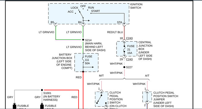

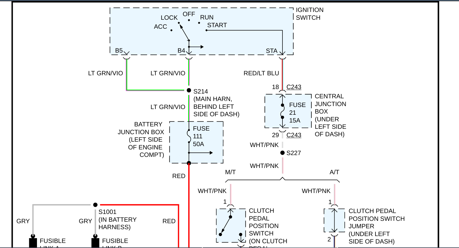

This could be a problem with your vehicle's fusible links A and B near the vehicle battery. In the diagrams down below I have included the wiring guide for your vehicle's starting circuit for reference. Please inspect the fusible links and get back to us with what you are able to find out.
Thanks,
Alex
