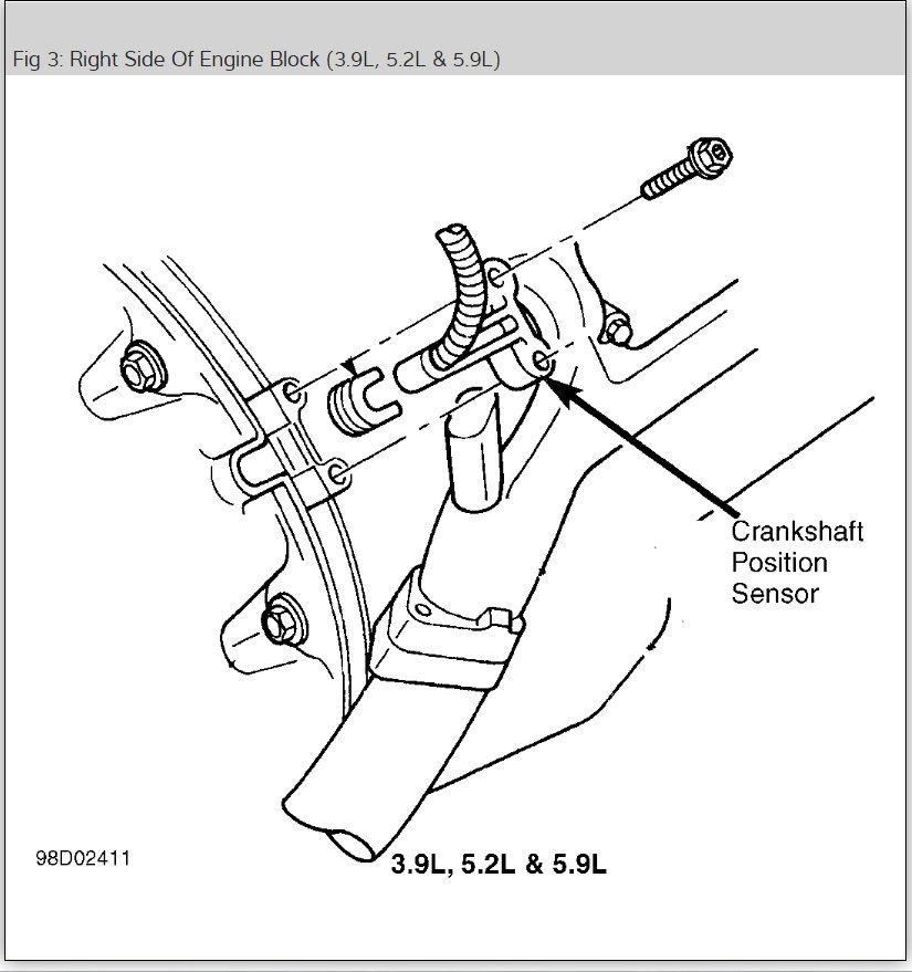

Brand new battery, truck will crank when ignition switch is turned on. It won't start, and when I stop the engine will act like it was trying to start but then shuts off.
when turning the key to the on position, I do hear the fuel pump motor kicking on for a few seconds so it isn't that.
Not sure when the last time the sparkplugs were replaced.

It sounds to me like you could having a problem with your Crankshaft Position Sensor. Here are a couple links that you might find helpful:
https://www.2carpros.com/articles/how-a-crank-shaft-angle-sensor-works
I have also included this location diagram down below to help you locate it on your vehicle.

Lets check for spark. Here are two guides to help as well:
and
