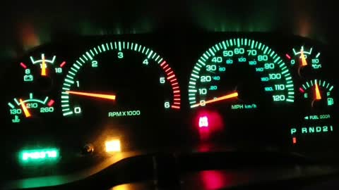

Hello, I am having an issue with my truck, it will start up great and idle good until it has ran for about thirty minutes or about fifteen minutes of driving. Then it will shut off and will do nothing more then crank over until it has cooled off, then it will fire right back up.
This did not start happening until I had gone in to replace the thermostat which I am confident is unrelated because it runs at temperature like it should and does not overheat. However, the alternator positive lead did get arced from a ratchet and I am being told I fried my ECM. I am looking for any other suggestions before I spend all that money. I have checked fuses and swapped all the relays I can think of that have to do with the truck running to no success.

I will attach a video demonstrating the issue the check engine light in the video was self induced to make sure it was storing codes properly and has since been fixed and there is currently no check engine lights.

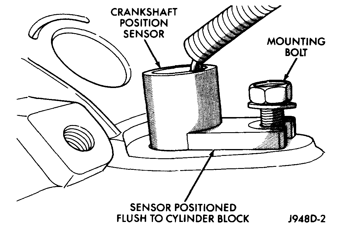

Charging is regulated via the ECM; however, if you hit the power supply to it, that shouldn't have damaged the ECM unless you shorted the supply to one of the ECM terminals.
With that being said, what you are describing sounds like a typical crankshaft position sensor problem. Take a look through this link:
The easiest way to test one is with a live data scanner. Basically, if it stalls and doesn't restart right away, you won't have an RPM signal. Also, it will cause the ignition to lose spark.

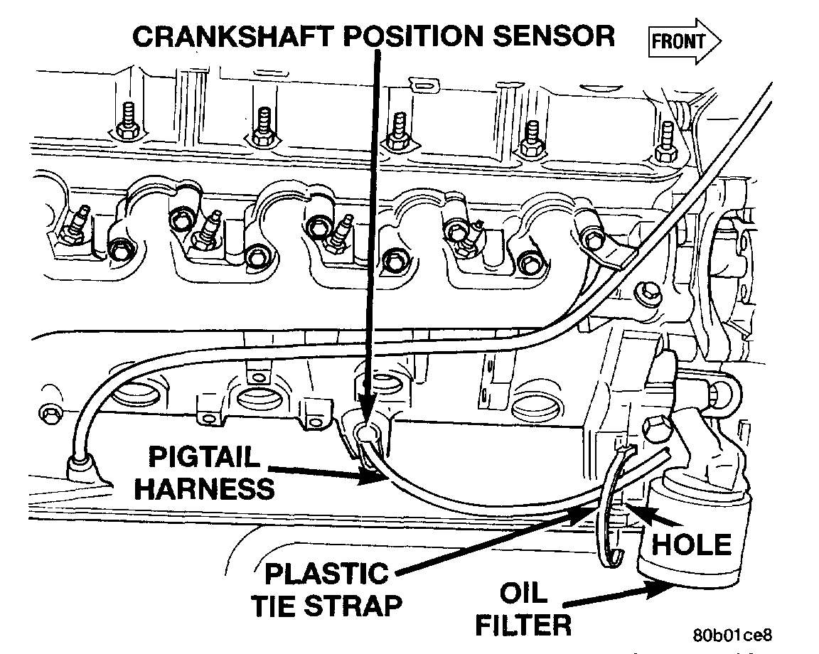

Crankshaft Position Sensor Location
See pic 1
The crankshaft position sensor is located on the right- lower side of the cylinder block, forward of the right engine mount, just above the oil pan rail.

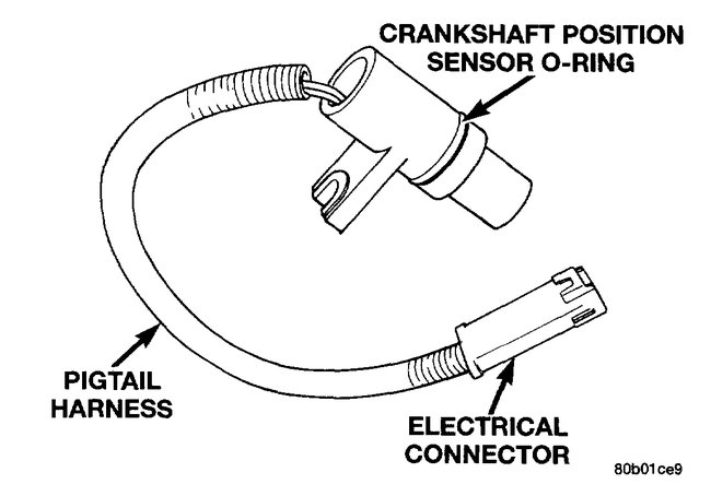

REMOVAL
1. Raise and support vehicle.
2. Disconnect sensor pigtail harness from main engine wiring harness.
Sensor Removal/Installation
3. Remove sensor mounting bolt.
4. Cut plastic tie strap securing sensor pigtail harness to side of engine block.
5. Carefully pry sensor from cylinder block in a rocking action with two small screwdrivers.
6. Remove sensor from vehicle.
Sensor O-ring
7. Check condition of sensor O-ring.

1. Apply a small amount of engine Oil to sensor O-ring.
2. Install sensor into cylinder block with a slight rocking action. Do not twist sensor into position as damage to O-ring may result.
CAUTION: Before tightening sensor mounting bolt, be sure sensor is completely flush to cylinder block . If sensor is not flush, damage to sensor mounting tang may result.
3. Install mounting bolt and tighten to 8 Nm (70 in. lbs.) torque.
4. Connect sensor pigtail harness to main engine wiring harness
5. Install new plastic tie strap to secure sensor pigtail harness to side of engine block. Thread tie strap through casting hole on cylinder block.

When I used my scanner from work it showed no codes and showed adequate engine rpm on the live data at time of failure.

When it shuts off and won't restart, are you seeing an RPM signal or have you checked for spark? Either fuel or spark is being lost unless a major vacuum leak occurs. Also, a crankshaft positions may or may not set a code, so they can be tricky.
